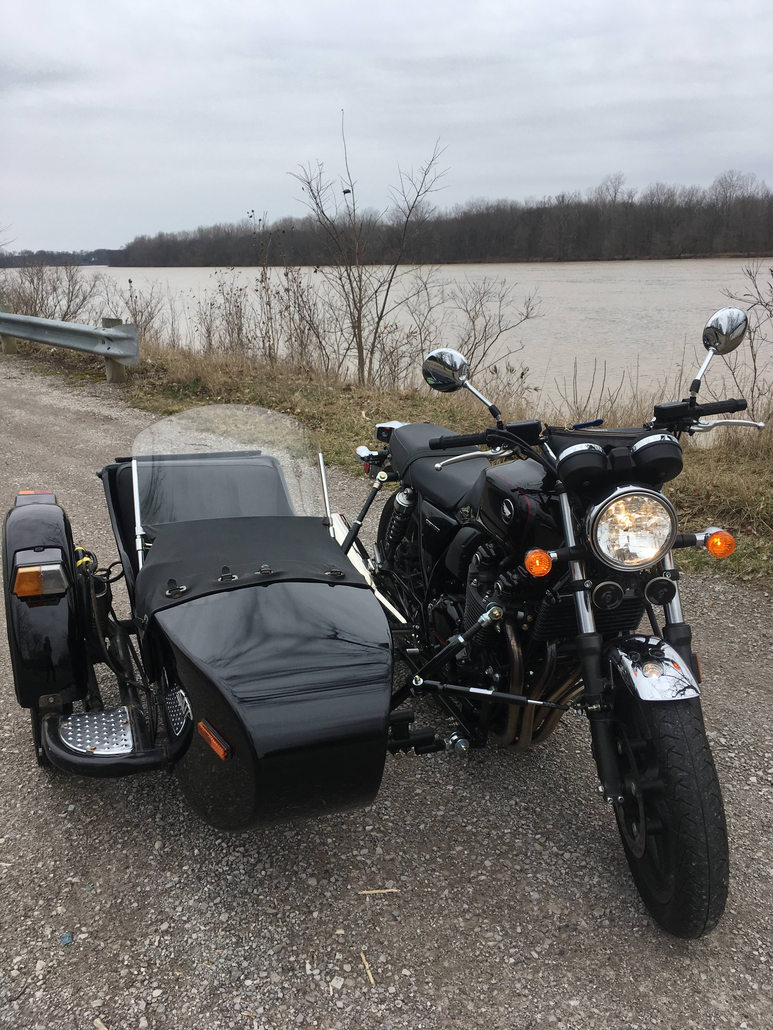

I live in Northwest Ohio where most of the roads are straight and flat, but there is one very nice curvy road not too far from me … Ohio Route 110 then Route 65 along the Maumee River. As with many roads that snake along rivers, its a very nice ride. The curves gave me a good chance to really feel how the rig handled.
[Image: 1a8914dedceec9f8de5b9b5863e52d06.jpg]
I also realized that the camber of the road affects how the rig handles and on this road, I definitely needed to maintain a firmer grip on the handlebars at all times. It also required more physical effort to ride on a road like this. I felt it in my arms the next day. I guess this is why many sidecarists modify their steering with leading link front ends. Still, I’m OK with it right now. I like the fact that I’ll actually get some arm conditioning exercise while riding this rig! : )
