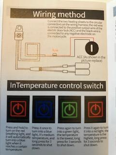

The wiring instructions are minimal
[Image: 8fb9d217b932fe9151e292919b8240ec.jpg]
If not legible, says "the red wire is connected to the positive output wire of the electric door look (ACC) and the black wire is connected to any negative electrode on the motorcycle" .... Positive output wire of the electric door lock? What?!
