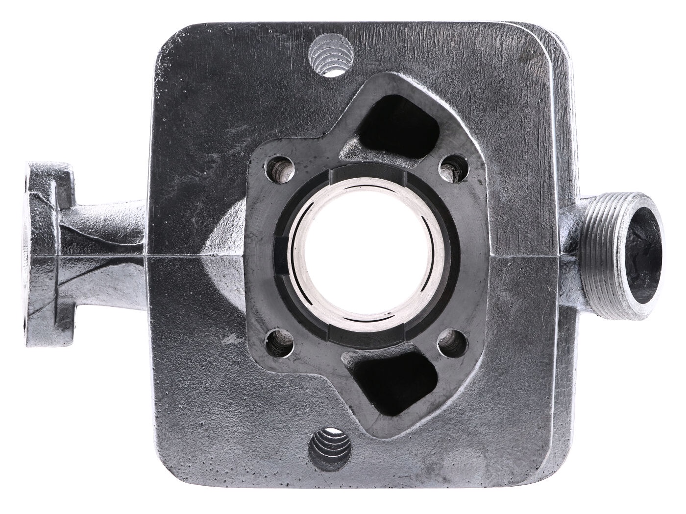

A 125cc, 3-speed engine was placed in moped's chassiss. The 125cc cylinder, head and piston were replaced with 50cc set from GDR-East German Simson Schwalbe-51
[Image: 69cfda4e7ed40d52ef97dfc5aec748a4.jpg]
Recent image, stock 50cc S-51 cyl head
All mods with 125cc carb and racing/louder muffler were able to do a whopping speed of +-100km/h for a little 50cc. A third inlet port was added and all channels and ports were enlarged accordingly. Also all piston rings were replaced with a single L-shape type and the cylinder head with its combustion chamber altered.

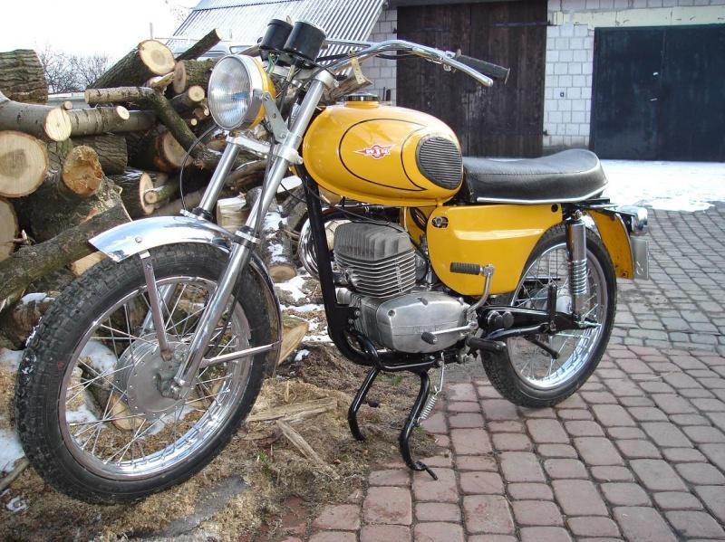

In about 1975, I still had some money left over after the accident paid by the insurance, and I was looking for an East German MZ-250cc which were very difficult to buy new or used due to limited quantity, so finally after some time I was happy with my first and brand new yellow WSK-175cc, 4 speed.
[Image: c2d402389c2450d1b2ef4b271c0b3577.jpg]
WSK-175cc image

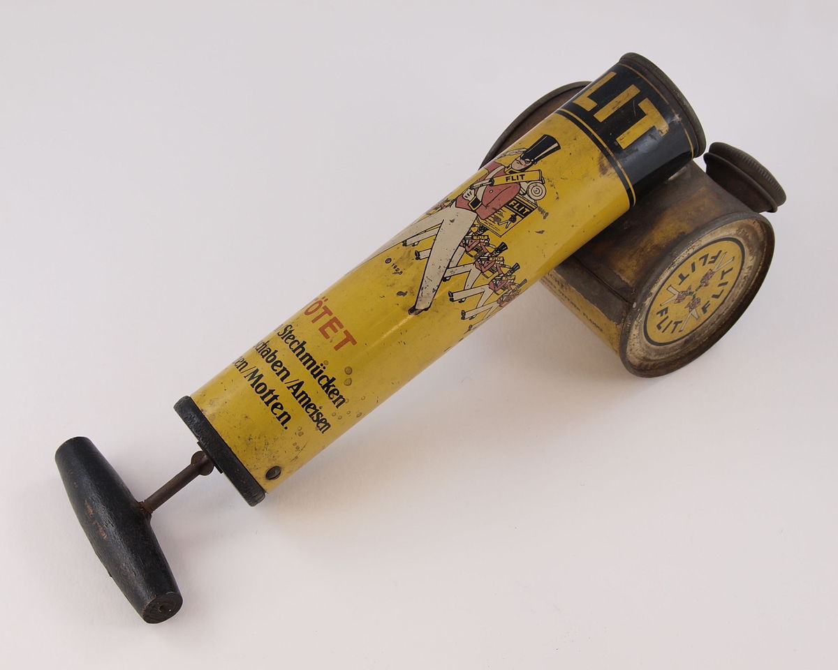

Many parts I fabricated myself and shaped them as needed in my garage.
To bend and shape them, I used this Petroleumlampe:
[Image: a8c931ae42bcbdc96c49d3417cd03ece.jpg]

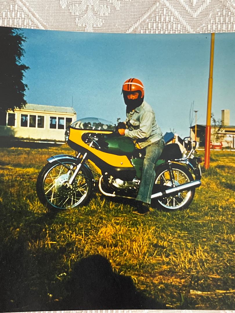

It took a lot of time and effort to finish installing a fairing, which most likely came from a 250cc racing Yamaha like this or was an exact copy:
[Image: 028b04e151d56e014edea4b7ed7c5e81.jpg]
Property and courtesy of Z.Chomko, City of Bialystok, multiple national champion in various cc classes
It had an "orange look", not painted as it can be seen in chapter 2 pic, when the bike was in its 1st generation stage.

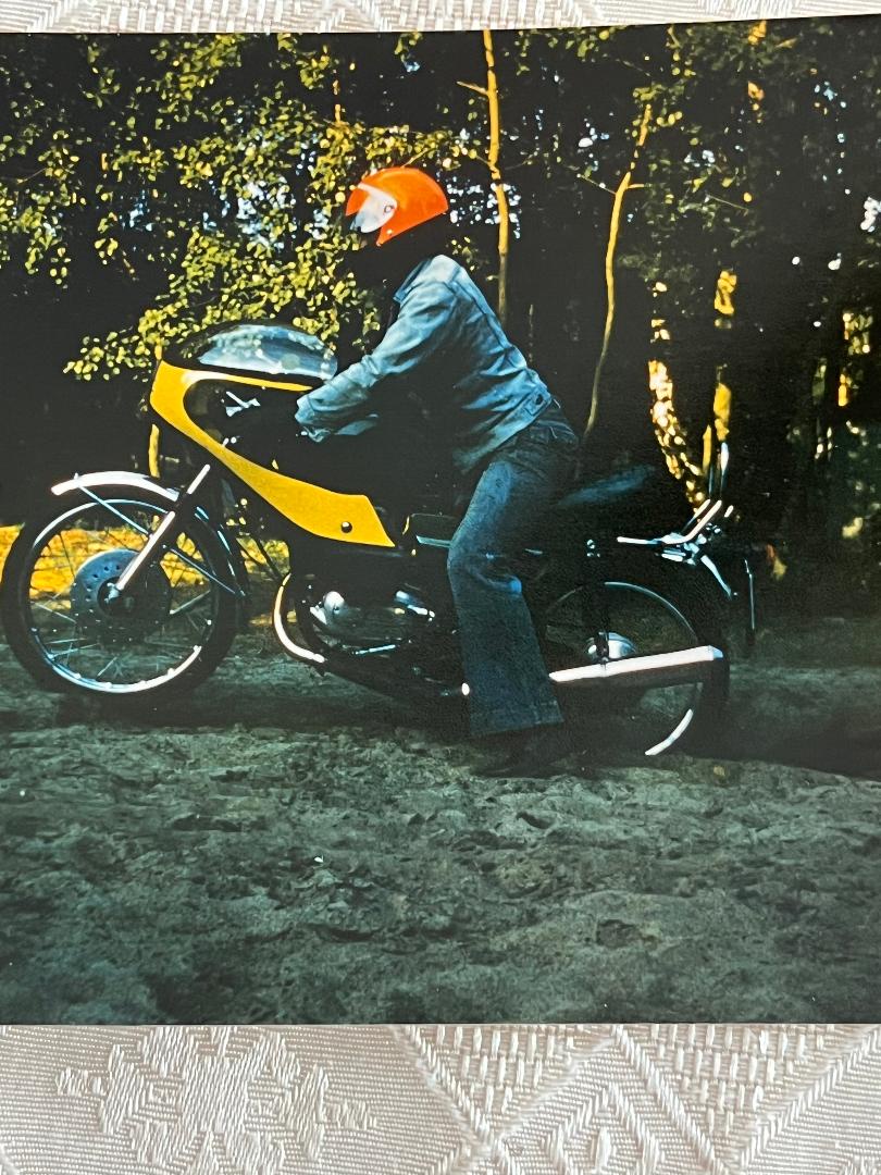

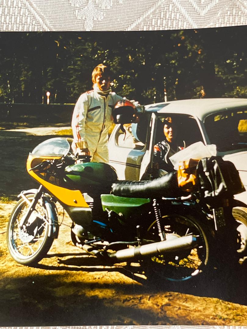

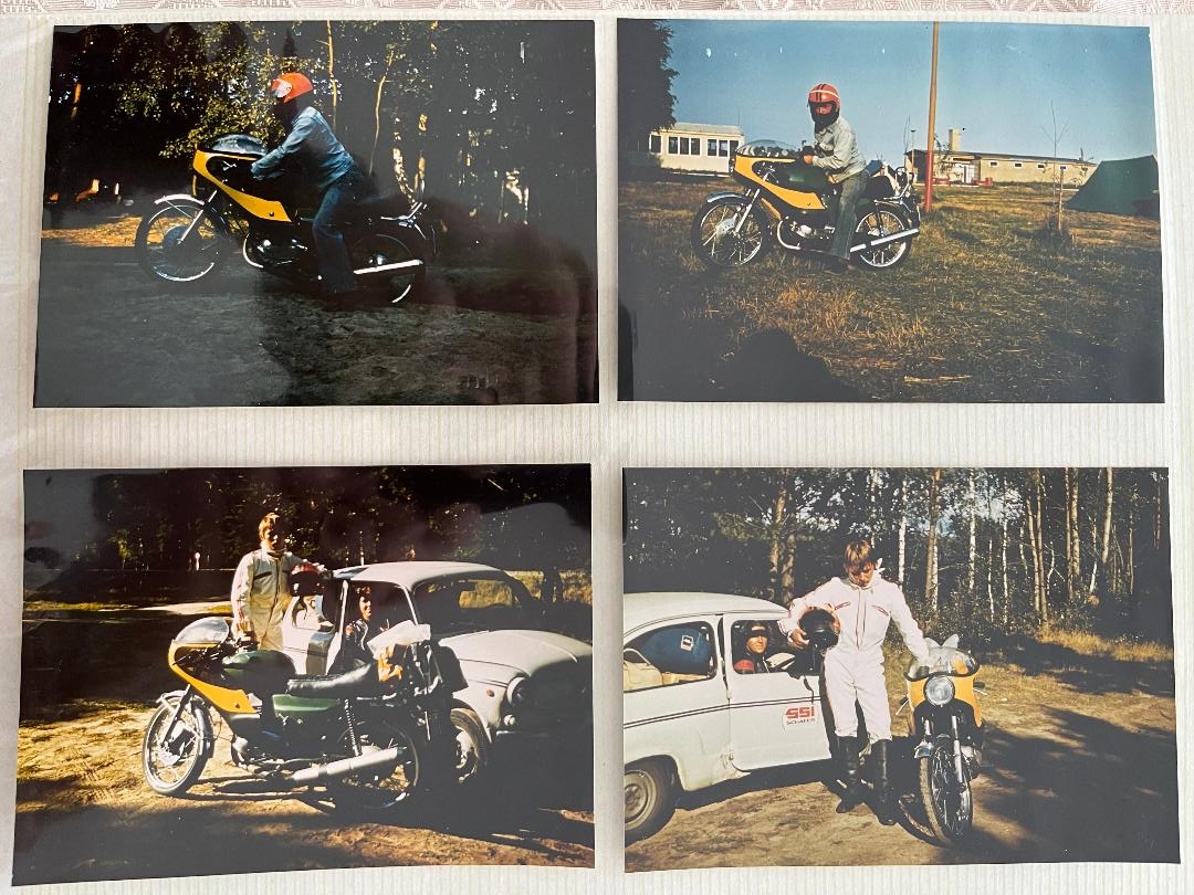

Here are the only four pics of my green bike.
[Image: 215a4c96618af0d2e1d67064fa9b75a8.jpg]
[Image: 7eef82e201c78be3c1284f1b9e5b8dd8.jpg]
[Image: 275927099353309c6491ea9f84ecac90.jpg]
[Image: 7a63581e3385f8f4b9c59bdbd14212bd.jpg]
[Image: 47dd04ecae880548a164ac28b6c6d46c.jpg]
