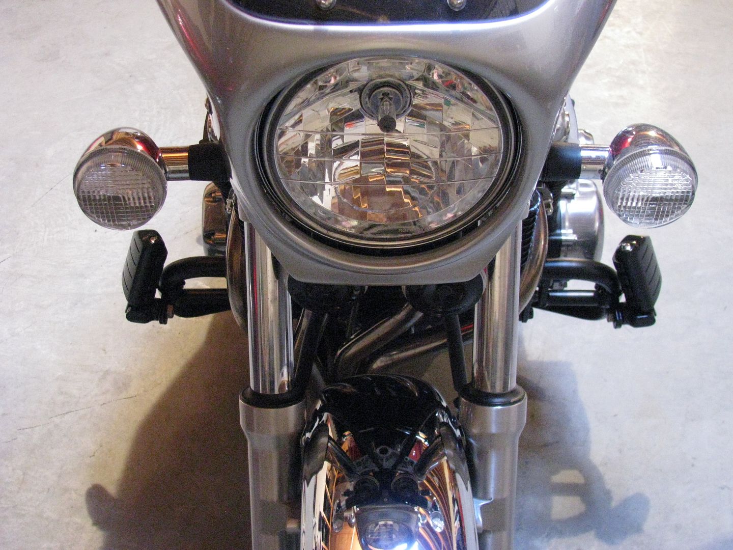

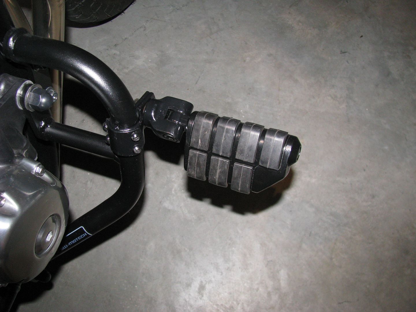

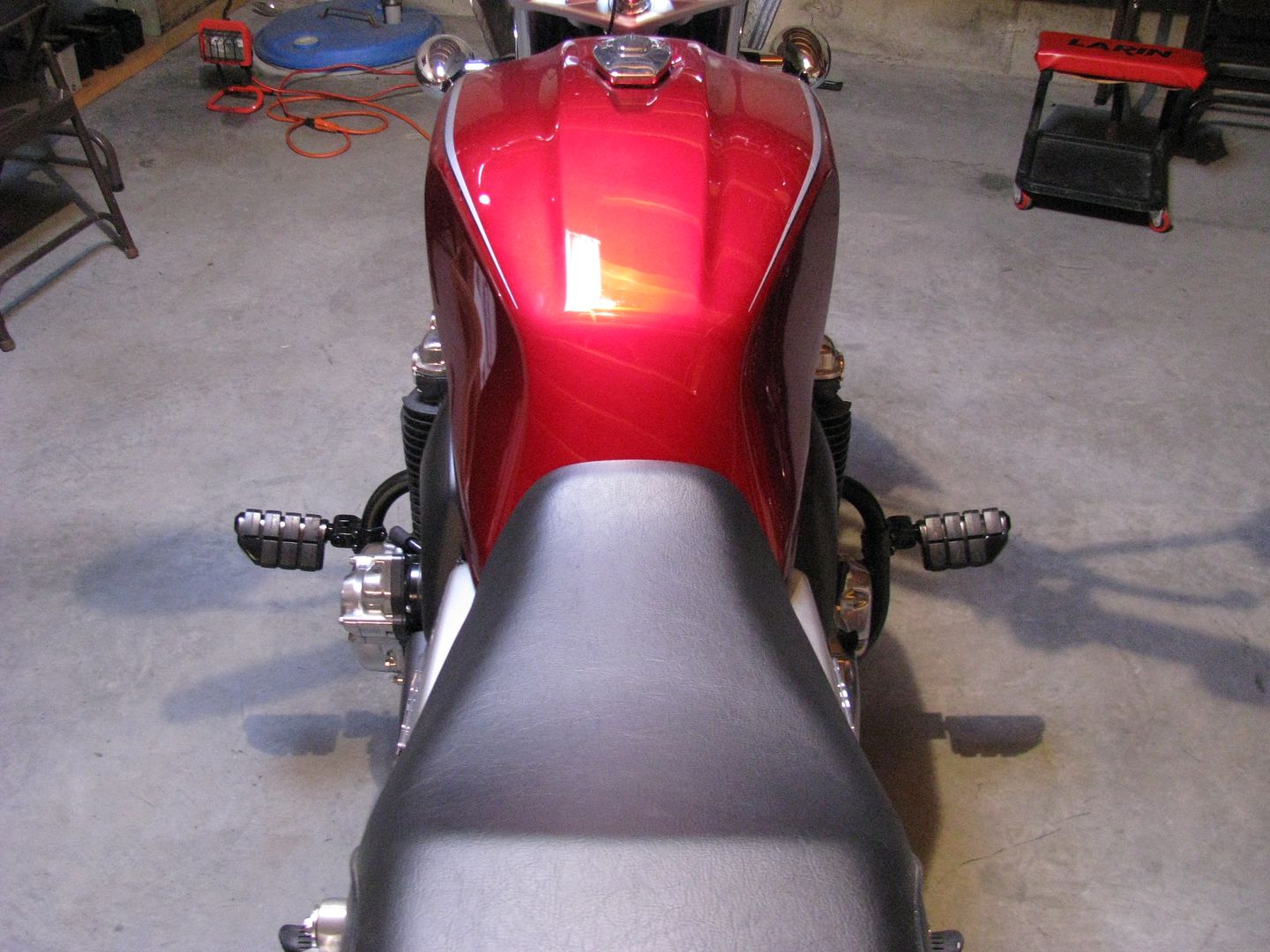

I live for, and long for, my long rides. It takes a superslab jaunt to get me to the mountains. On my Lake Superior circle ride in September, I wished for another place to put my feet.
I helped a buddy of mine sell a bike. I found him a buyer. My finders fee was a set of black Kury highway pegs. They were all scraped to hell so I rattle canned them. The clamps were chrome and 1.5 inches. My SW Motech crash bars are about 1.125 inches in diameter. So I tossed the chrome clamps in to the storage bin and scored a set of 1 inch Rivco clamps on eBay for $25 new but no packaging. I drilled the Rivco clamps out to 1.125 inches on our drill press at work when the boss wasnt looking. Rattle canned them as well and just got done putting them on the bike.
[Image: 2ddc2e67ee0b7959a157912cb1501674.jpg]
[Image: 5eac594c848d498ba5b4d0a0a8b4122f.jpg]
[Image: d43cea42c2d53c79fe20dfca8c929fd2.jpg]
[Image: 07f79513ff287d0da4f0d5bc85074eeb.jpg]
[Image: 7a0a4055944e55a3f4c563a1f3385919.jpg]
Two things:
I need to touch up a few areas with a tiny paintbrush.
I need to go for a long ride and see if I have them in the right position.
and that is not going to happen till at least March 1st.
I think they will work out OK for about a $28 investment
