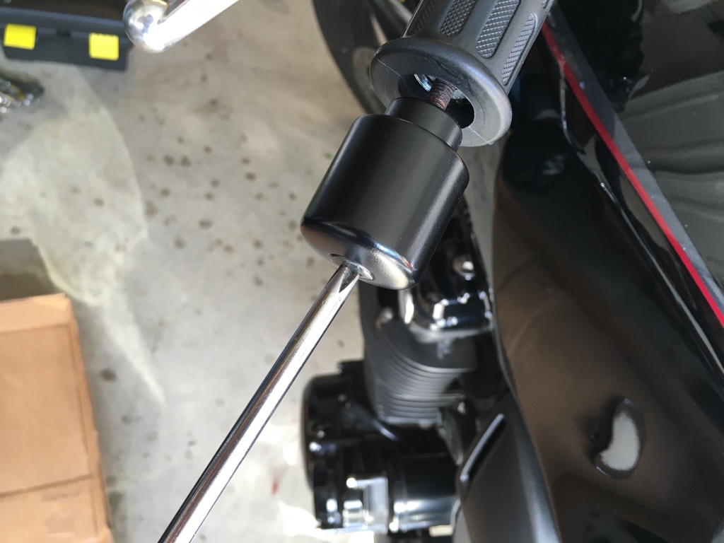

1. This is what I started with - Speedmetal Billet Bar End Mirror
[Image: 62823aa8a7a24958d7c7fdf2beeb6f7e.jpg]

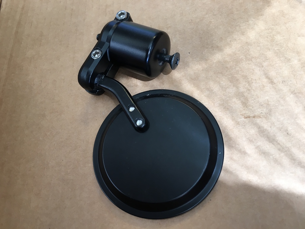

2. I separated the clamp and mirror from the expansion collar assembly
[Image: 4ed2134869b2e51f3863fcc9f475ed07.jpg]
