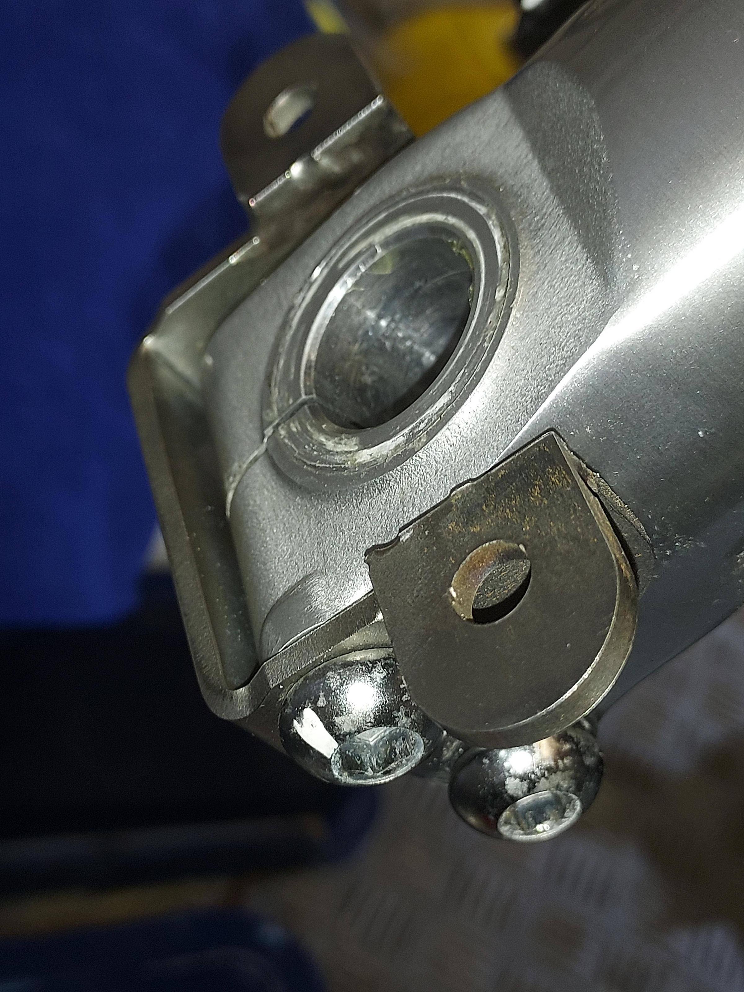

This is the stainless steel bracket, for the bottom the forks, that I had made (from Ninemeister's engineering drawing) that unfortunately needs one more hole drilling... When that's done, I can go ahead and dummy-fit the CB750 mudguard.
[Image: 4b2b297608044a31014b70c023445fa5.jpg]
