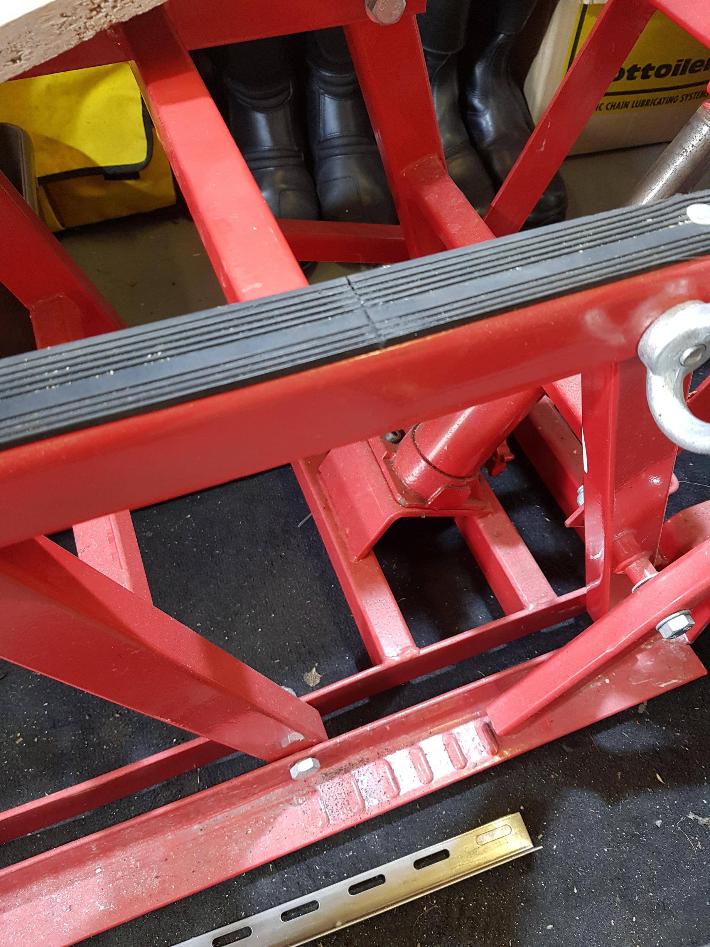

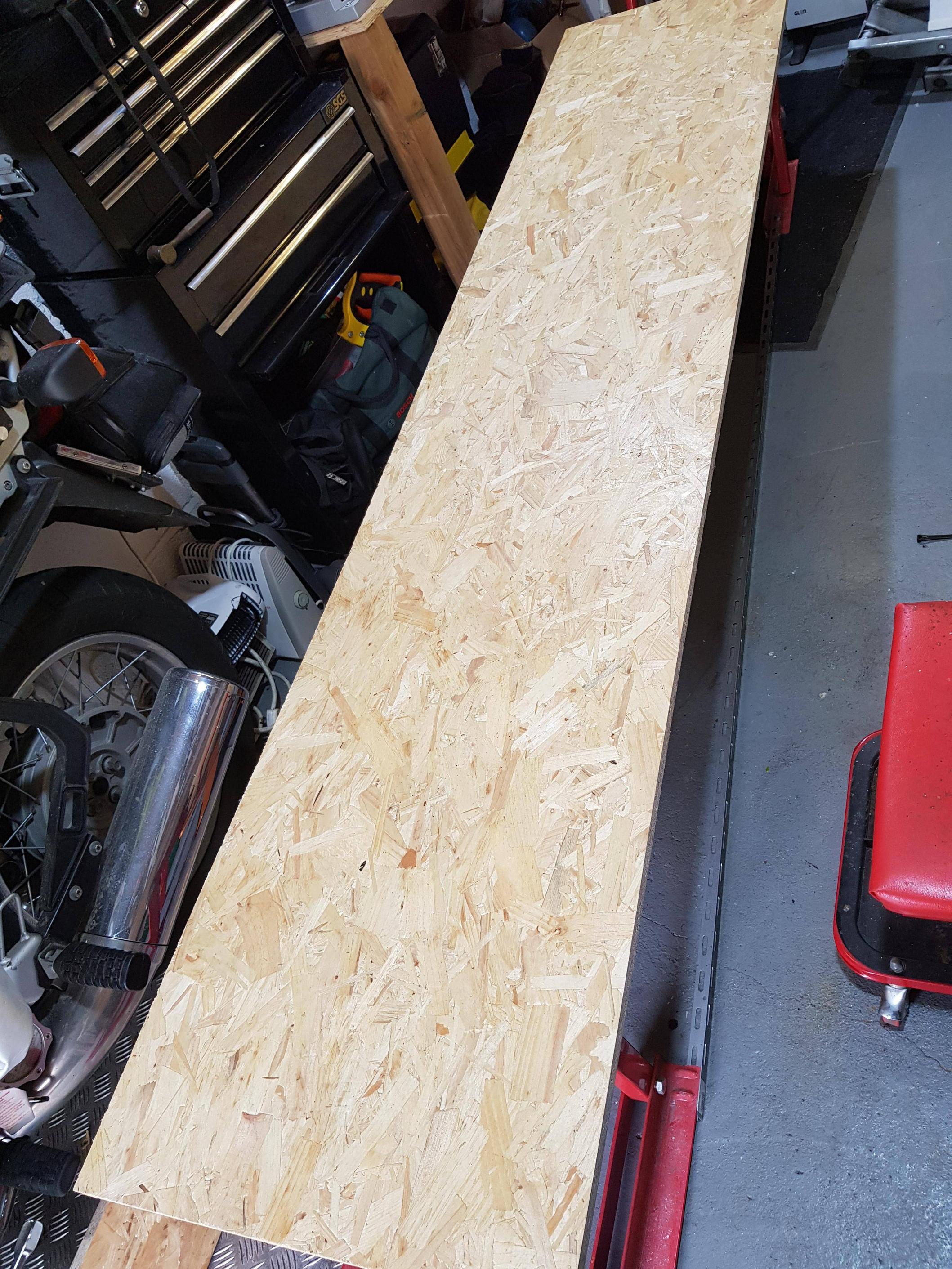

I thought you might all be interested in this... The making of my inexpensive motorcycle work bench...
Motorcycle benches here in the UK are very expensive, starting at about £300 minimum for cheap/basic. I saw on YouTube that a guy had altered his "m/c under-engine lift" into a hydraulic bench (link at end) and I copied him. Briefly, he cut his engine-lift in half, joined the bottom together for strength, and put a work bench bolted to the top supports. It still works in exactly the same way - an 'opening' parallelogram, but 'stretched'!
I had a hydraulic 'bike lifter - the sort that goes under the engine. OK for my trials BSA but no good, really, to work on the CB safely. It cost me about £34 a few years ago. With an additional £60-£70 spent on wood and steel, plus bolts, etc., the end result has cost me well under £130. I'm very pleased with it.
[Image: 4633d4964bddeeabbccea789effa5719.jpg]
The raw materials. The narrow plank is just to work out lengths and positions of bolt holes, etc., so I dont have to manhandle the big sheets. The strip of metal angle was inadequate and has been replaced by lengths of stronger steel.
[Image: 32d7615785446cc5656274fd734ede83.jpg]
Cut here!
[Image: 8fff9735b1741ed09cec015832c013fb.jpg]
[Image: 374880864560bb6a5f759e95c3a0a97d.jpg]
The two halves.
[Image: 68d261af5556fb23eb0b39fe0b8ee5d0.jpg]
Gauging the lengths and how the parts will bolt back together.
[Image: 6d7da464ce77d2feef4045d32024aef9.jpg]
Drilling the holes to fix the steel angle.
[Image: d1107ab4e4d8b5eec988b6706c273822.jpg]
Cleaning up the cut ends.
[Image: 8b165a9114e2c94d3cba46ea1dd6000e.jpg]
Ring bolts fitted to existing bolts for securing the m/cycle on the bench.
[Image: efed9109085514ffe072b448c714a36c.jpg]
Bolting up the bench.
[Image: 53b49725de47c5de5caa2373880cc4ec.jpg]
Finished! With short access ramp. I might make that a bit longer in the light of experience.
