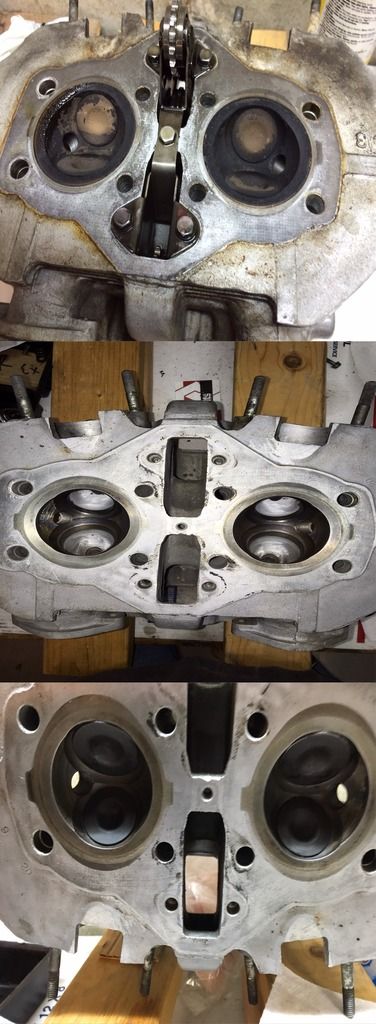

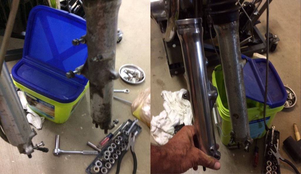

What I did to the motor was take it down and split the cases. I've never split cases or held the transmission in my hands before. It seamed like a daunting task but it was very straight forward. I soda blasted the cases, cylinder and head and painted them with hi temp paint. The cylinders were still in speck so I had them honed and replaced the rings. I found new valves and lightly lapped them in. I also replaced the timing chain because you have to break it to remove it. I polished the cam holders and bolted it back together. I have NOS (new old stock) clutch, chain and alternators coming UPS today.
[url=http://s1190.photobucket.com/user/Mike_Bova/media/CB450/image_zpst9lv8adn.jpeg.html][Image: 16cf70bcee5c03bc8fe7585bee26943c.jpeg]
[url=http://s1190.photobucket.com/user/Mike_Bova/media/CB450/image_zpsblmmlqn9.jpeg.html][Image: 1514e916bf20eaaab7d9cc9e3b7155bc.jpeg]
[url=http://s1190.photobucket.com/user/Mike_Bova/media/CB450/image_zps98iysgvr.jpeg.html][Image: d7e360c3159c72d1a2a9cf1bb757f7d6.jpeg]
