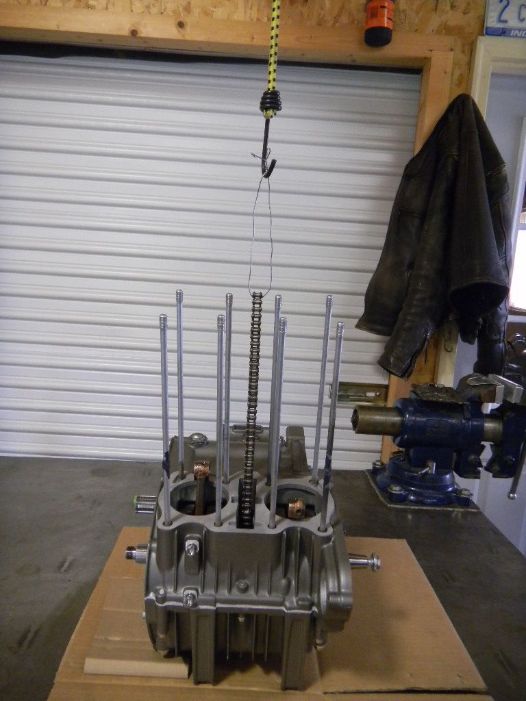

Sometimes I wished I had three hands.
Timing chain was to kept up during assembly. Trick is to devise a way that is easy to "unhook" to keep adding parts.
Used a bungee cord, connected to the garage door rail, then a piece of wire to go between the cord and the chain.
[Image: 0235e982411cae2474e467b9661b3c43.jpg]
