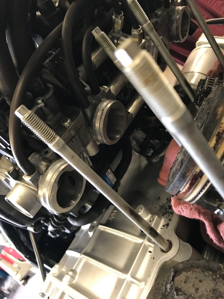

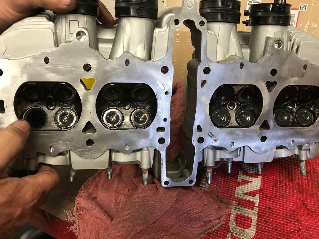

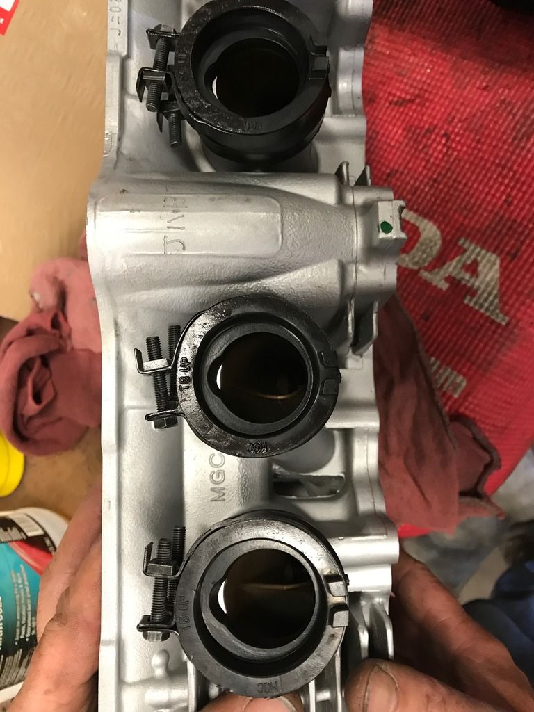

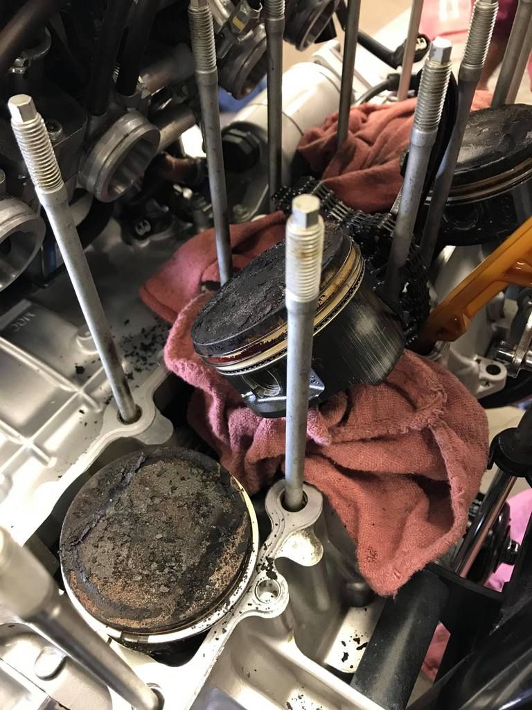

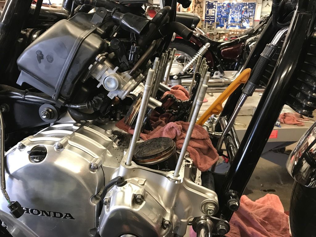

I'm going to post a picture of the pistons in this thread too.
Thought you guys might like to see a bit of inside the bike, hopefully yours will never have to be apart Smile
I wasn't able to take pictures before they honed the cylinder walls
[Image: 9b4c46a0eeda0308eb9ac0254148e9dd.jpg]
[Image: 55db8cc4fb36c25b9007941213b282e8.jpg]
[Image: 9dce8907b2707b996e68f36edf66c33b.jpg]
[Image: 1af7bbb31eeae9a26496ed2bb981e865.jpg]
[Image: c8ee2f6d640802e1a5c9a4ad0ebfa85c.jpg]

Certainly would ask for the pistons and any other parts back to have a closer look.
