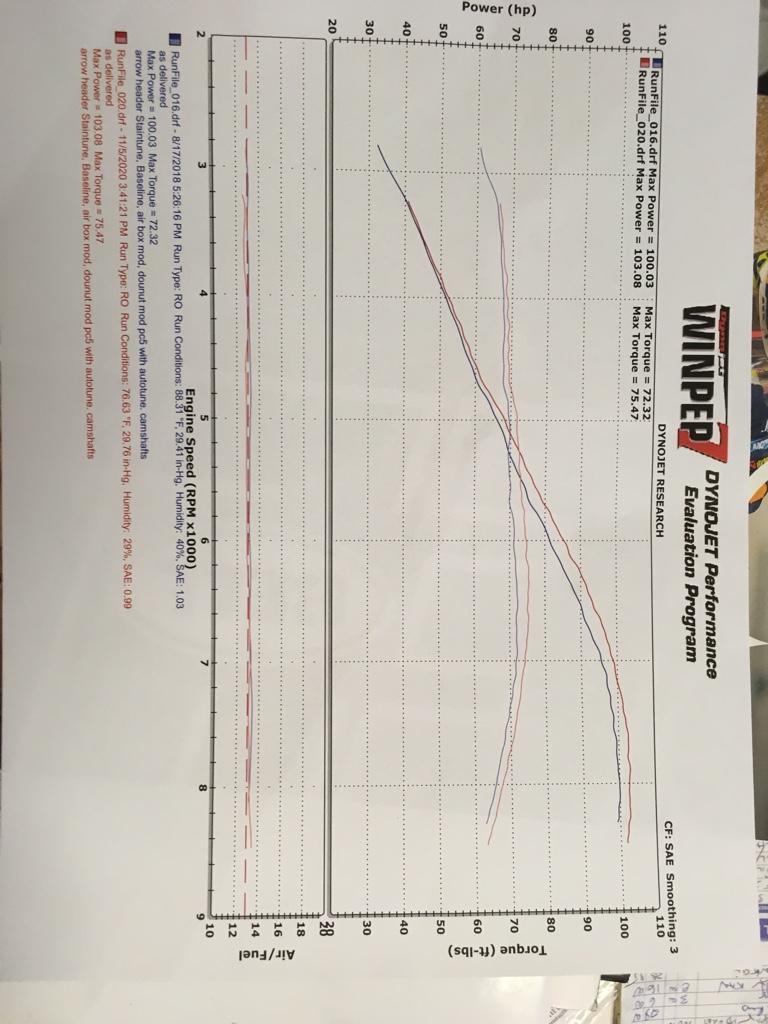

Even with those settings in the autotune- the tailpipe sniffer showed the bike a bit leaner I would like from 6500 to redline at the last dyno. I'm going to watch the injector duty cycle next time.
Once I get my dyno setup finished, I will have a LOT more info / data to share since I can see more & adjust a LOT better while stationary. I'll be reading direct off the PCV instead of a tailpipe sniffer.
[Image: 2c75fcbb8b34ddad5ab4a67e8b7ab309.jpg]
