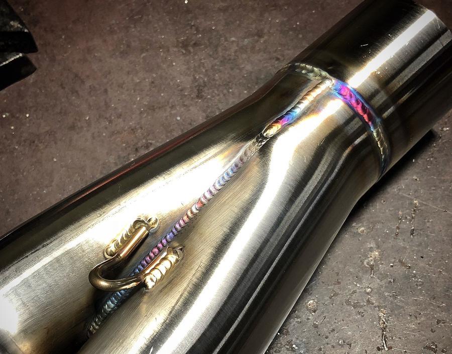

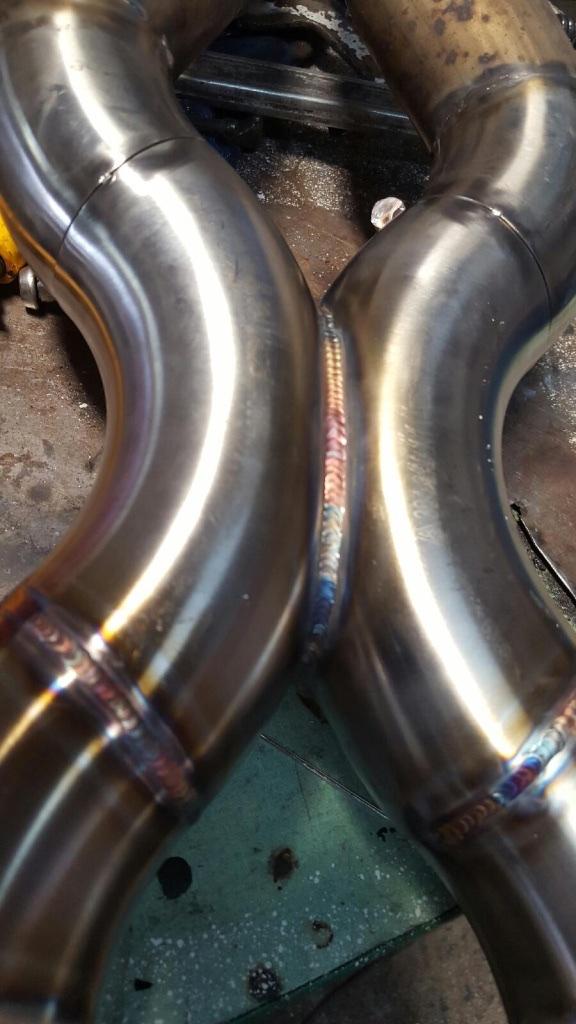

Here are examples of quality welds-
[Image: 88003d1efd678c709c1200f868c2e525.jpg]

[Image: 83eb749dafd532f1db237b7fa1b0fea0.jpg]
[Image: 6ad606e60f576626a19b457e935eef2f.jpg]

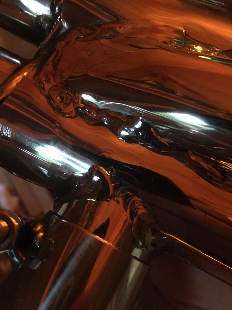

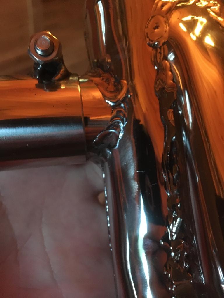

What this guy does is quick ‘tooth paste’ welds of questionable quality and then took a grinder to them before chroming to make it look a little less sloppy.
Also the bends are not mandrel, so you can clearly see the creasing.
Will it work? Sure. Does it look poorly done- yes, to anyone who knows what they are looking at.
Are the welds as strong, or will last as long? Doubtful.
There are a couple spots I wonder if he even got a complete weld. Who knows if the temperature was correct- and as I said earlier, I very much doubt he purged the pipes.
As a few years pass- the welds could crack, the joints can rust. Especially the seams... just like the old
mufflers in the 70’s.
They will still look and sound cool- just use these pictures as reference to know what you are buying-
