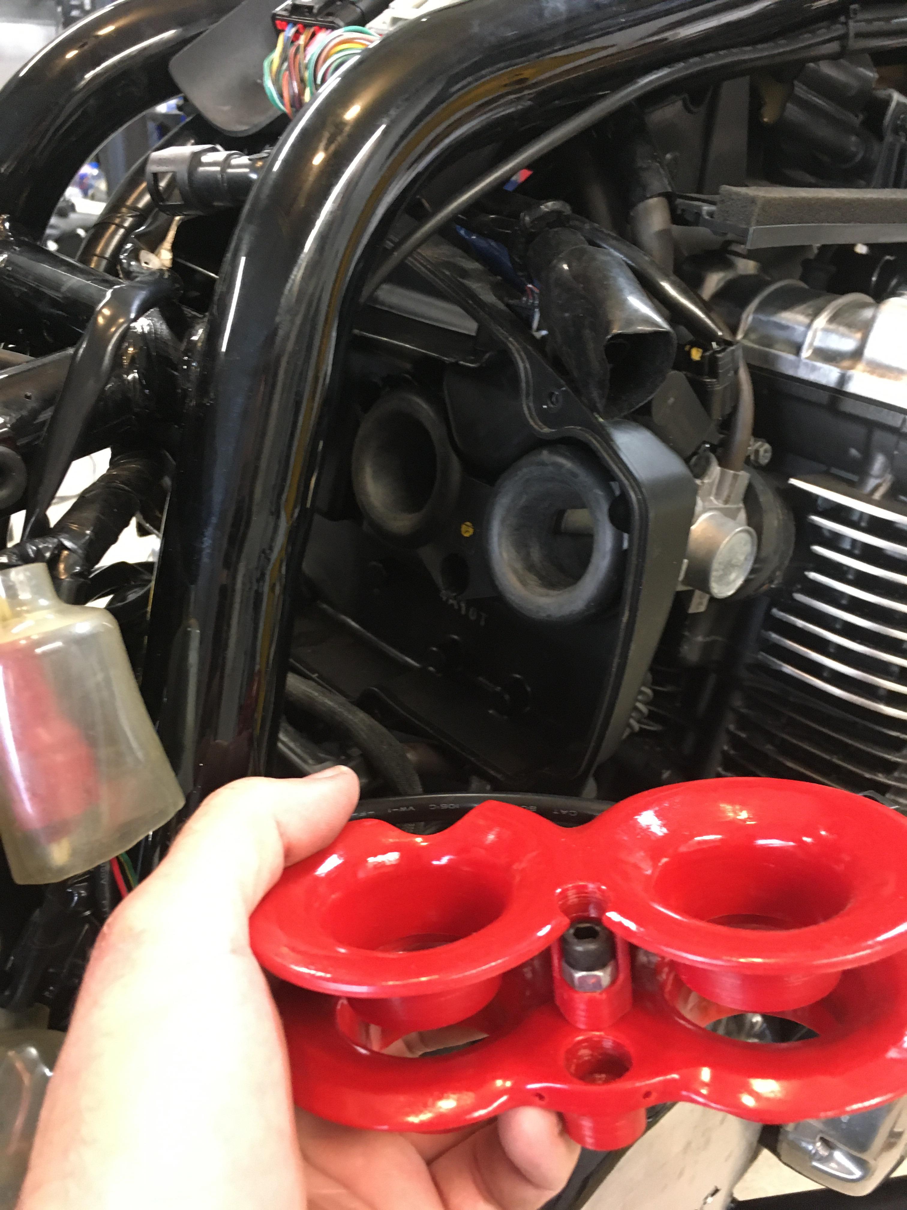

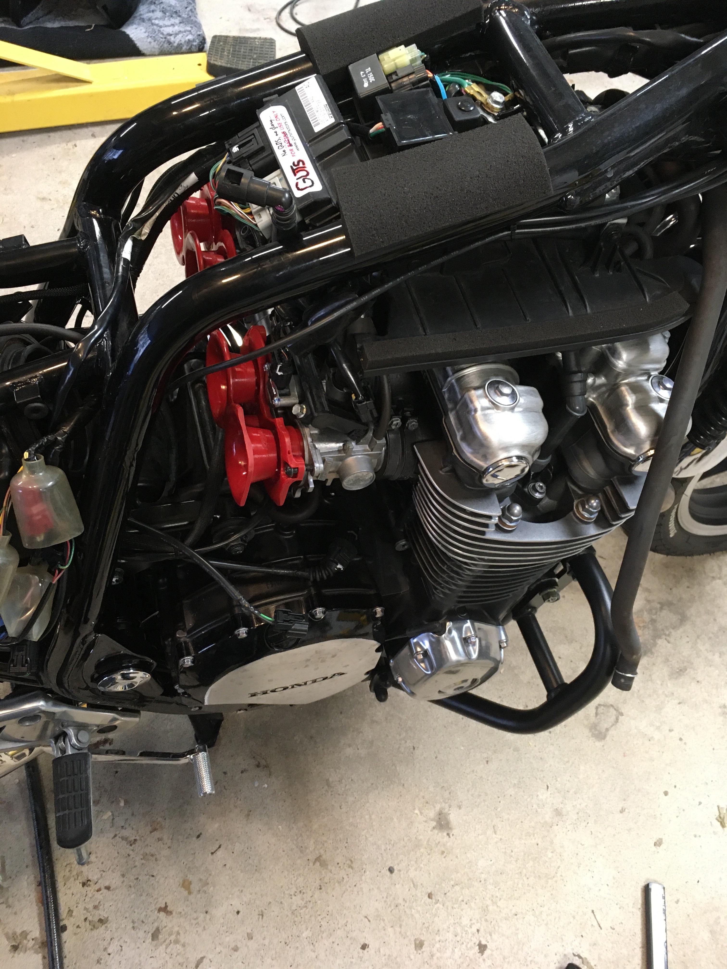

(01-18-2022, 12:04 PM)1973cb750_imp Wrote: 17225-MJE-DB0 search these i wonder is they are bigger??? That is how I found the shop that I had build these. They had made similar dual stack style to replace the Honda 650 stock parts and picked up 3whp if I remember correctly- without even touching the fueling. I expect good results. ![]() Sent from my iPhone using Tapatalk

(01-18-2022, 11:05 PM)1973cb750_imp Wrote:(01-18-2022, 02:15 PM)PowerDubs_imp Wrote:(01-18-2022, 12:04 PM)1973cb750_imp Wrote: 17225-MJE-DB0 search these i wonder is they are bigger??? To put in the 650 stacks you will need to make the holes in the airbox larger to fit into the TB. If you want to leave your airbox alone- I had good luck just boring out the stock velocity stacks- http://cb1100forum.com/forum/showthread....t=velocity Plug and play- (but anything will requite you to add fuel).

do you have a picture of the inside of the air box?

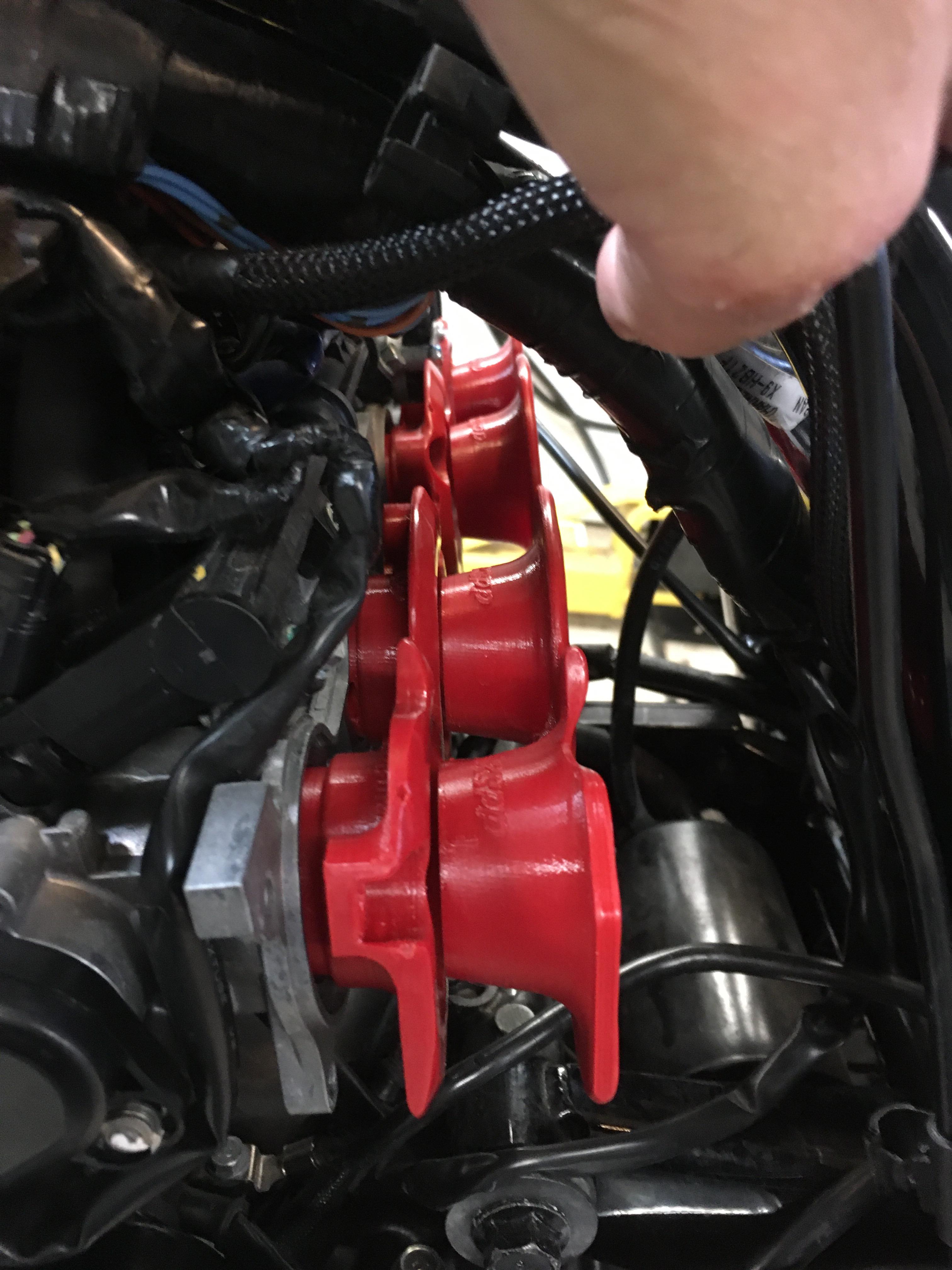

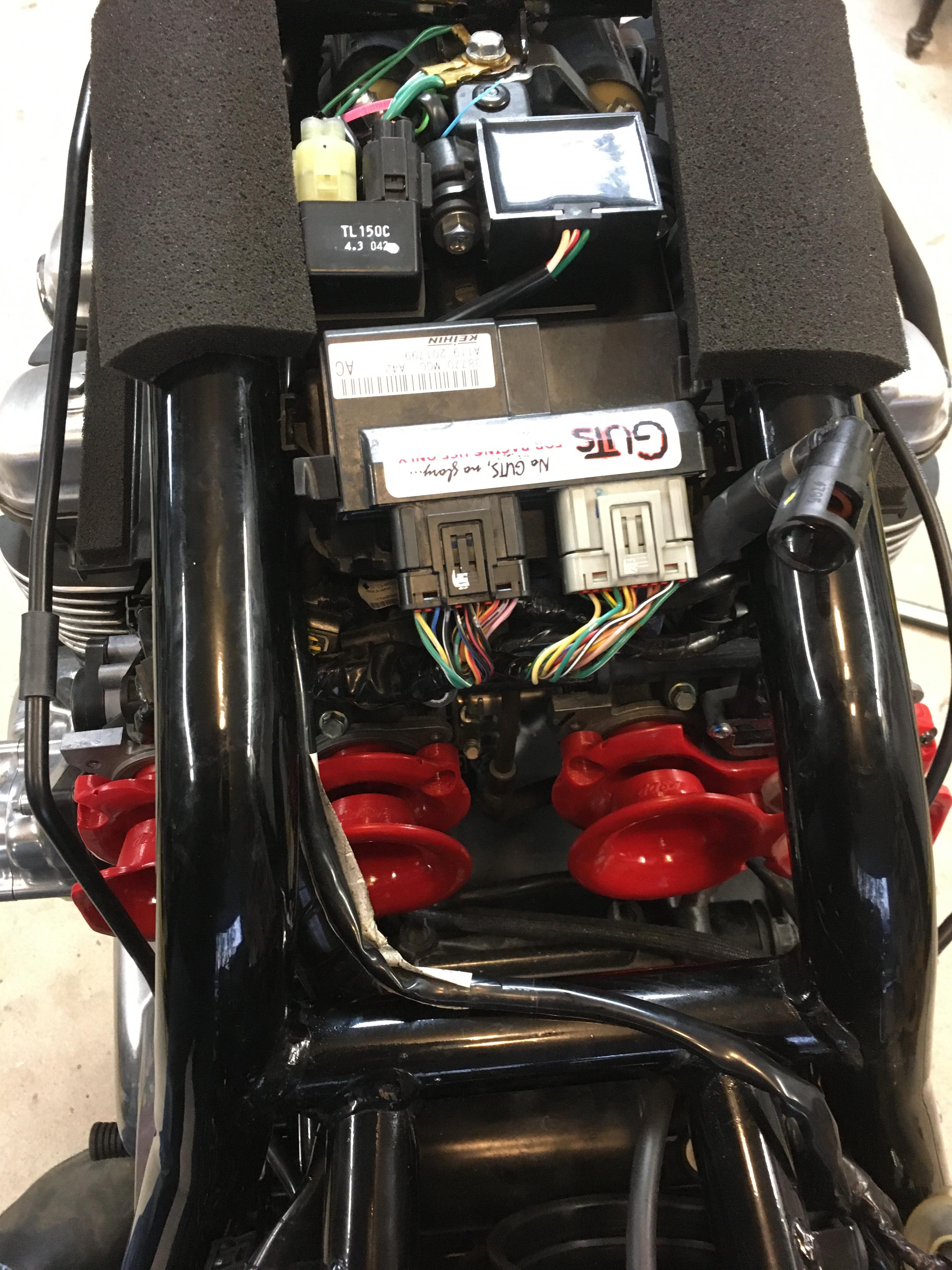

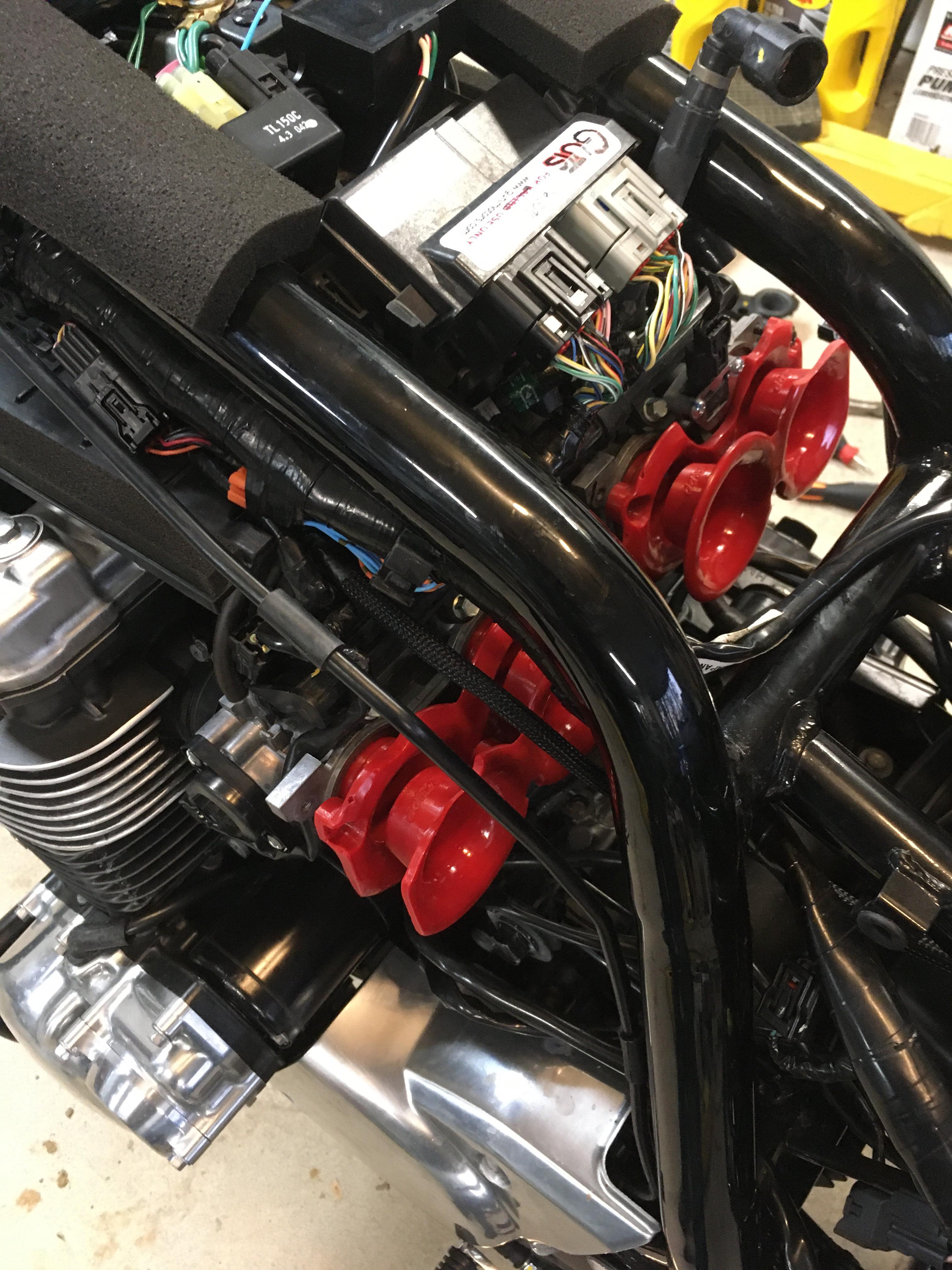

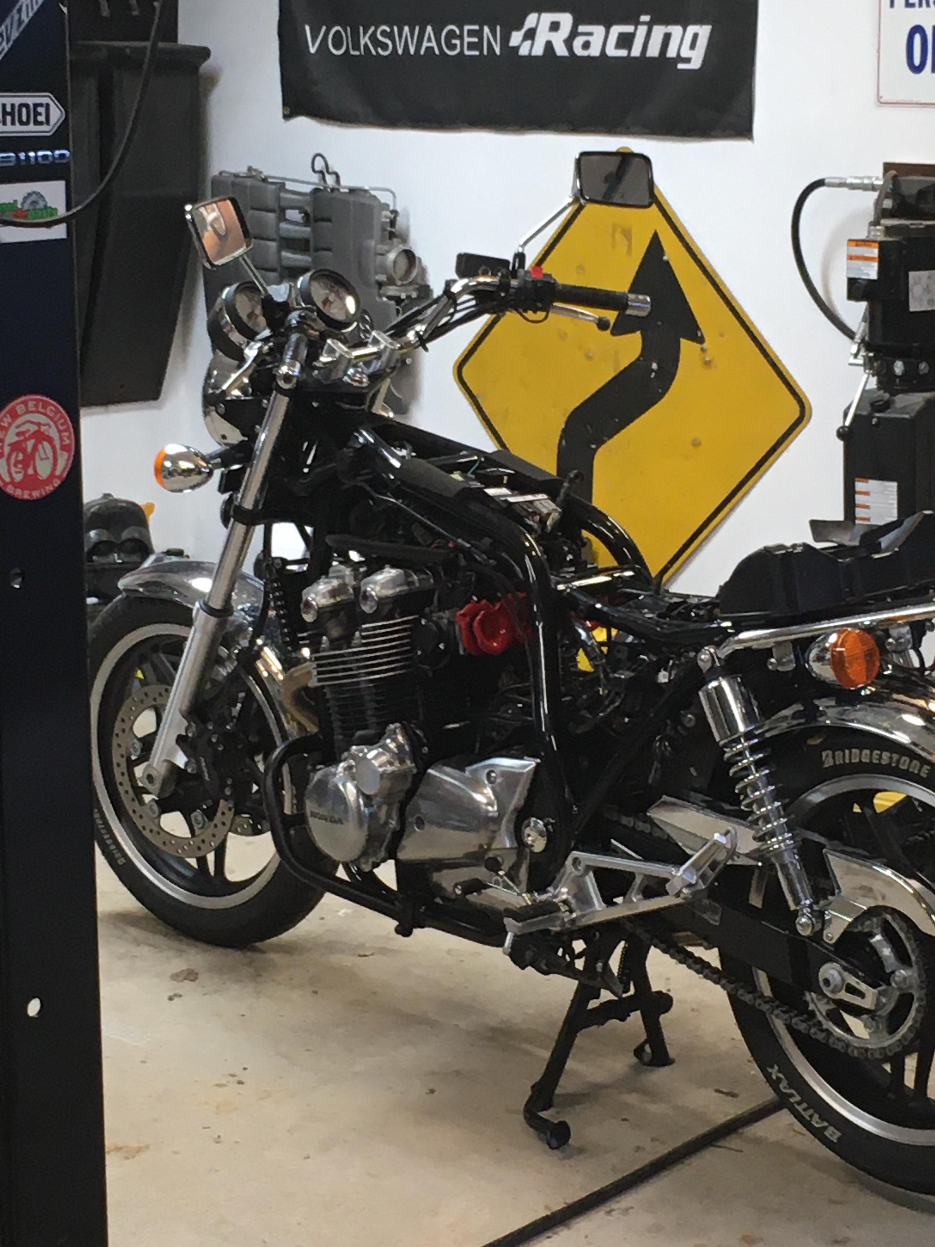

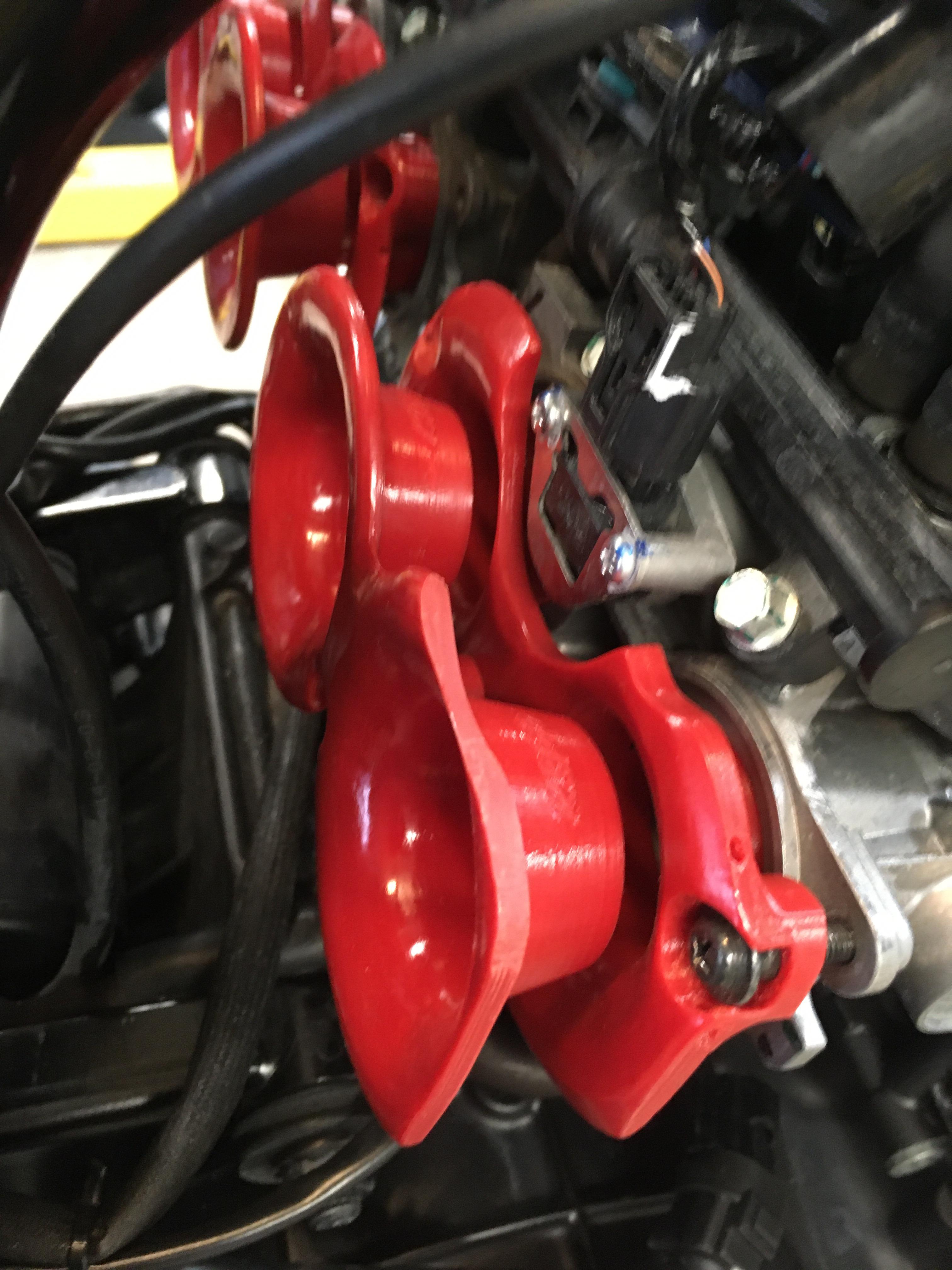

A few more from today.
![]() ![]() ![]() ![]() ![]() ![]() Sent from my iPhone using Tapatalk
