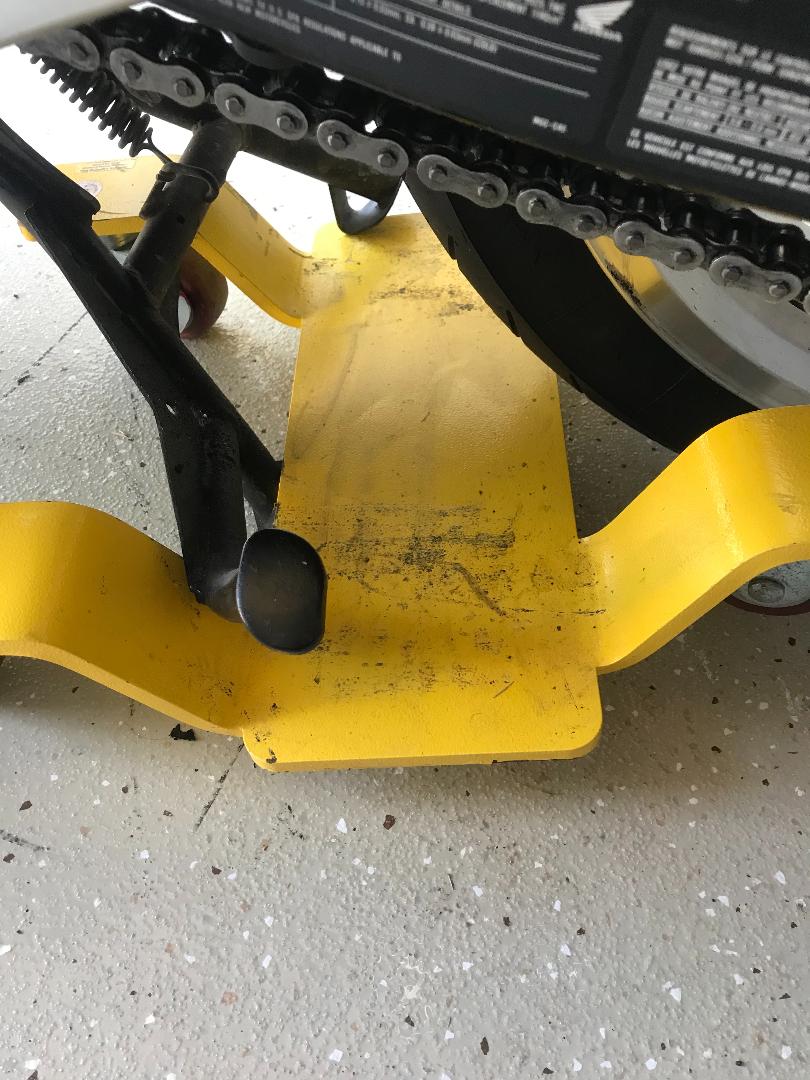

Josh, I am extremely happy with those two, for my STD and DLX.
Make sure you ask for 1,100+ lbs weight capacity, as there is a cheeper/skinnier one of 500lbs = not good for our CB.
These won't collapse, including the CB and a rider together.
Very smooth operation across my epoxy garage floor.
Once, I came to an ugly total lock up situation when in hurry the centre stand got entangled with the dolly and needed three people to resolve the sticky issue.
[Image: 853722c84446d67d0914bf01ee8094bb.jpg]
[Image: 8defb533dfce3bf97cb7a2b0ae3e3f39.jpg]
[Image: 7bc942a4c243ee9e96d04bd6834c2b87.jpg]
Since then, one has anti skidding rails installed across the dolly and the other one already came with an anti skidding rough application.
