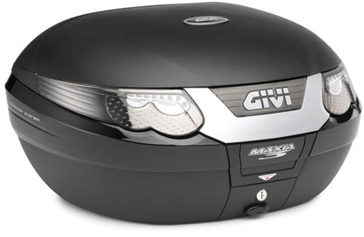

hmmmm, most important, I did forget to mention that I did ride with a huge topcase, 55 litre Givi E55 Maxia 3 Blush
[Image: 1a9eff286a595c28c4d125a35b7fe2fc.jpg]
I assume this could cause the front to wobble at high speed?
