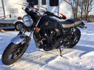

I purchased my CB back in December from a private seller.
[Image: ead9995134e3ee5cd411bb525cd7bad5.jpg]

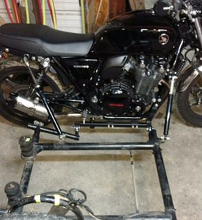

I contracted with Bob Wark of [url=http://www.warkshop.com/]The Warkshop to install the sidecar frame. Bob is a professional sidecar builder / seller and his work is top notch. He fabricated a subframe to link the sidecar frame to the CB. He had to remove the center stand and customize and replace a new left seat bracket to attach the subframe. [Image: d6d16e0c26e6feb4cca208de53aa76d3.jpg]

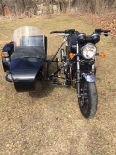

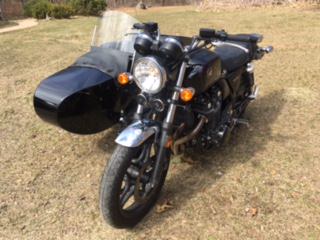

I picked up the installed frame a few weeks ago, took it home and fastened the tub onto the frame.[Image: 760bde1b9f2caaa4b07ddea7b8edbac4.jpg]
I’ve taken a few test rides since then and am extremely pleased! I knew going in that piloting a sidecar rig would be dramatically different than riding a motorcycle and it is. I have a good deal to learn and plan to continue practicing my skills before I begin with my real adventure … traveling with my dog, Rudi!

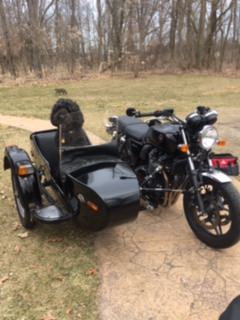

[Image: eaab59cb183bccd9d9b00e92cf4672e2.jpg]
I have a lot of things I want to add to this rig and it will take time and $. Will post more in the future. In the meantime, I'm really looking forward to some better weather and a lot of riding!!!
