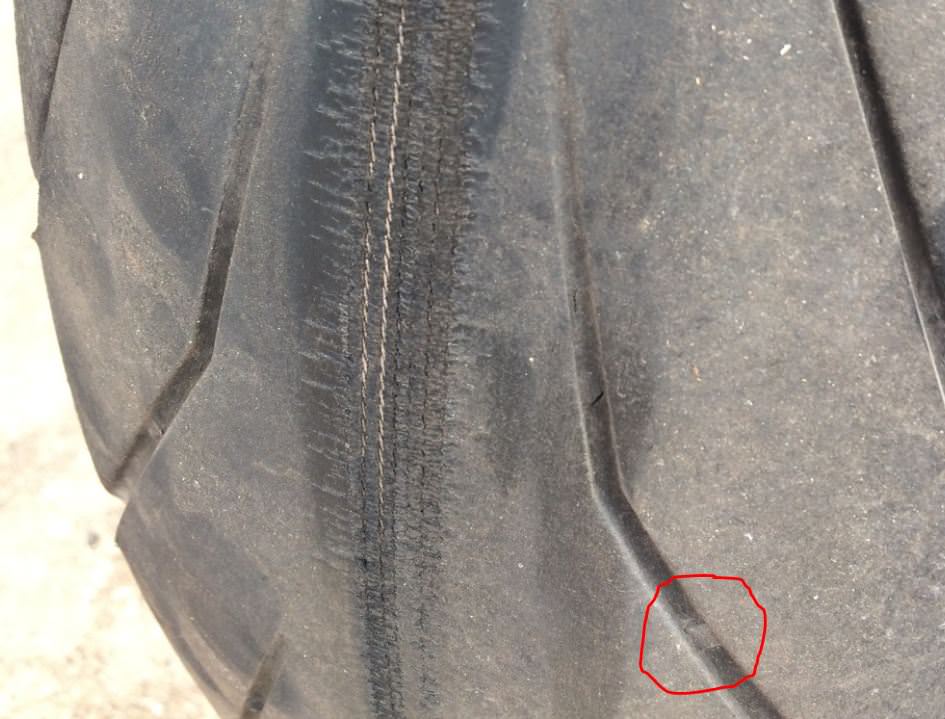

I think, I saw this issues here in Germany already reported by a friend. The problem with this tire is, in the middle is no tread, so no indicator, how much rubber is gone. Then you get suprised, when the textile shows up.
Old thread, but I've been considering the Angel GT as a replacement tire, so I'm scouring the forum to get people's experience.
From what I can tell, the Angel GT does indeed have tread and wear bars in the center of the tire. So, it should be straight-forward to check for wear:
[attachment=8437]
#34
It may not be straightforward to monitor the wear bars on the Angel GT; note that the ones closest to the center simply disappear while the next row outward has not yet reached the surface on Ptero's tire:
[Image: 26d30b83eb7c5b00ec6b676974f4df5b.jpg]
