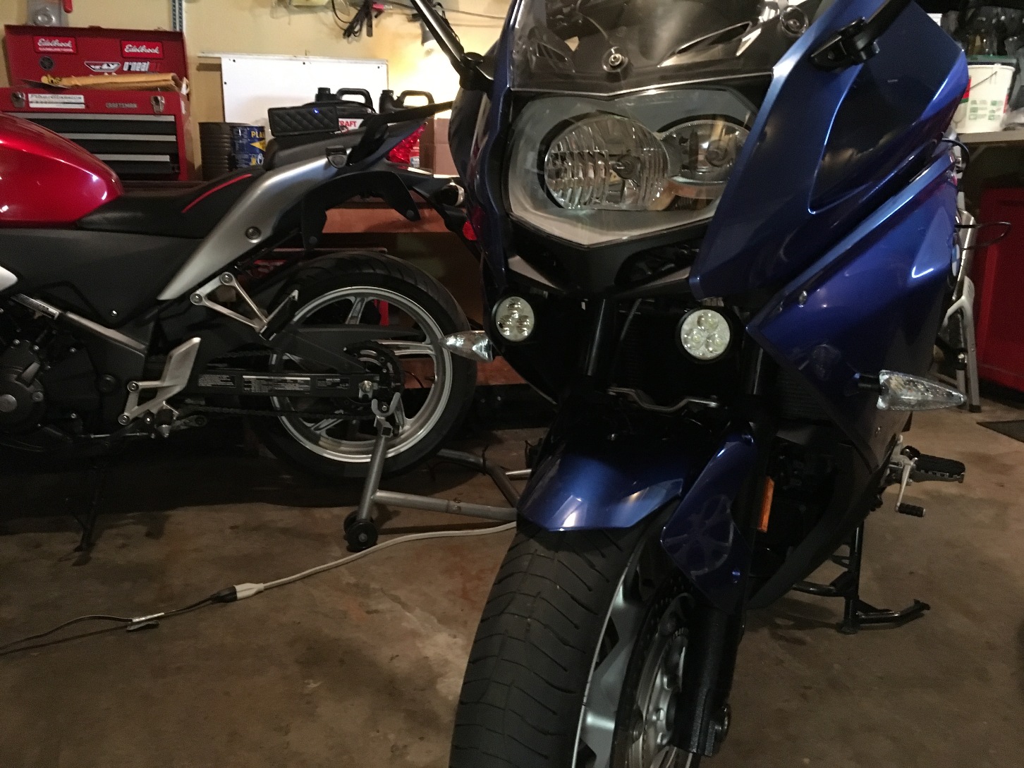

My aux lighting solution for my GT. Not a lot of cold, hard cash required and gets the job done. During dawn, dusk, and at night these are my deer spotters pointed to the left and right sides of the road. During the day the strike the vision of drivers entering from left or right.
[url=http://stores.advmonster.com/model-30-led-off-road-spot-light/]ADV Monster Model 30 spot
[url=https://www.revzilla.com/motorcycle/denali-d1-wiring-harness]Denali D1 wiring harness Trigger the relay by tapping the high beam wire. When flipping to high beam, the spots come on (I leave the main spots switch ON at all times).
