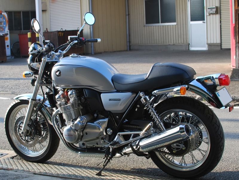

OK scooticus. First of all, Welcome to the forum! Hello
Secondly, your CB in "Out of the box" white is a real beauty! Really, really a pretty CB1100. Thumbs Up
HOWEVER, the silver transformation is visually stunning! WOW, and WOW again!!!! Heart Heart Heart
Is this your bike before you installed the 4-into4 pipes?
[url=http://smg.photobucket.com/user/z1zr7/media/SilverCB1100A_zpsd1bdf8e5.jpg.html][Image: f7bb0e7a3170e3609bae7f18dcf5c9ba.jpg]
In my eyes, the silver CB with spokes is the most beautiful piece of machinery ever assembled!
Oh my gosh! Yea, I think your bike is pretty cool.
If I could get a marriage license for a motorcycle, I would marry that bike and hold, coddle, clean her for the rest of my life.
The best I can do right now is get my spare tank painted to match the side covers of my 2013. After spending big bucks for a Nojima exhaust, I doubt I will ever save up enough pennies to buy spoked wheels.
Having said all that, your CB is king!!!!!!!!!!!!!
Well, maybe QUEEN! Worship

For the transformation from stock to what you see now. Here is what i got and the links to where to get the items from :
1. A Honda CB1100ex | make 2014 | registered 2015 |
2. Yamamoto Clip on bars | samurider | [url=http://www.samurider.com/?p=14513]samurider link | Price - 40,000Yen |
3. KanDH Solo seats | samurider | [url=http://www.samurider.com/?p=21826]samurider link | price - 57,000Yen |
4. Front brake adjust bolt | samurider | [url=http://www.samurider.com/?p=13151]samurider link | price - 9,000Yen |
5. Napolean cafe racer bar end mirrors | [url=http://www.amazon.com/Napoleon-Mirrors-AP-101-Replacement-Mirror/dp/B004WPQZTE/ref=sr_1_2?ie=UTF8&qid=1427221120&sr=8-2&keywords=napoleon+bar+end+mirrors]amazon link | price - 30 use each ( 60usd total exl shipping ) |
[Image: e14cb6e7865eb7fecb7ebdd59ebd464c.jpg]
6. Pipemasters 4 to 4 exhaust | pipemasters au | [url=http://info@pipemasters.net%20]email Peter Gray | price - approx 2300 aud ( inc shipping ) |
7. o2 sensor eliminator | ebay | [url=http://www.ebay.com/itm/o2-Oxygen-Lambda-Sensor-Eliminator-Set-Blanking-Plug-HONDA-CB-1100-2013-2014-/221639679815%20pt=UK_Motorcycle_Parts_13&hash=item339ac11f47&vxp=mtr]ebay link | Price - approx 15 pounds each | total - 2 x 15 pounds ( excluding shipping ) | cb1100ex have 2 o2 sensors instead of 1.
8. Custom paint job done locally | Colour from white to silver | Price - 300aud |
cost in aud for the bike : 30,500
cost in aud for add ons : 3,858
total cost in aud : 34, 358
here are some of the pictures of the bike at mint condition.
