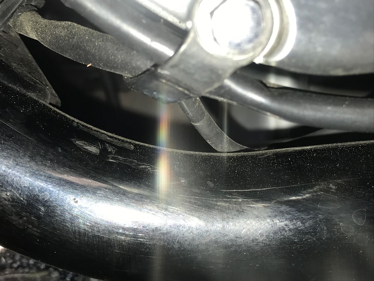

Hi all. While taking my engine out, a Honda dealer gouged up my frame big time.
I’d like to make them fix it right, such as sending the frame out. But I don’t want to lose my bike all summer. It’s my baby and the only modern bike I enjoy. Plus I don’t really trust them to reassemble it and torque everything properly.
As much as it sucks, they want to just prep and paint the affected areas. I’m thinking if it’s not to my satisfaction afterwards that I will take it to small claims court. What are your thoughts?

Tend to agree with your last suggestion, taking it out of the frame seems like a repeat of the first "job".
There may be an option to do this out of season and cover the area's with some protection in the mean time, wax or black electrical tape, if it was me i would quietly check all the bolts they have worked on to see if they are not loose just to be sure, nobody is perfect but two people independently checking the same job can get pretty close.
Also on pic no5 the wiring is routed behind the swingarm shaft on my bike, not in between the engine and the swingarm and ends up behind the rh sidepanel's cover, i can make a picture if you wish.

Good find Max. That cable looks precarious in that position - almost looks like asking to be pinched in some manner.

Kudos to Max for the good catch, noticing the improperly routed wiring. I have included a picture below of my bike showing correct routing. It looks to me like your current incorrect routing is a wire chafing problem just waiting to happen. Along with others, I am also curios to know why your engine was pulled.
Back in the day, with a lot less knowledge and tools than a supposedly professional motorcycle shop mechanic, with the help of my Father, I pulled the engine on my 1974 CB750 Four to replace the valve cover with a chrome version. Using care, and duct taping vulnerable areas on the frame, I had no cosmetic damage when the job was complete. I agree that what they did to your frame, although cosmetic, is unacceptable.
If the damage has gone through the paint to bare metal, you definitely dont want those places to rust, so if proper repairs wont be done until after riding season, those areas should be cleaned and sealed. If the shop you used did that kind of damage, I dont think I would trust them to do the restoration. In order to do it right, the engine will need to be pulled and re-installed again. So, if it was me, I would thoroughly document everything as it is now. Next I would take it to a professional custom motorcycle shop or a shop that specializes in motorcycle restorations, and get a repair estimate. Present the estimate to the shop that damaged your bike, and see if they will pay it. If they say no, I would pay to have the repair done right myself with another shop, then take the shop that damaged your bike to small claims court.

Hey man thanks! A photo would help. There were a couple wiring issues I had them fix the first time. Over the course of the rebuild they kept having me come in to test ride and take home but I kept having to say hey, no, this this is still vibrating insanely. It was ridiculous.

Very true. An out of season job would be ideal. I just don’t trust them. Of course it’s gonna cost them a ton and of course it’s gonna take a lot of time and be a huge pain, but they should think of that before they fail to protect a frame while an engine goes in and out..
The thing is I’m planning on moving from NY to Oregon by the years end so.. we shall see. I spoke with Honda USA again today and got someone who cared and took it seriously. So waiting for their case manager to contact me.
I told the shop hold off on the repair until I hear from Honda.

Do not know how far away from your place is any other Honda dealer, but looking at your situation, I would not take this bike back to the same dealer again (if you have this option?)
My opinion: I know it hurts, but since these scratches look more cosmetic, I would use very fine sand paper, water it + frame, sand it down and repaint the frame by using semi gloss or gloss TREMCLAD Rust Paint, C$10.
ix your other things first, route electrical harness properly and then paint. I would not take the engine out to do the painting.
