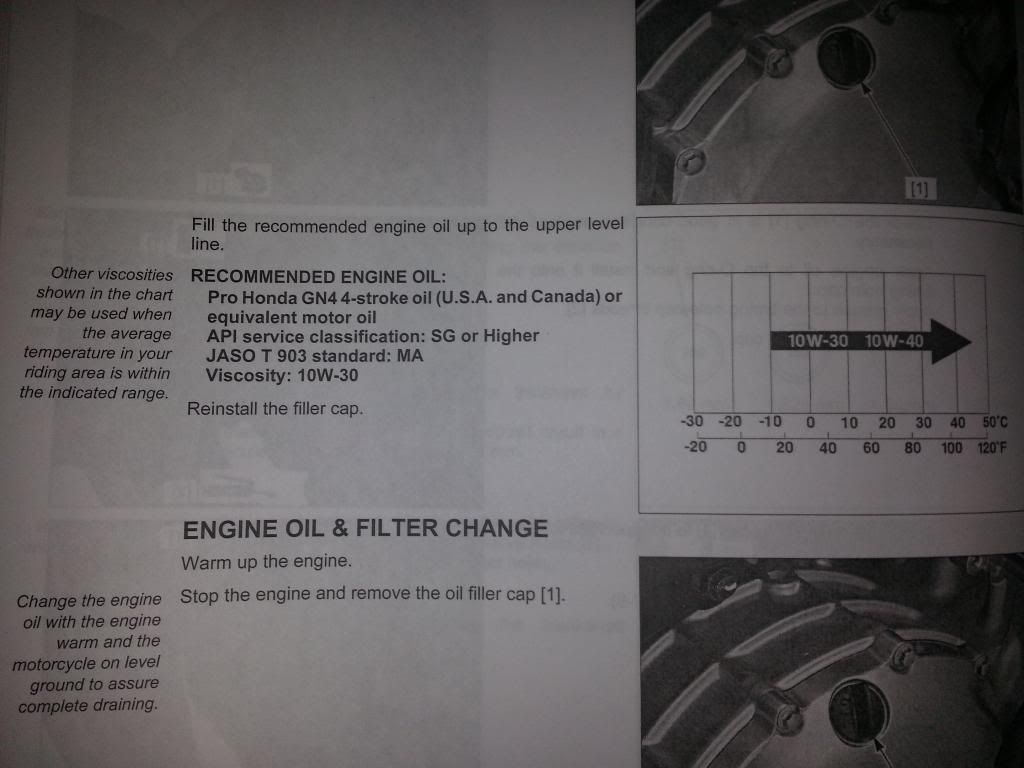

Not trying to start an argument, but Honda says you can use 40 weight oil in higher temps. In the service manual, Honda recommends 30 weight, and, in a side bar Honda says:
"Other viscosities shown in the chart may be used when the average temperature in your riding area is within the indicated range."
The "other viscosity" is 40 weight. The chart could have been clearer about the temp range, I interpret the range as 60 degrees F, and/or approximately 15 degrees C.
Regardless, Honda clearly states that 40 weight oil can be used in higher temperatures. They do not exclusively recommend 30 weight or nothing else.
I was at the dealer on thursday talking to the service manager, I told him about the problems some owners are having with 40 weight, (I was concerned because I am running 40 weight). So I asked him if he was sure about using 40 weight oil, since after all, Honda recommends 30 weight. He showed me page 3-14 in the service manual. He said they used 40 weight in all of the CB1100's they sold, (12 of them), and have not heard of any issue. He also assured me that using 40 weight would not affect the warranty. I just took a picture of that page from my service manual.
[url=http://s1290.photobucket.com/user/dsargee/media/20140412_211526_zps96e488ca.jpg.html][Image: 779e91f26e6a8f427e0d10e5a4acf1ba.jpg]
I am convinced that the problems you guys had were a result of the colder climate, this is (probably) why the 40 weight did not work out for you.
Those of us that live in warmer climates and are using 40 weight are, in fact, in compliance with Honda's recommendations, and need not worry. I wish I had looked at the service manual sooner.

Well the English language and how it is written or read leaves quite a lot to interpretation. Like when someone says "ride it like you stole it", how many different ways can that be interpreted???
Is that the same 1100 manual that someone else had checked and reported back the 30 weight? Who knows... Looks like one page may be the same but another area doesn't mention anything else.. Are there different versions of this manual? Who knows... Are there different interpretations? who knows... Please see the other thread http://cb1100forum.com/forum/showthread.php?tid=2551
Any number of things could be interpreted here. When I asked my dealership they came back and said 10w30 and said it did not mention any other viscosities... That is how the dealership read it...
Like I have said numerous times now, if your bike can run the 40 weight oil and doesn't kick scream or make goofy noises then great for you. You are one of the lucky ones... There is a good number of us that have the, for the lack of a better term, finicky bikes and not all of us are in the frozen climates.

The excerpt I just posted can only be interpreted in one way....

It is the Honda service manual for the 2013 Honda CB1100, the same one the Service Manager at our local dealer has........Do you think I'm lying about this? What do you need?

Not sure what else you could get out of it.

Agreed
