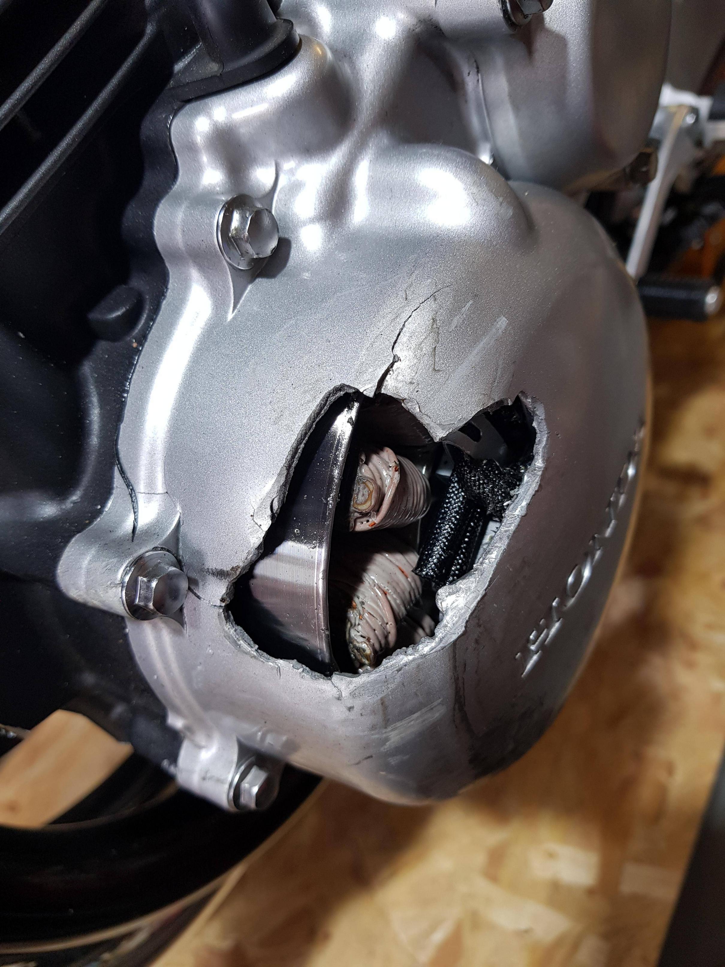

Yup! This is what happens in even a minor spill...
