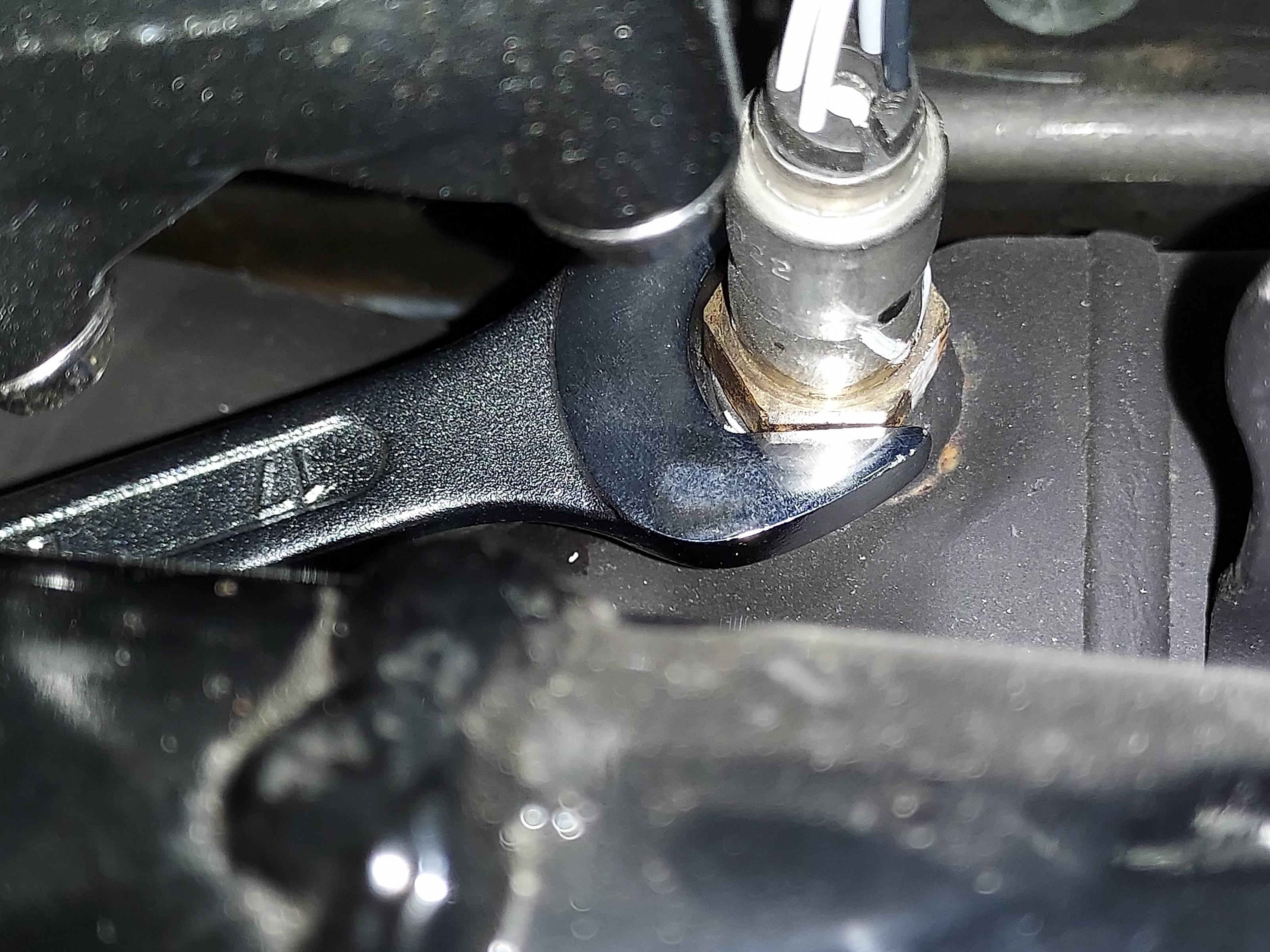

Now it bacame easy and straightforward... The nut on the sensor of my 2018 model is clearly accessible, unlike the 'sunken'/hidden ones of earlier models. A 17mm OE spanner soon had it undone...
[Image: e43ec3924ff6b1590b415095dd578944.jpg]

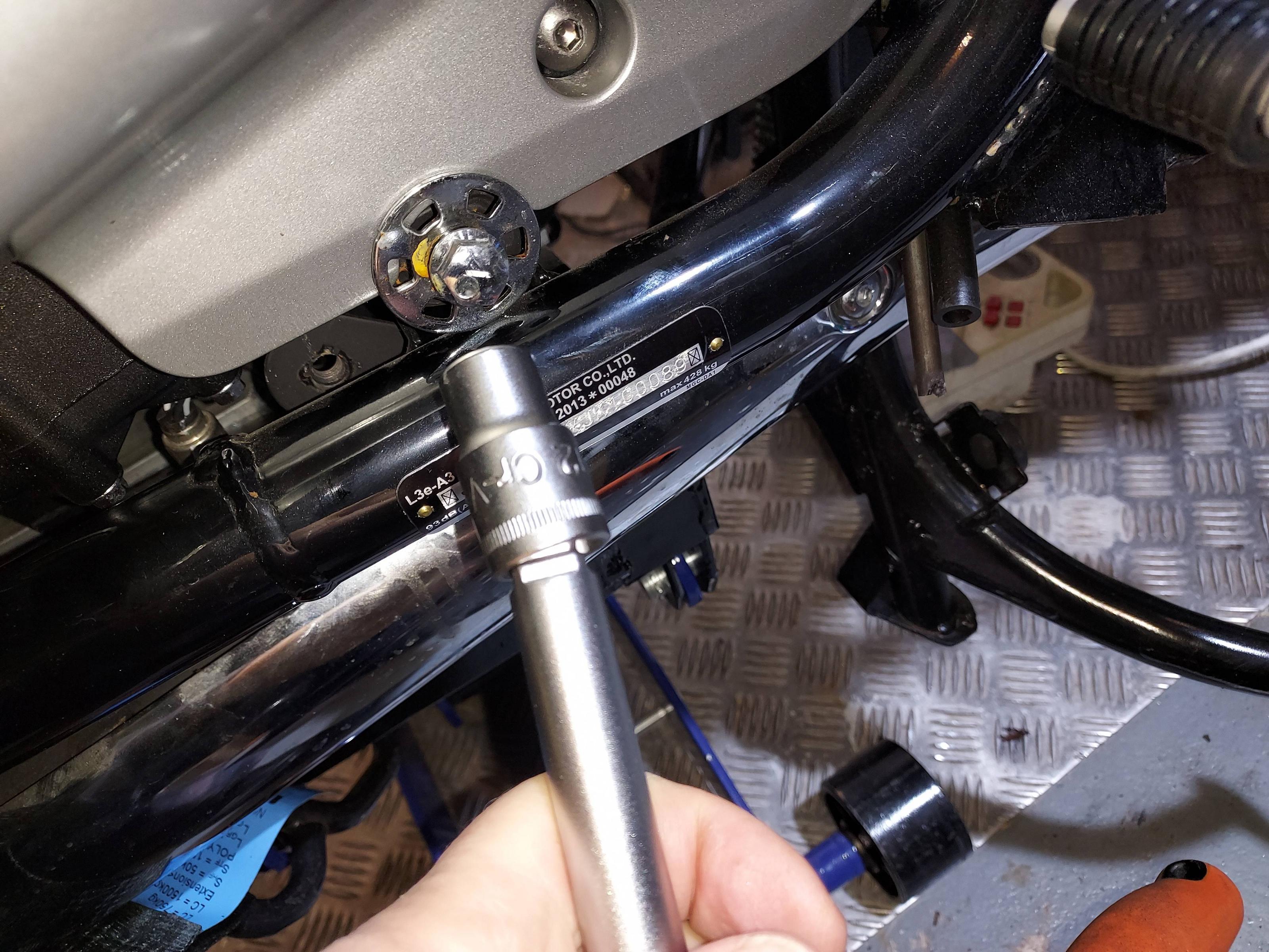

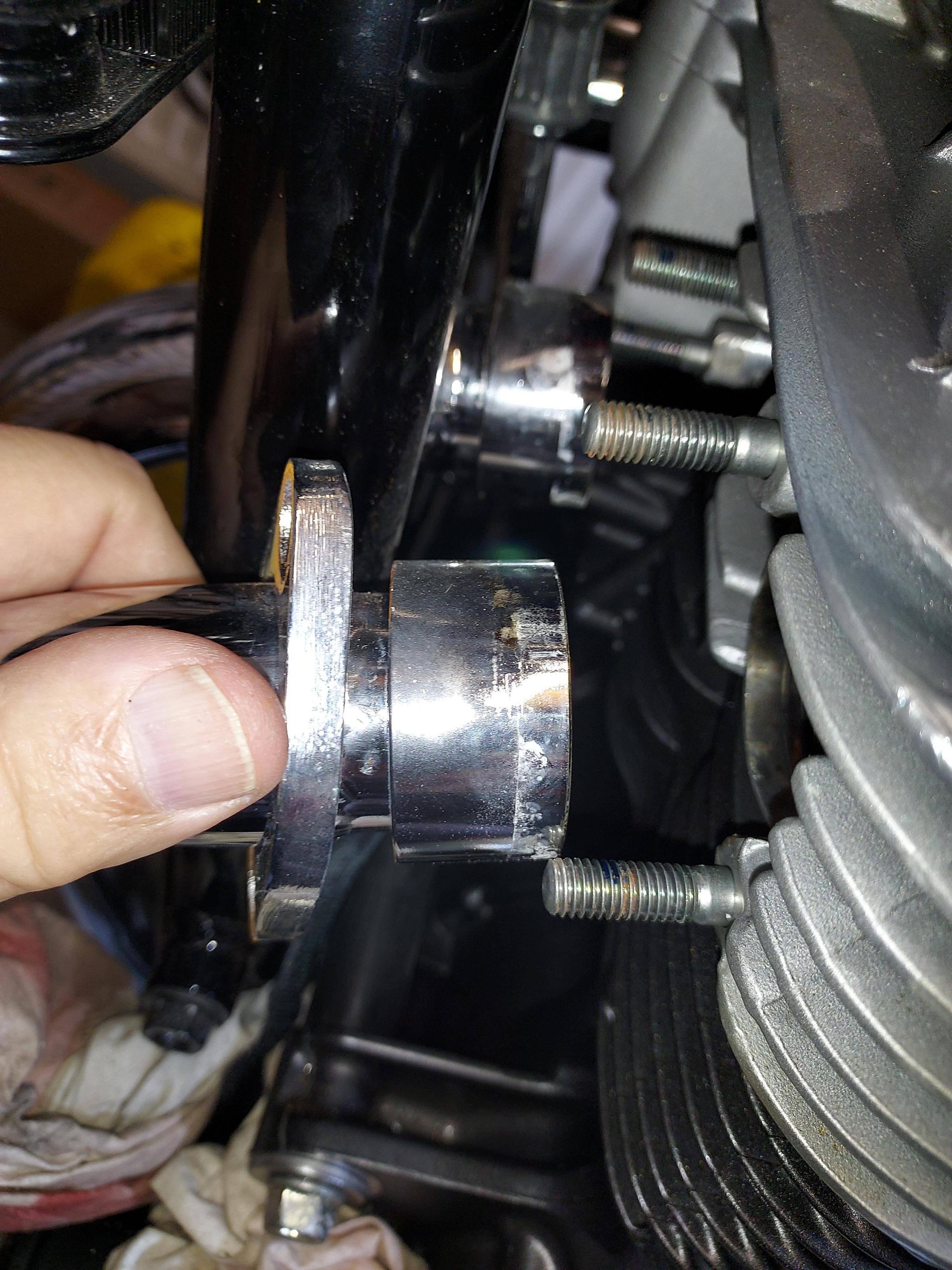

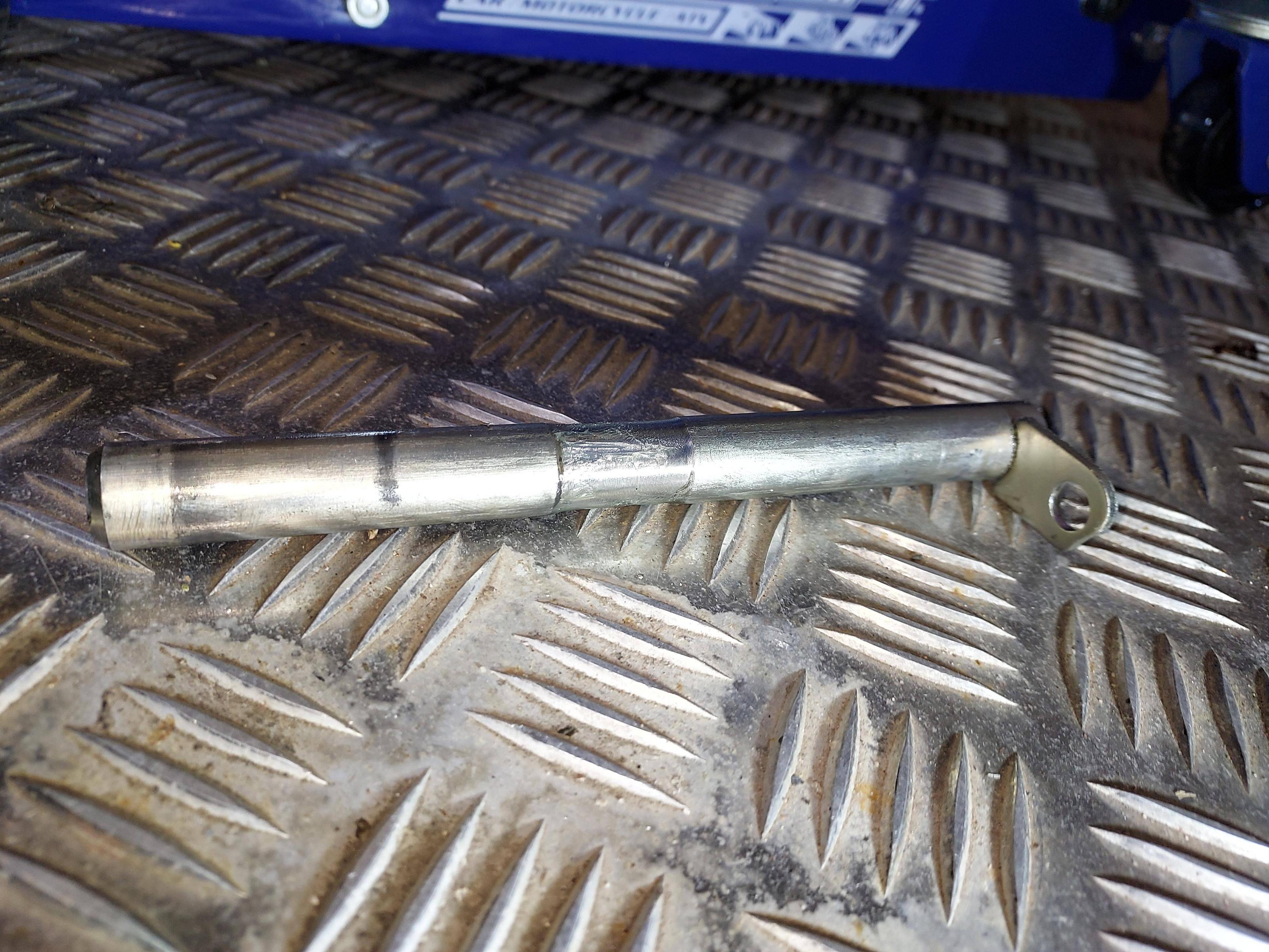

Now we came to the difficult bit - removing the main stand. I recommend two people to tackle this. If you're doing this job on the ground, it will be very difficult. I think. If you're doing it on a bench and actually using the main stand it will still be difficult, I guess, until you suport the 'bike by other means. My CB110 was jacked up under the engine, so the stand was easily "get at-able", once I'd figured out how it worked. I did not have a 'spring puller' so I went to do what I've always done with centre stands, just pull out the hinge bolt(s). In this case though, I had a problem... the hinge bolt is very long and jammed before I could pull it right out. So... I tapped the upper end of the spring off the piece of frame holding it, and BOINGGG! The spring popped off and the stand was free, held on only by the hinge rod. This rod is captive, with a small, almost hidden, 5mm hex bolt holding it in, situated ABOVE the right hand side. Undo that bolt and tap and manipulate the hollow rod out ( I used a large hex key). The stand is now free and can be removed.
Note the small flange that the retaining bolt fits through.
[Image: 8de4dbcf08db34677acb76c567601db2.jpg]
The spring hooks onto a small piece welded onto the frame - i just pushed/tapped it sideways (with hammer.and long screwdriver!) to push it off.

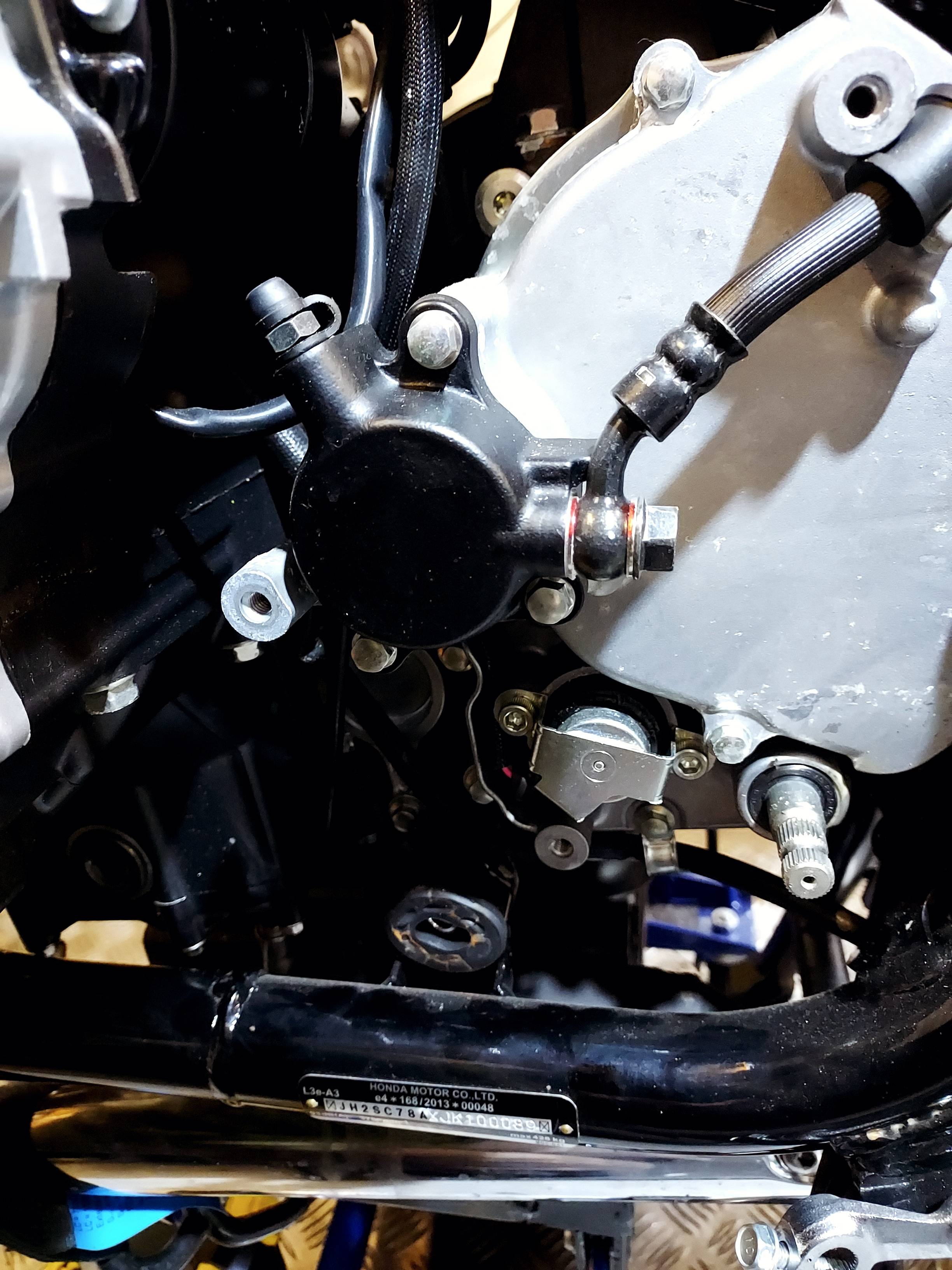

Now you know where the clutch slave cylinder bleed point is too!
