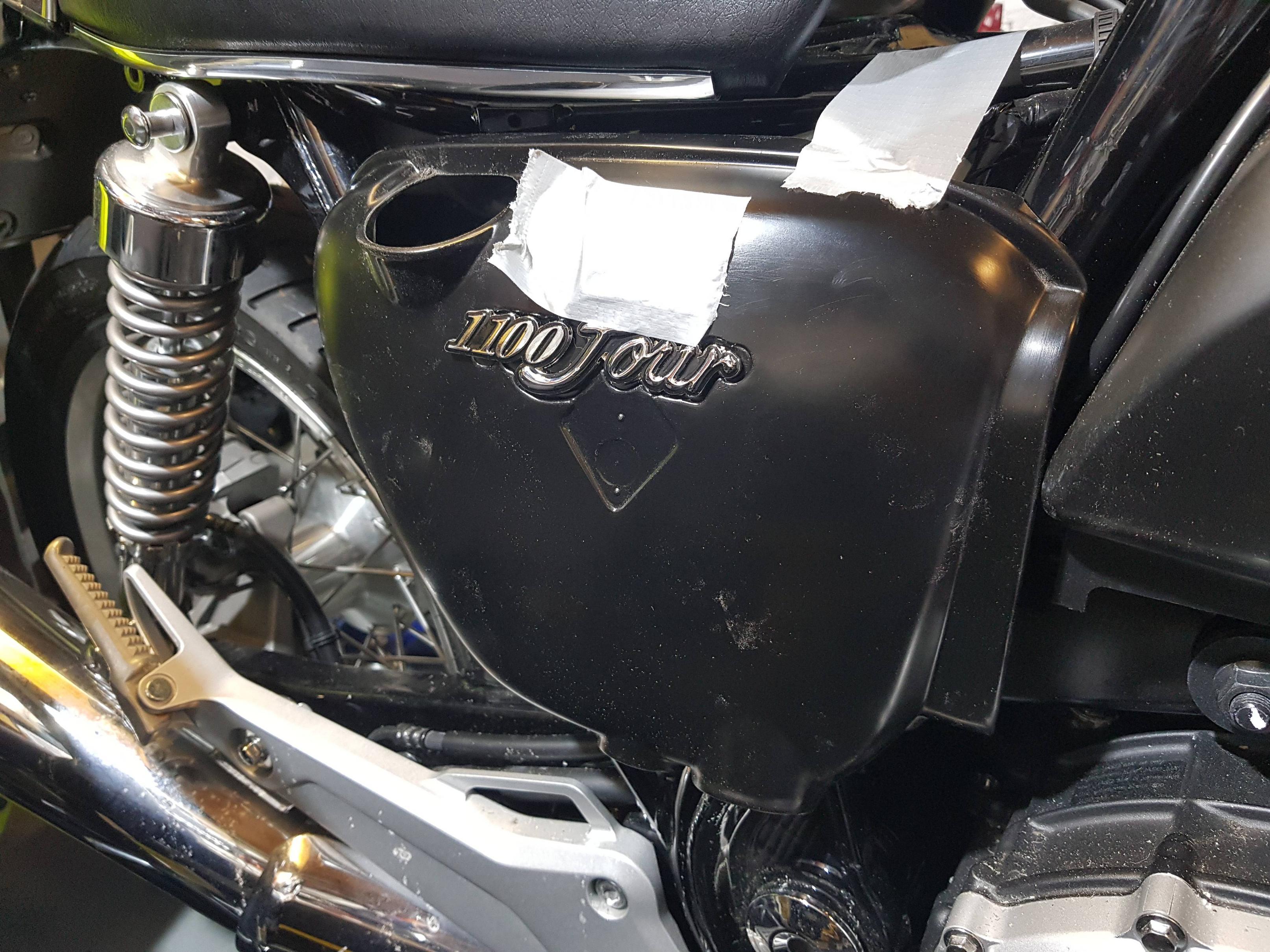

K.My tank fabricator is asking me how many do I think he should make? I just don't know. How many here would be interested in doing what Neinmeister has got? Because of the astronomical cost of the Whitehouse items, I'm sourcing alternative items from David Silver Honda CB750 spares. The original CB750 front mudguard (fender) fits - it just needs two small brackets to attach the stays and we now have drawings for this, courtesy of Neinmeister. The original side-panels - I'm in the process of altering to fit. The headlamp 'ears' are more problematic, but I know it can be done - I've seen an example of how.
So... it looks like this replica CB750 conversion CAN be done cheaply. Anyone else interested? Let me know so I can let my tank fabricator know. Thanks.
Not very elegant in raw black plastic and taped to hold it on, buy it can be made to fit!
