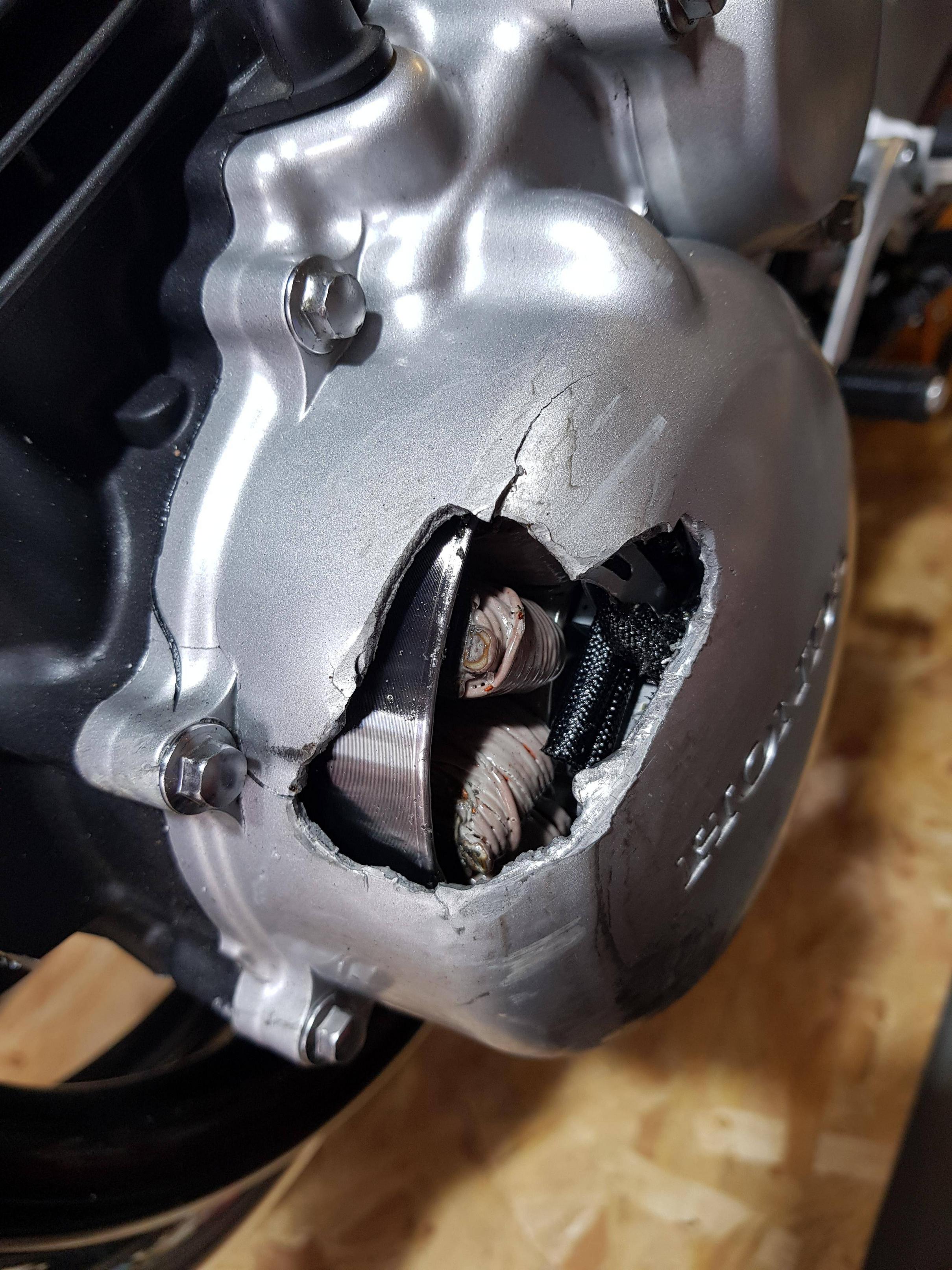

This had taken a hefty whack in the accident, resulting in a hole in the cover and fortunately only very slight damage to the generator itself - one coil slightly moved and a small ding in the rotor. I took a chance buying the 'bike with the potential for expensive damage here, but I struck lucky. It would have cost about £400+/$500 to fix if it had been damaged.

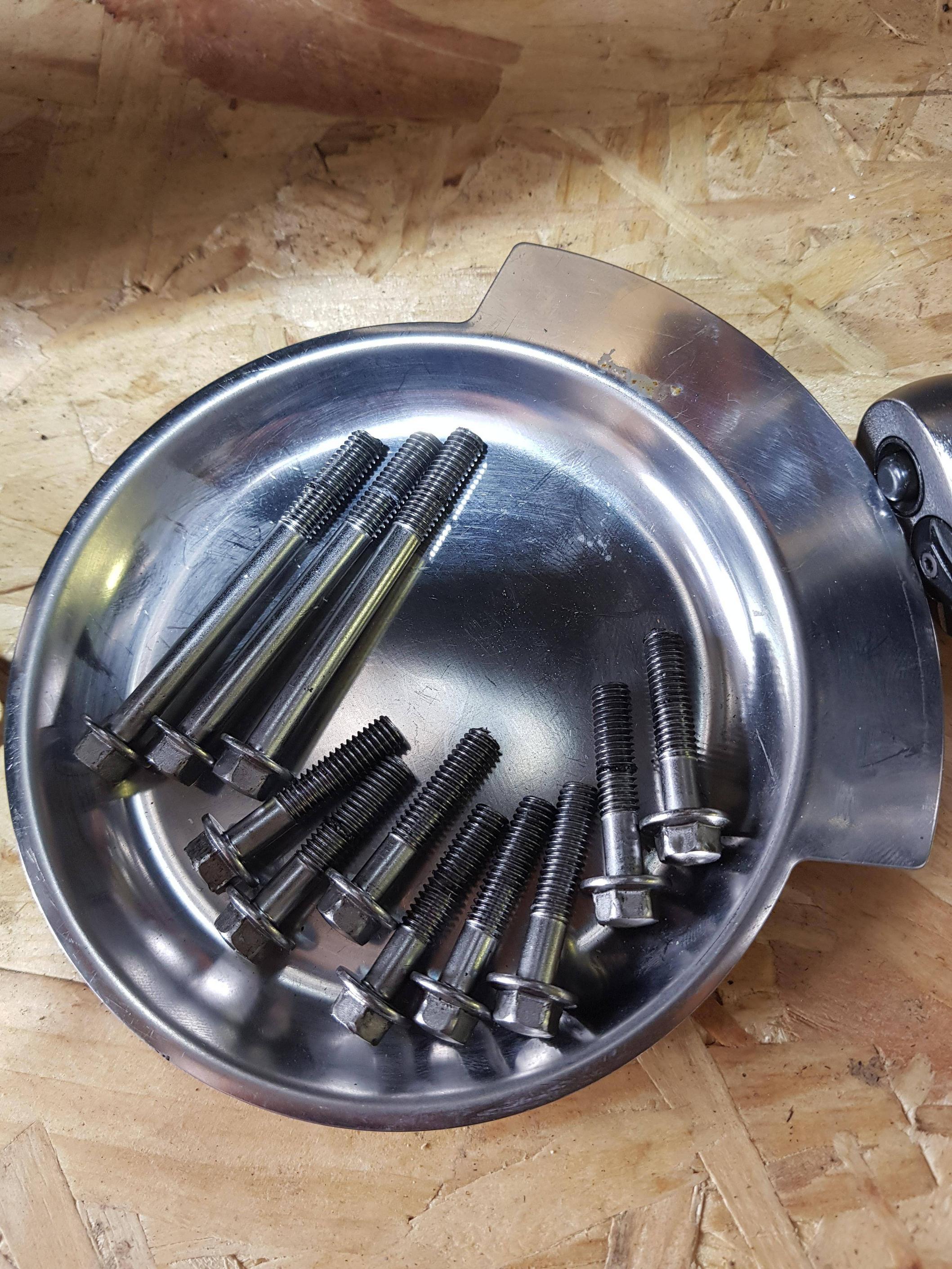

Next, remove the eight 8mm bolts holding the cover on.
[Image: b08ea89fbfcc51ff186415ae11257b5d.jpg]
They're all the same length but much shorter than the starter gear cover.
[Image: 6f868ab20a8eaa51022e9f30f55859fa.jpg]

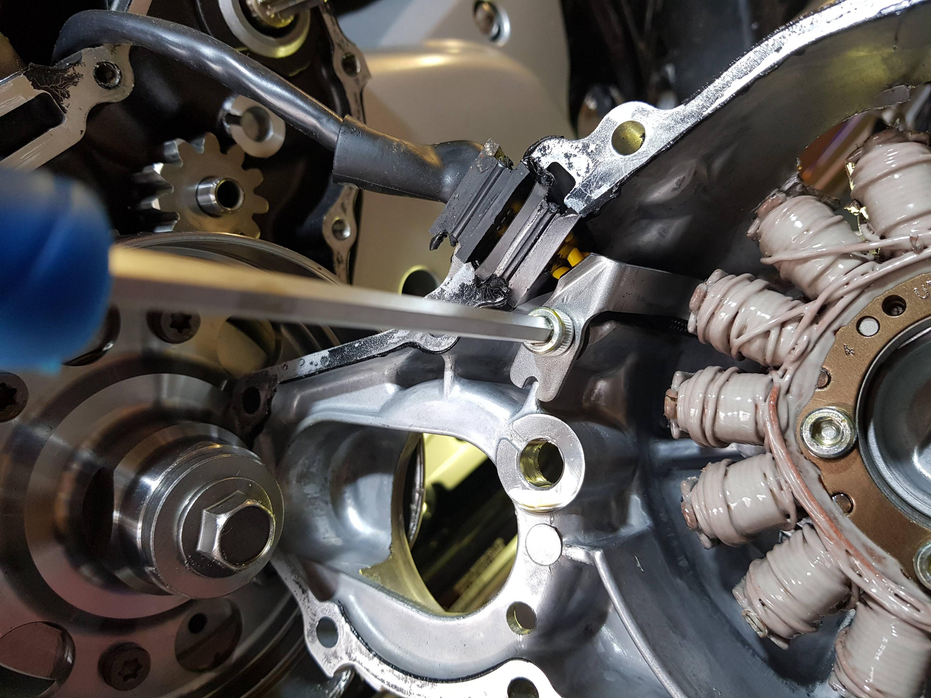

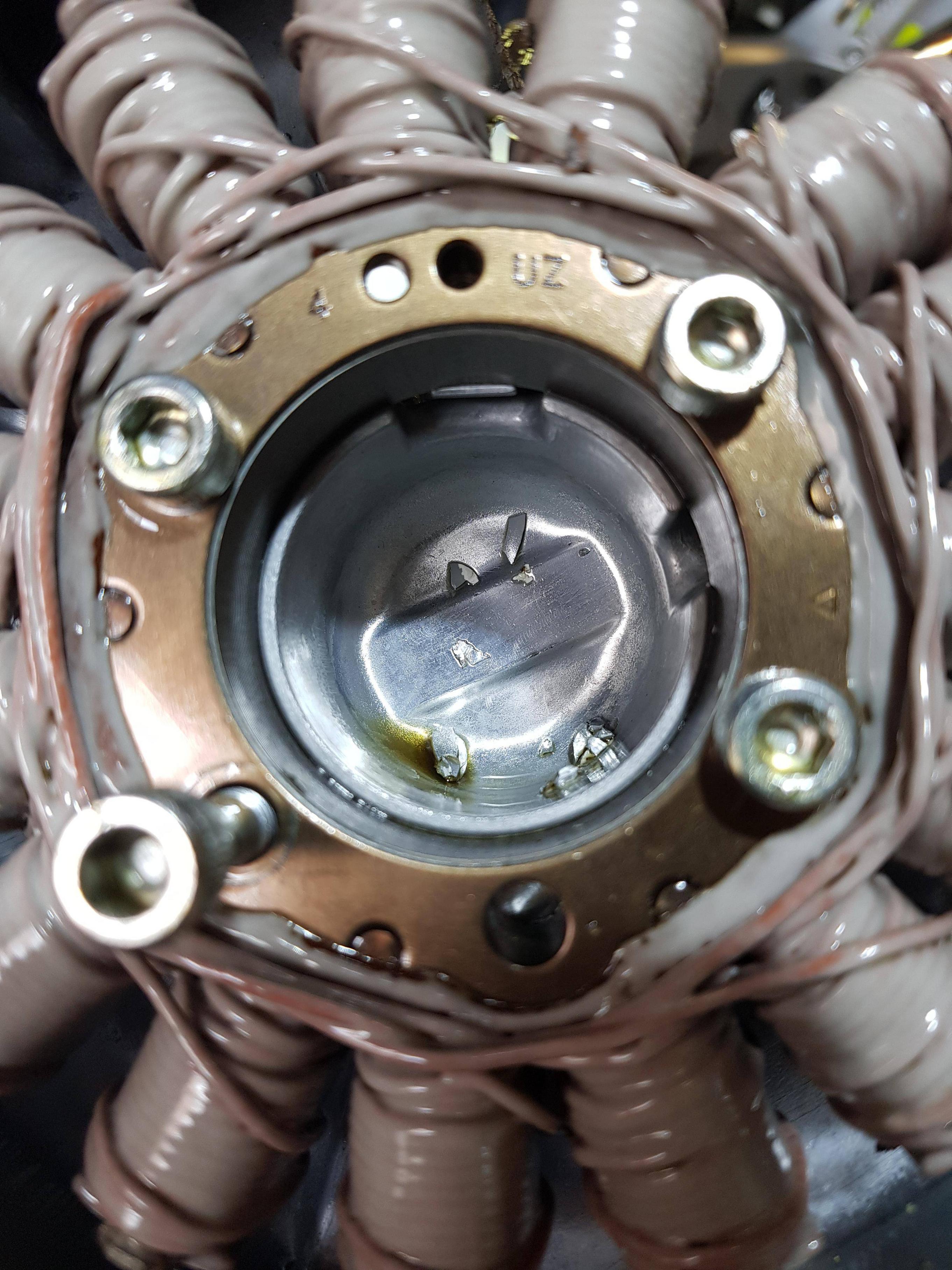

Then undo the four hexagon bolts holding the stator onto the outer case.
[Image: acf6636ec54cba57147534803999bb2f.jpg]

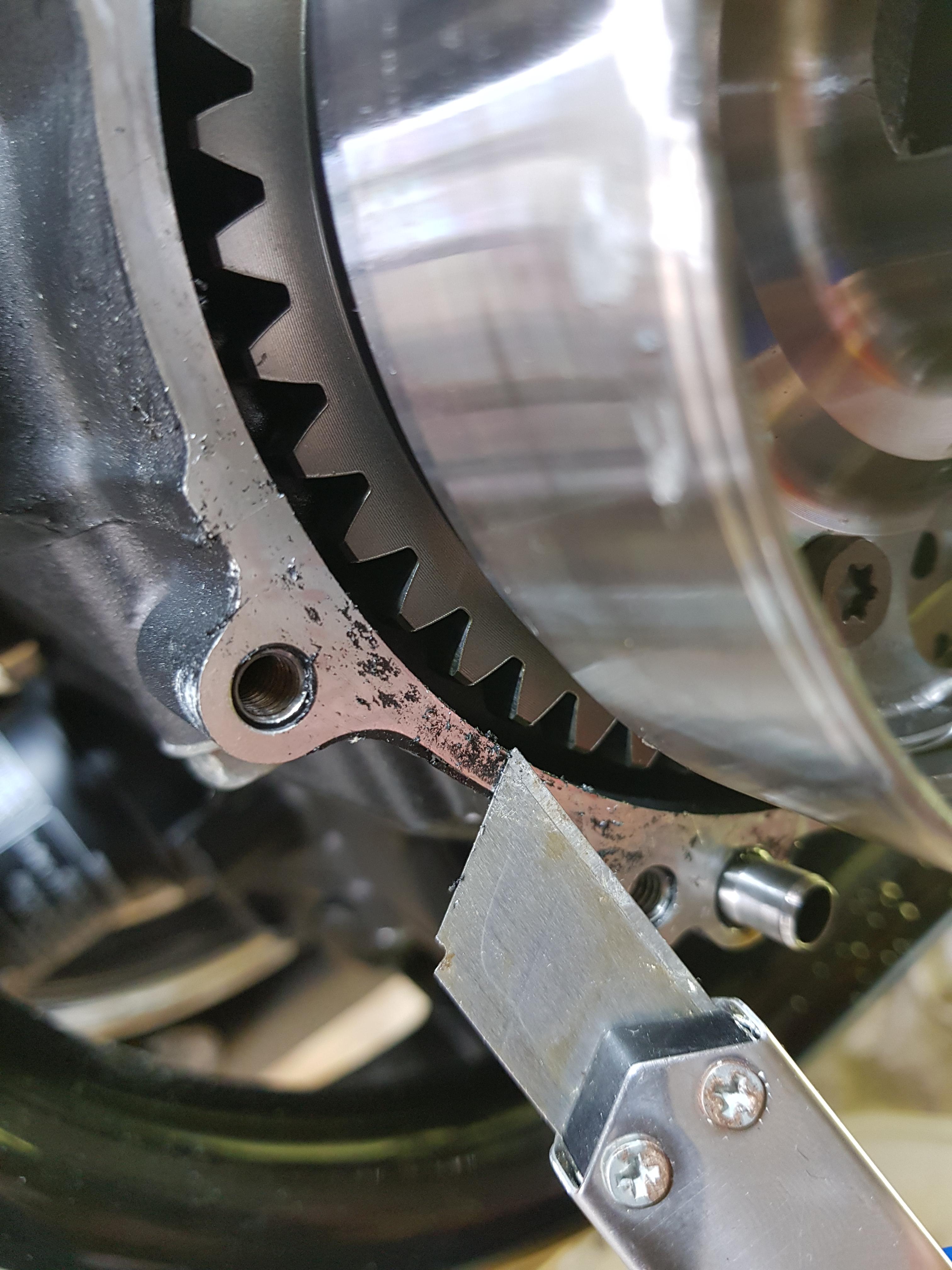

You can now remove the cover and put it to one side. I wrapped the stator in a small towel and placed it on top of the engine - it just wedges there nicely. I set to, VERY gently, scraping off the old gasket sealant from round the mating surface. I found it safest to drag a blade backwards so as not to mar the soft alloy surface. I occasionally resorted to a finger nail! I finally used brake cleaner to clean the entire mating surface, prior to using Honda's gasket cement (Three Bond 1207B).

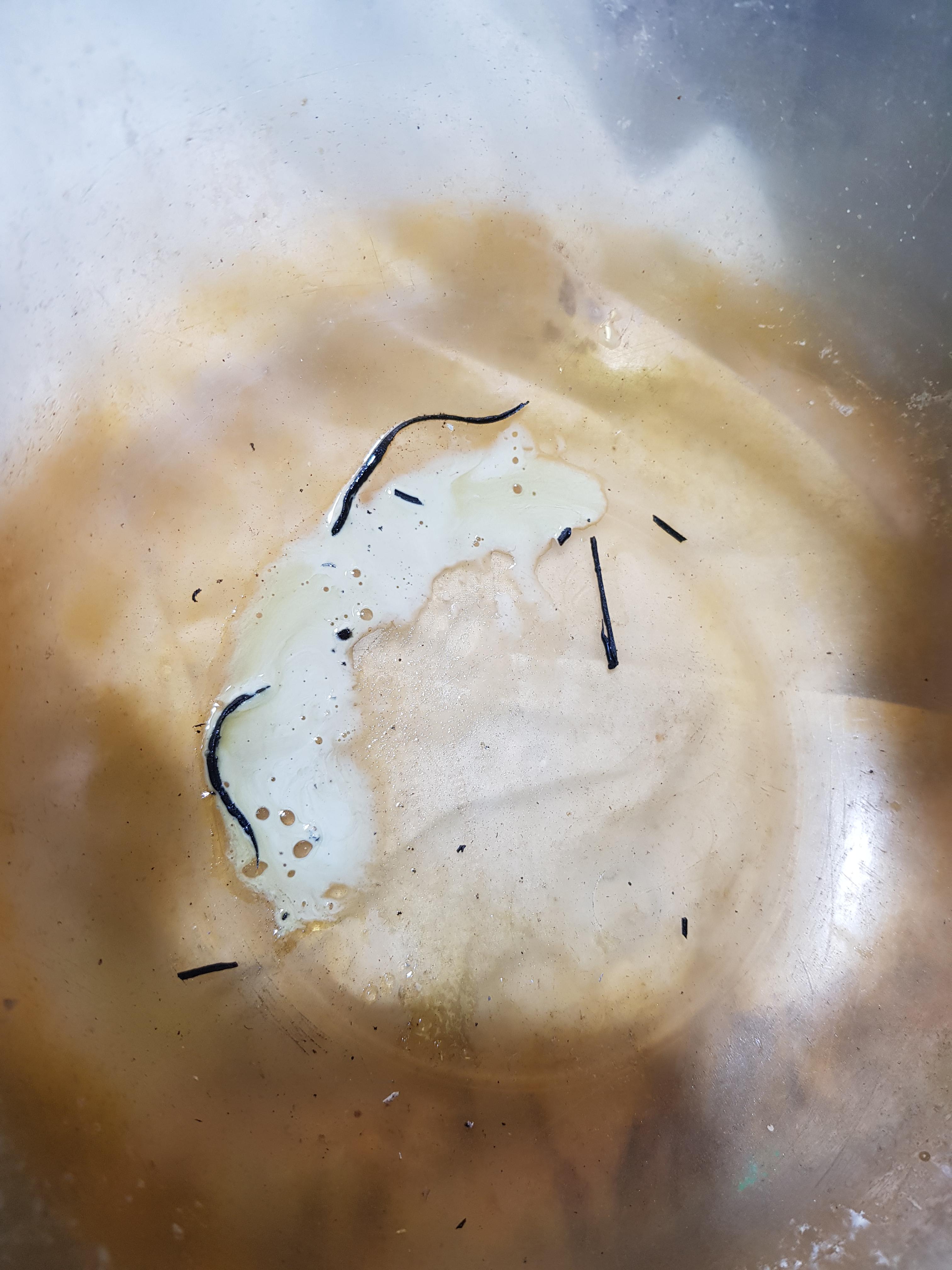

I was concerned that small pieces of old gasket cement were clinging to the inside of the crankcase. They came out with the drips of oil and as I was cleaning and I imagined what would happen if they got caught in an oilway... I was careful to ensure that none were left.
[Image: ff900bc424baf7a75042538fb3ef9b7e.jpg]
[Image: 949c2447bd267f612c0559dacb27b16b.jpg]
