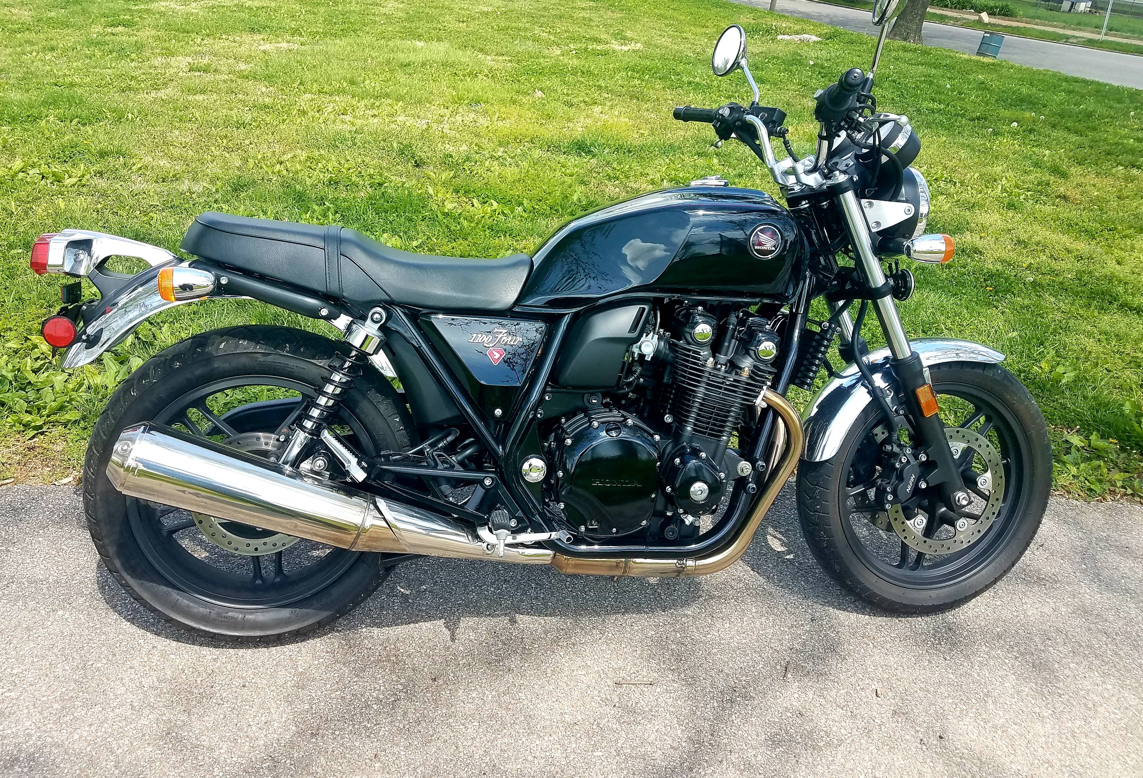

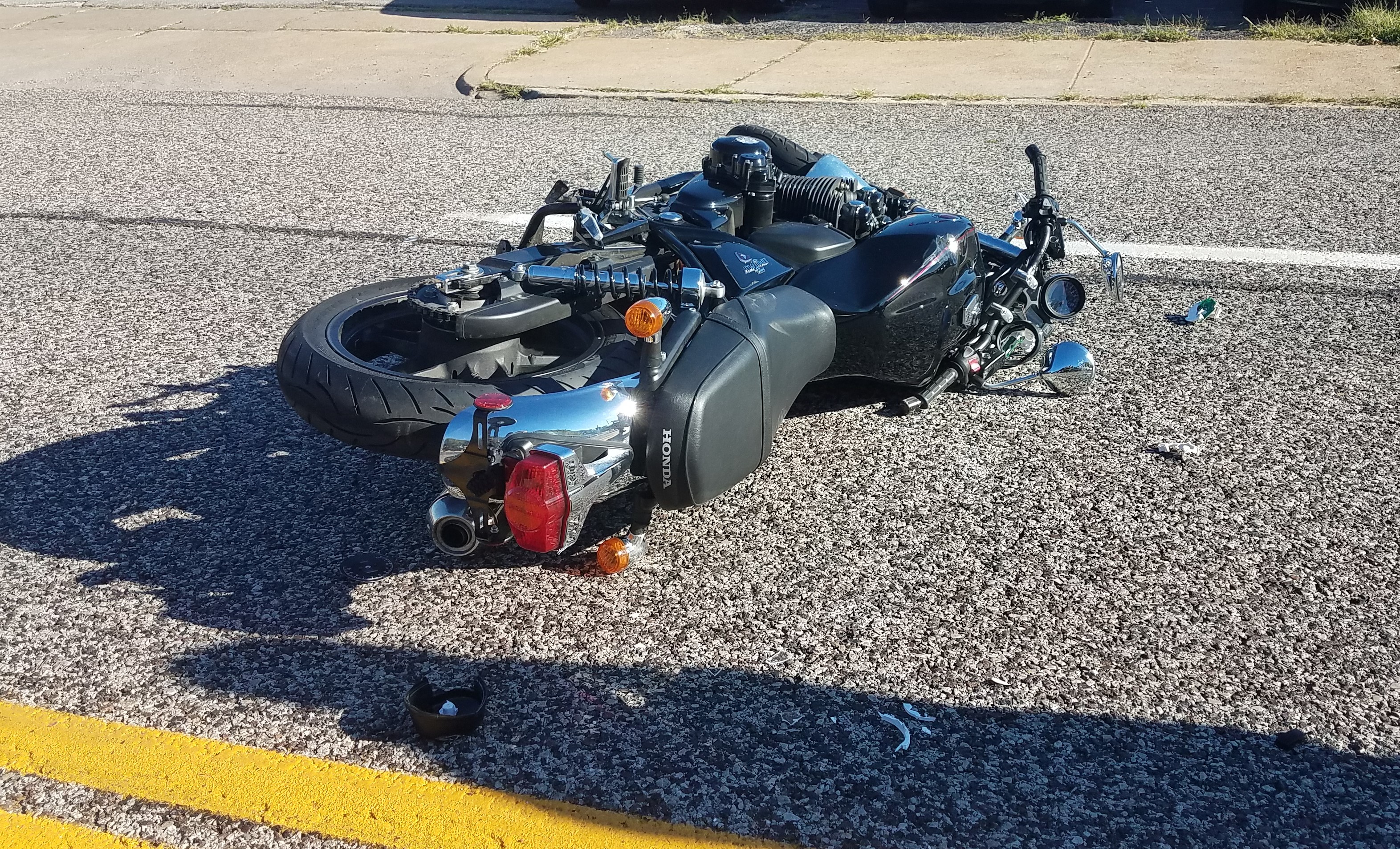

Before and after going down when an uninsured driver made a u-turn across two lanes and stopped cold.
Would you...
-repair the org. tank?
-replace the tank with oem?
-replace it with a 2017 one?
-buy a Whitehouse?
-other..

I don't think that tank is repairable in the practical sense. The dent is on an edge, and has pushed the side and top up and outward . The tank would at least have to be cut open from the back and an expert metalworker might be able to resurrect it.
A 2017 tank would use a different gas cap with a different style of key. And the fuel pump will interchange, but the sender unit may not read correctly
