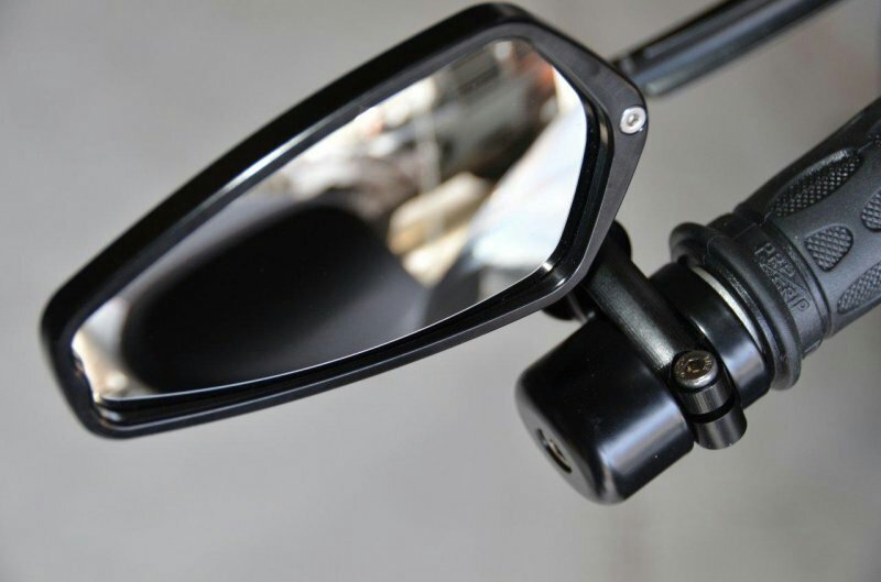

Hey guys, is there a way to keep the in handle bar weights and add the crg lane splitter mirrors with the adapter for the 7/8 inch handlebar?
RE: Handle bar weights and bar end mirrors... - kmoney_imp - 06-06-2015
You can turn down a section of the stock bar ends in a lathe so that they are 7/8 OD. Not the entire bar end, but just a channel wide enough to allow the clamping portion of the mirror to sit inside. Most competent machine shops can do this for a reasonable fee (probably less than the ~$20 per side the CRG adapters cost). The pic below is from a Ducati, but you want to essentially end up with the same finished product. [Image: 6c7b70ea586cfe8b9a8756b04a02e172.jpg]

You know, that is a great idea Thumbs Up
RE: Handle bar weights and bar end mirrors... - brougham79_imp - 06-06-2015
good stuff, i'll look into it!
