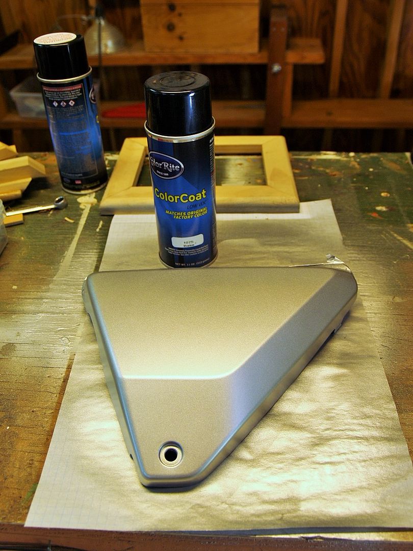

Next the covers were sanded with 600 grit sandpaper and finished with 0000 steel wool. One coat of primer was applied.
[url=http://s1259.photobucket.com/user/stumpshooter/media/20170402_12_zpsrlnlgodf.jpg.html][Image: 11198955e38b4ead1f91afc4f84b8d5d.jpg]
After allowing the primer to dry thoroughly, two coats of the Color Rite base color was applied allowing about 20 minutes between coats.

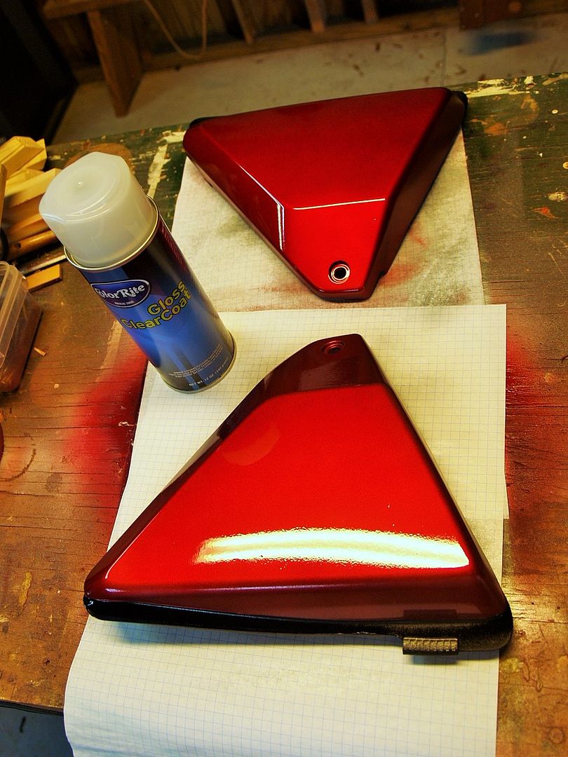

After allowing an hour drying time, the masking tape was removed. This required using an Exacto knife to carefully trace along the tape's edge so as not to pull the paint. Three coats of the Color Rite clear coat were applied, 20 minutes drying time between coats.
[url=http://s1259.photobucket.com/user/stumpshooter/media/20170402_19_zpsujicpj8u.jpg.html][Image: 31d8a61d4017bb7c722a276e831597ae.jpg]
[url=http://s1259.photobucket.com/user/stumpshooter/media/20170402_22_zpslptbmnsy.jpg.html][Image: 35d2883a80811a9597c8490ba984a4b7.jpg]

Candy Glory Red requires a base color, top color and clear coat. The base and top coats were $33.95 each. Clear gloss was $16.95 and with shipping came to $99. I used a primer suitable for plastics from my local ACE Hardware, about $4. Other items I had on hand. Buying the covers outright is about $300 with shipping.
