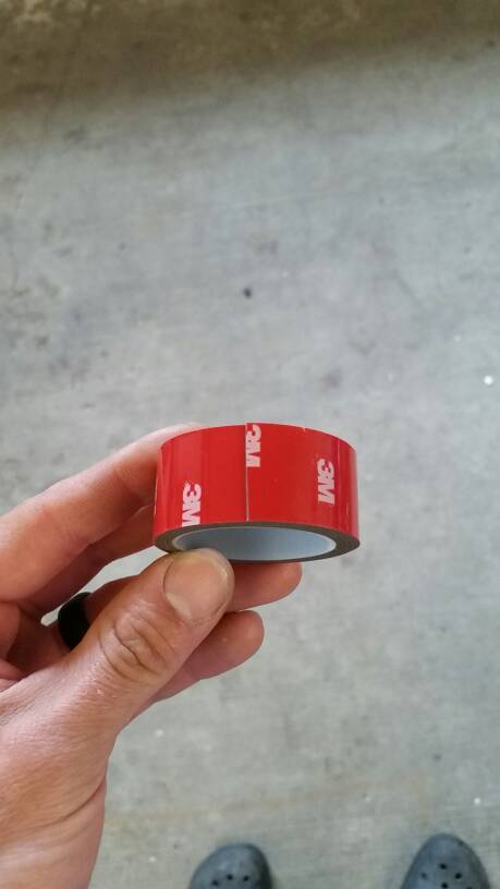

3m double sided tape! it's used in automotive application's for vehicle emblems and impact moulding comes in wide and skinny roles will never come off but can easily be removed with fishing line or carefully with thin plastic scraper if needed![Image: f0e65f91d9b833cb10cb22368875556c.jpg]
