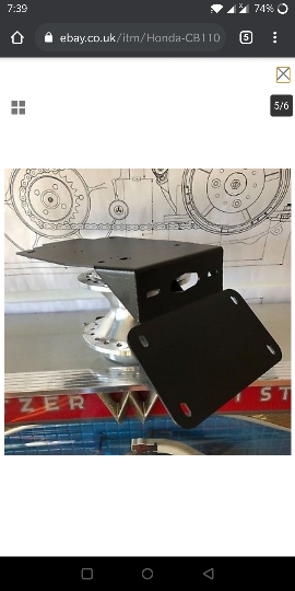

Had anyone perhaps purchased this tail tidy [Image: 74e30a16ceb33cf873b617aa8474c42a.png]
If yes, would you mind measuring it in detail because I'd rather make it than pay 200$ for a piece of steel

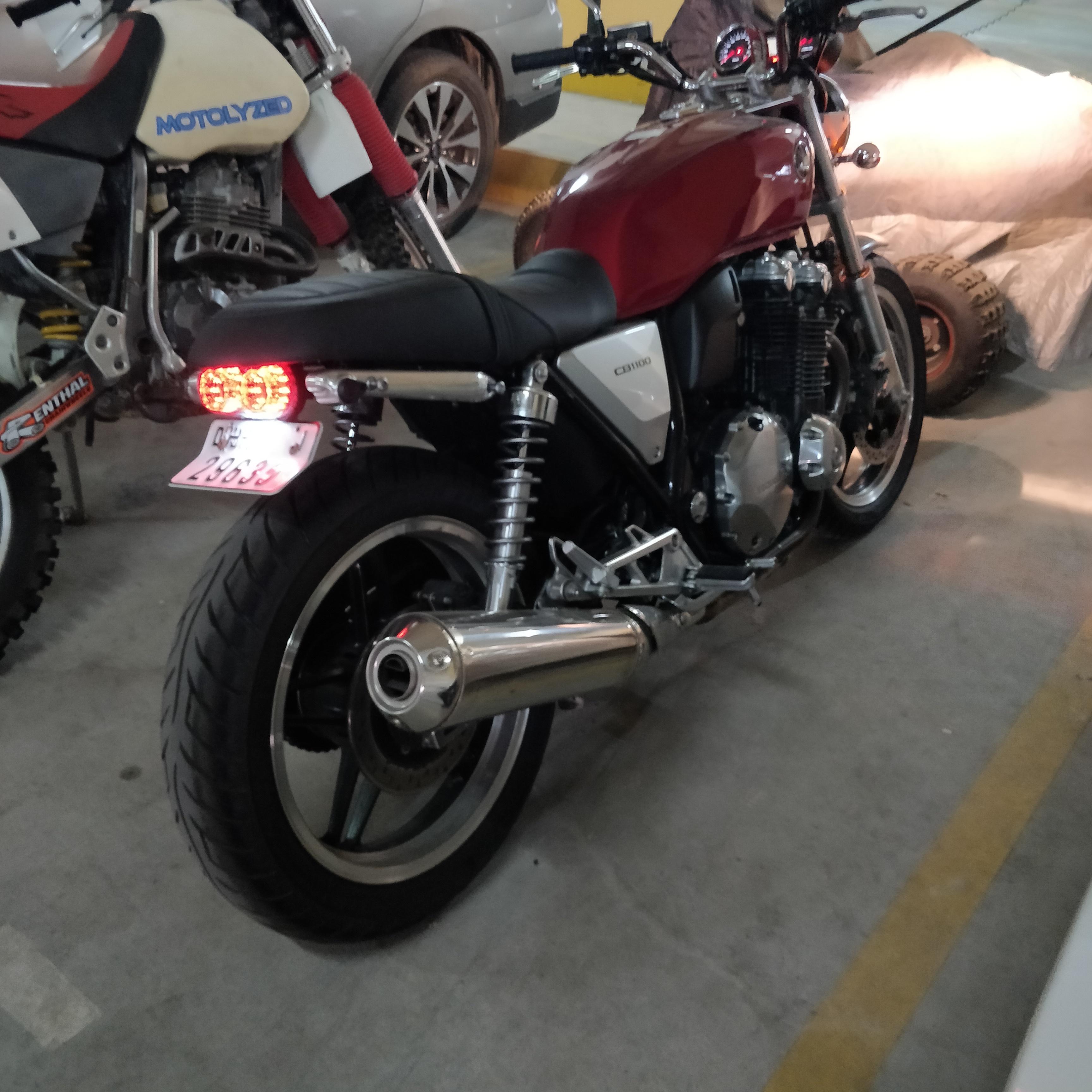

I will probably use the tail lights on the third pic, so I just need the measurements for the plate that goes under the seat[Image: c02d4e4a3f63ff42e25934bf5cef45f6.jpg][Image: 99d8c77aa0814047de47ed28e6896658.jpg][Image: e4ba13b8534f489bb7f336b19663412d.jpg]

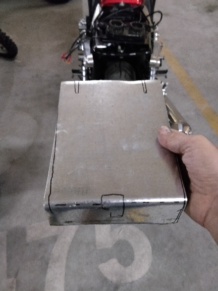

Anyways, I pulled out my trusty ole tool kit and made a cardboard pattern, I'll go have it cut, got quite a large piece of steel, so I'll probably make two or three if someone wants
