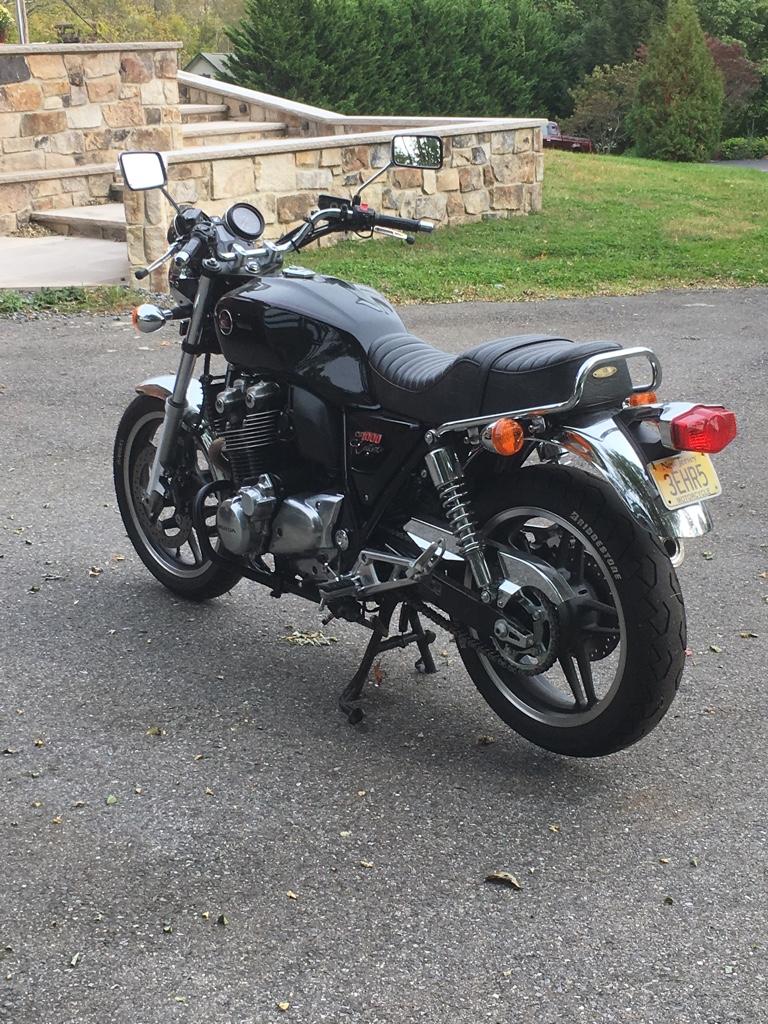

RE: bars - PowerDubs_imp - 02-10-2021
I put bars on my bike off another Honda model that are more pulled back- and a little wider.
I find them MUCH more comfortable than the stock bars.
[Image: 6a96223c1c3a9460587fb95f6cdb5300.jpg]
[Image: d9624a728e28456a069e25b77bc3e3bf.jpg]
RE: bars - GoldOxide_imp - 02-10-2021
Dang Dubs - if there was a vote for most "classic lookin" circa early '80s CB1100, I'd pick your photos. The "white walled" tires also really help. Never get bored.
