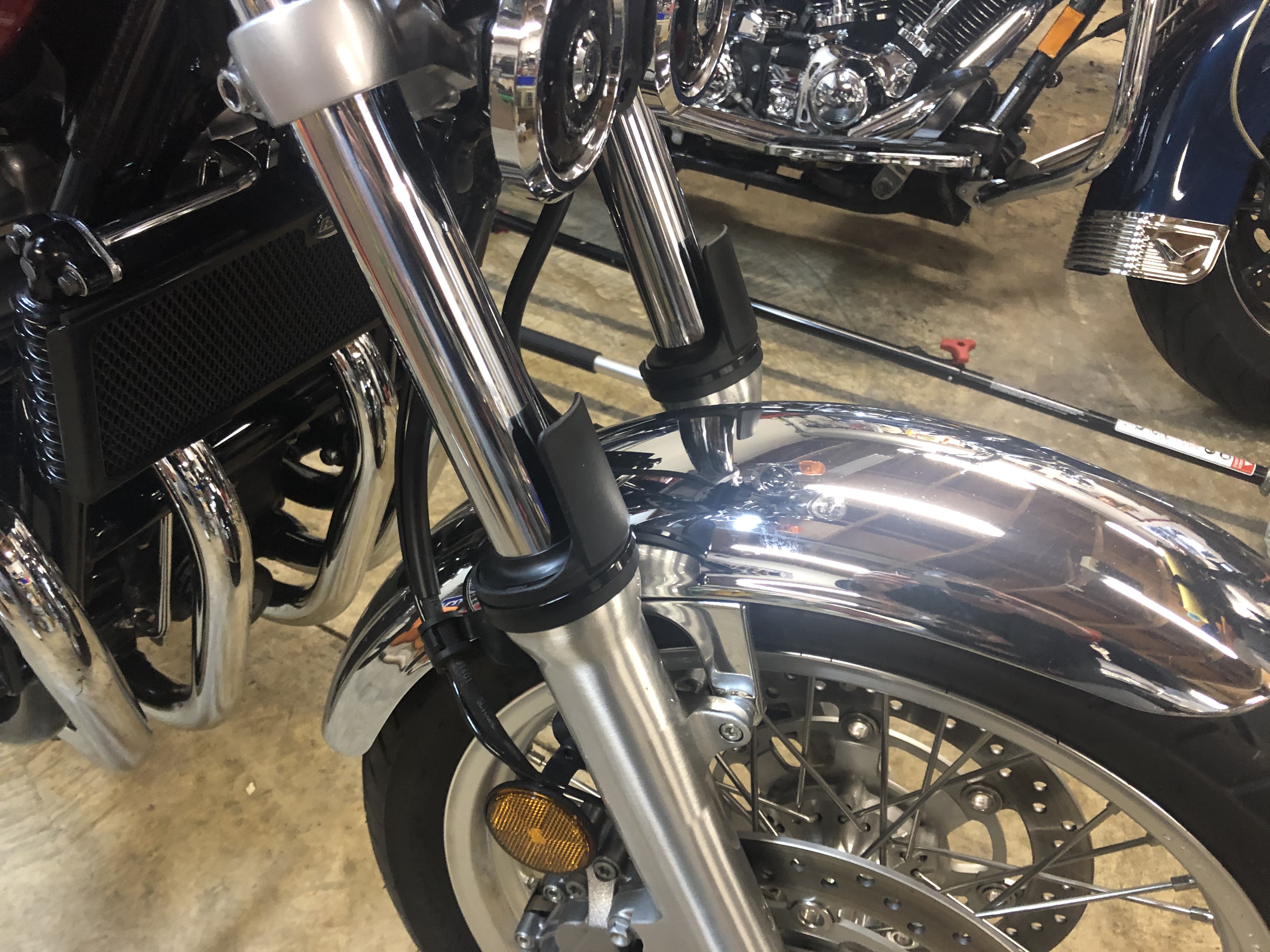

Protecting the fork tubes from damage is a good thing to do. I am not a fan of the way gaiters look, so I added a set of plastic fork protectors. With weight on the bike, they should provide good protection on the areas of the fork tubes where the seals travel. They have split ring mounts so they clip right on with no disassembly.
[Image: 97afcf27ba77a7e7aa147da1a287132d.jpg]
[Image: 1693c4dab95c4d8e476fbf8192d11349.jpg]

(03-23-2021, 10:08 PM)apex1_imp Wrote: Protecting the fork tubes from damage is a good thing to do. I am not a fan of the way gaiters look, so I added a set of plastic fork protectors. With weight on the bike, they should provide good protection on the areas of the fork tubes where the seals travel. They have split ring mounts so they clip right on with no disassembly.
I guess 50% protection is better than no protection at all.

(03-24-2021, 01:58 AM)Houtman_imp Wrote: They look good , where did you get them ?
I found them on ebay from a seller in the U.K. but they were the last ones at the time I bought them.
