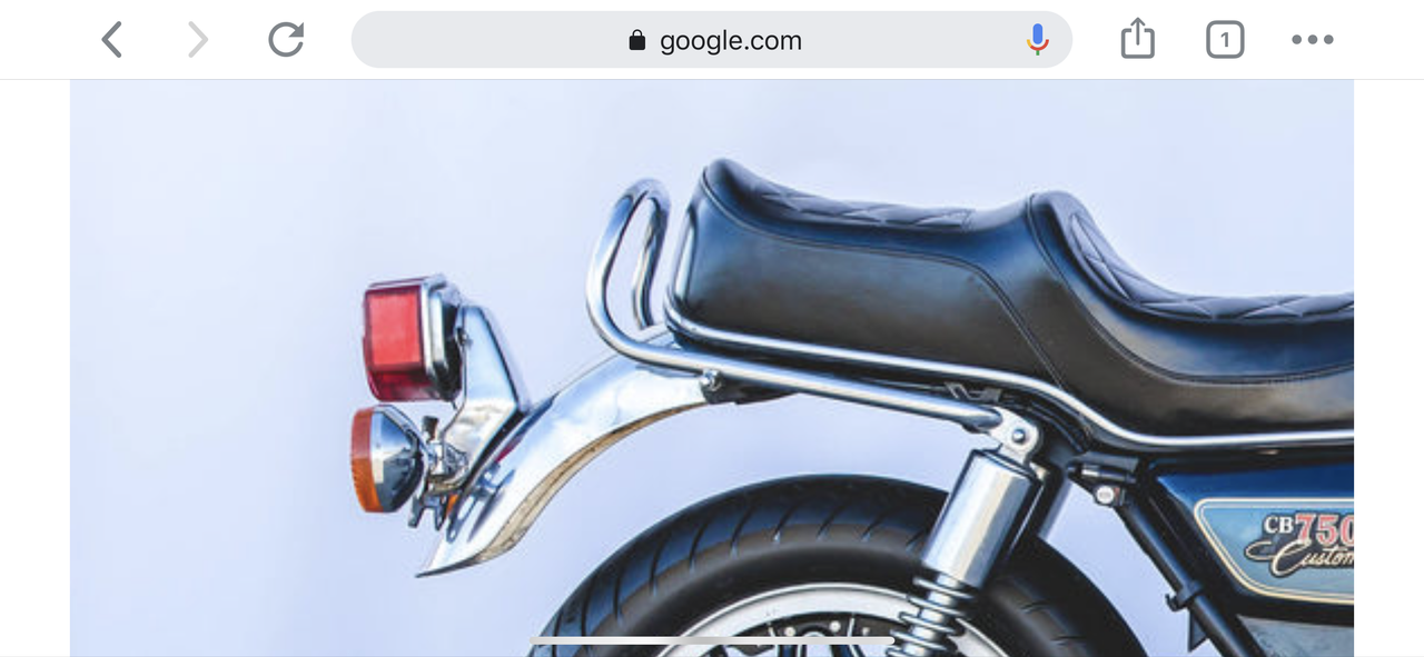

[url=https://postimg.cc/hJrd4s8X][Image: 54f6ce99ae1e79085a6d6d0928be6d98.jpg] This is my 750K I bought new,this is how we built them years ago.
[url=https://postimg.cc/Nyj7XrPy][Image: c329509b4ecc0b5138de1a5fd986c2bc.png]
Grandma Wells liked it. My plans for a pipe are hollowed out cat,polish the stock header pipes then make a slip on to make it look like the Kerker header on my old 750.
