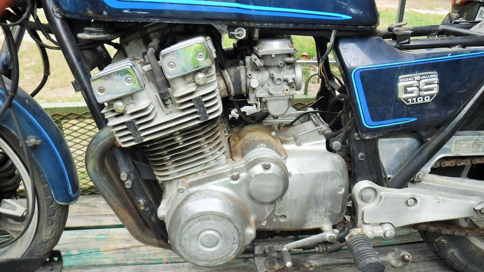

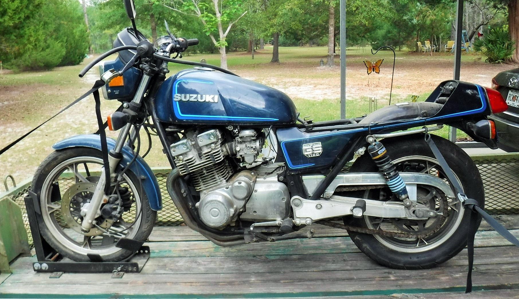

Picked up this barn find GS today for $500. Connected a gas supply to the fuel system, checked the oil, Jumped a car battery to the dead one in place and she cranked up after just a few turns. Right side cover is missing and the seat needs a good cleaning and recover.
Always liked these bikes and I plan to keep this one and ride it. I'll post more pictures as I go forward with the project. Any advice from those with previous experience with this model will be appreciated.

Nice find, Redbirds! Most of these garage queens either have solidly plugged up fuel systems, or the pistons are frozen in the cylinders. Looks like you're way ahead of the game already. I bet she'll clean up nicely. Congrats!
