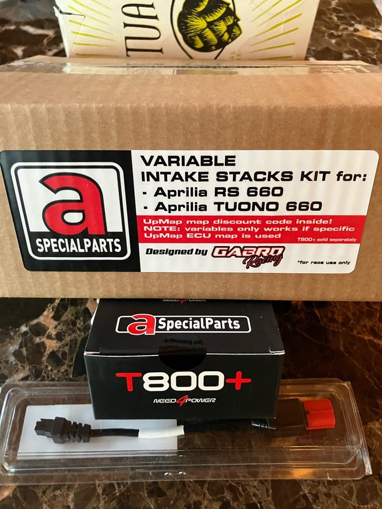

But then one of the Aprilia tuner shops came out with a variable intake stack kit.
One of the issues with these bikes is a dip in the mid RPM range.
This kit appears to fix that, as well as gain some power in a usable area.

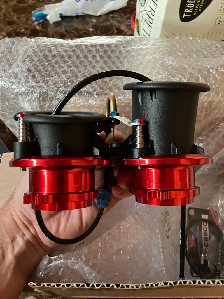

The interesting thing is- he is using fhe PAIR output from the ECU.
Once I have the kit in hand- I’m going to look close at the hardware- maybe I can do a similar setup for the CB- but can just use a trigger out from the power commander.

Just curious, do you expect MIL to turn on after VIS is installed?
Aprilia 660 Variable TB stack kit + tune - PowerDubs_imp - 01-17-2025
No, works the same as if it came from the factory
Some of the earlier V4 had variable stacks from the factory, so I’m guessing he probably used the same actuator hardware.
