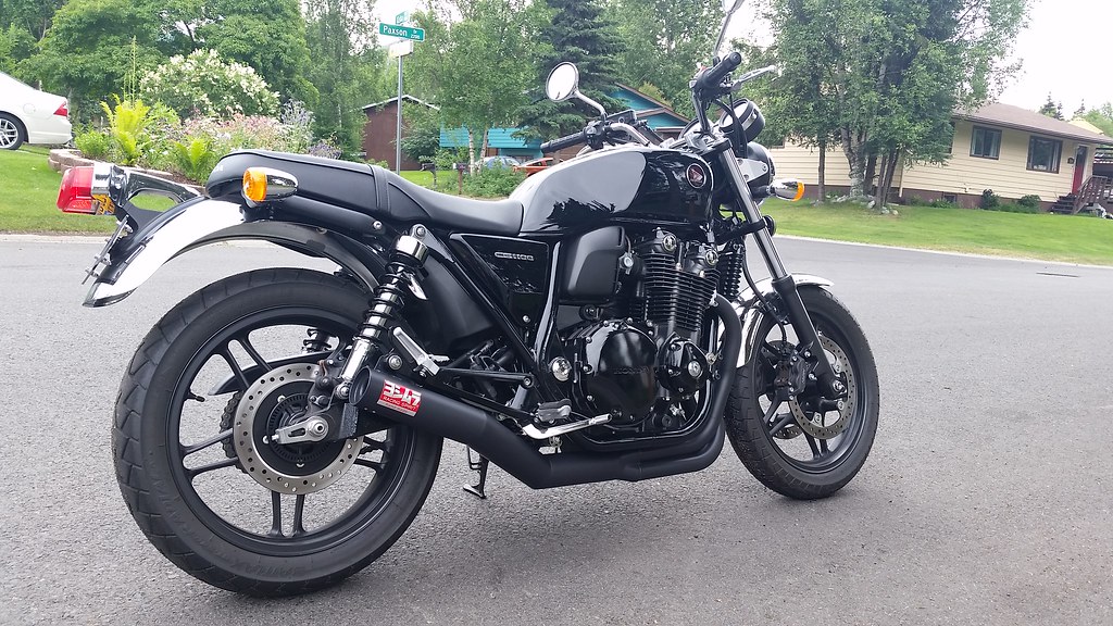

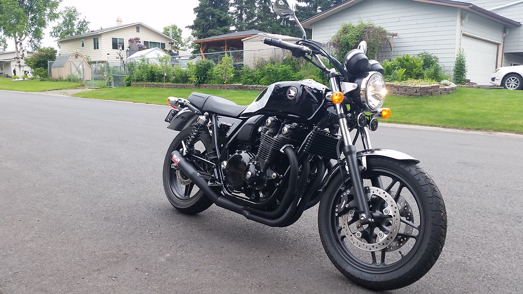

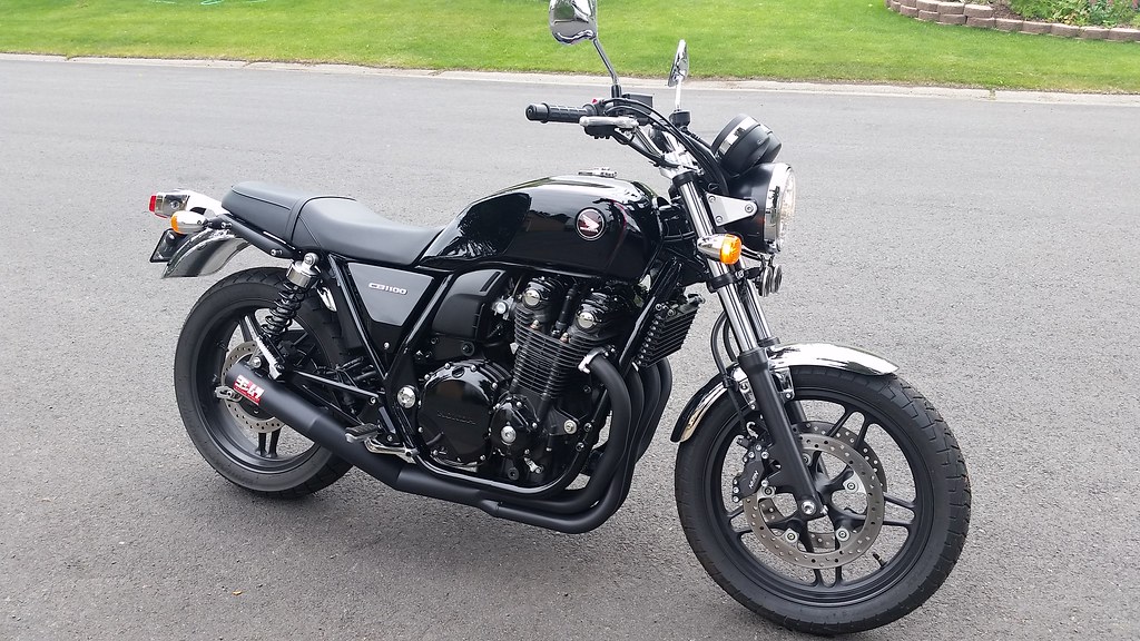

I personally don't have any experience with the moriwaki system but do have the yoshi full stainless black system on my bike I went with the yoshi system after doing alot of research on style,sound and weight I bought my exhaust with my bike brand new but did the 600 mile break in before install I love the fact that the system eliminated the cat but uses the factory air fuel sensor. having the same sound dB rating as the moriwaki my yoshi sounds perfect not loud at all but you can finally hear the engine revs. After removing my factory exhaust and opting not to reinstall the center stand I was able to shed a total of 17 pounds and get the perfect style look for the bike. As for oil changes it does not have to come off to remove the filter it has just enough clearance. The only downside I would say about getting the black exhaust is that inevitably you will get some small blemishes and chips in the finish from the front tire as to where the polished systems can be re shined back up https:
https://flic.kr/p/vgggZq
https://flic.kr/p/ujWEbx
https://flic.kr/p/vh6Rhk
