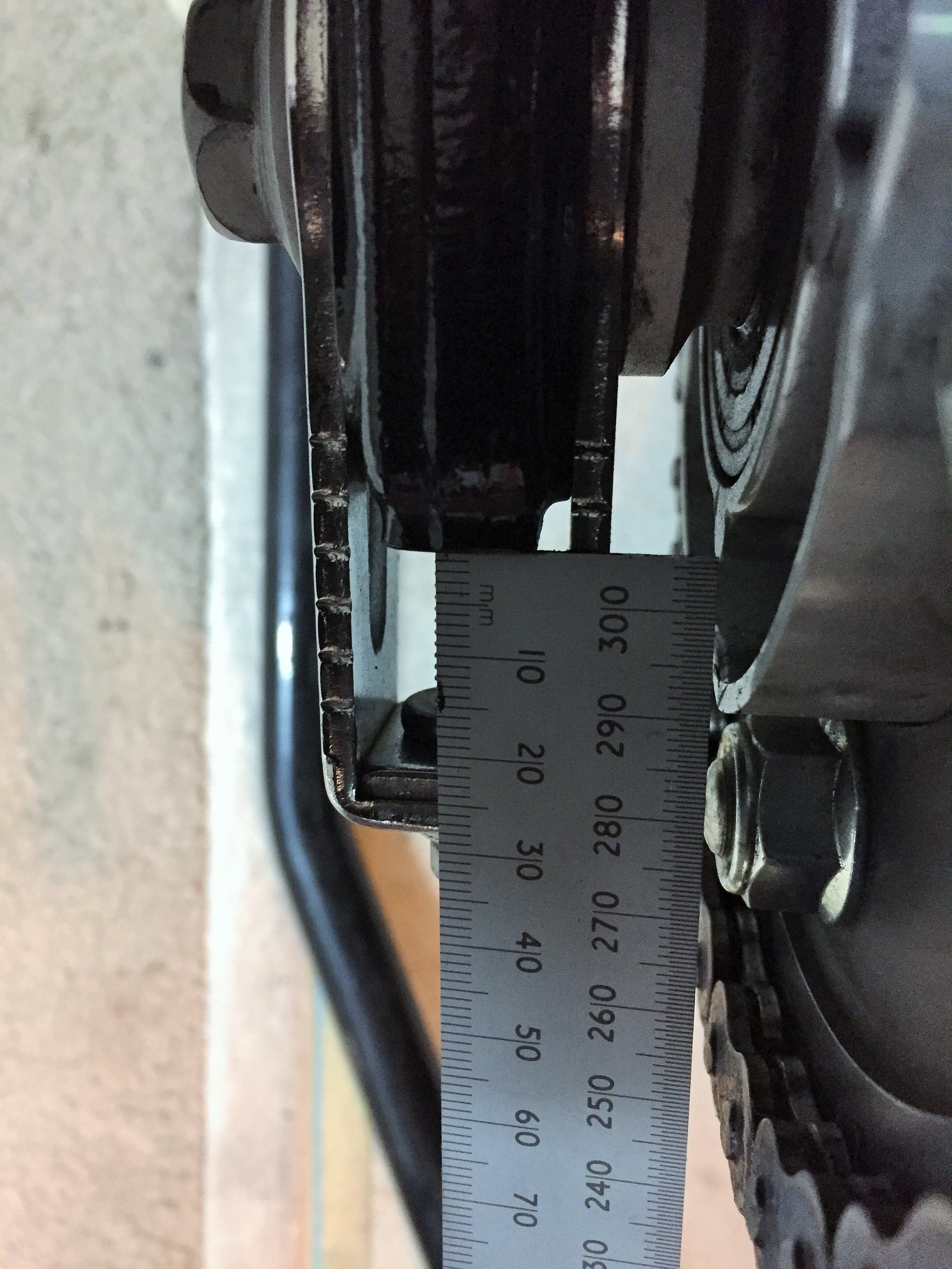

Just by measuring the axle position in the swing arm.
[Image: 331bbb2db542f7b7536ff2c1ffd91821.jpg]
I checked the accuracy of the adjuster blocks when I swapped out the mags for the wire wheels. Fitted the mags back on on the bike with no tyres and used a couple of long straight edges to compare rear wheel alignment to that of the front wheel. Turns out the markings on the adjusters are pretty good but I find them more difficult to read than my trusty steel rule. In this photo you can see the measurement is set to 28mm which is then easily compared to the other side.
