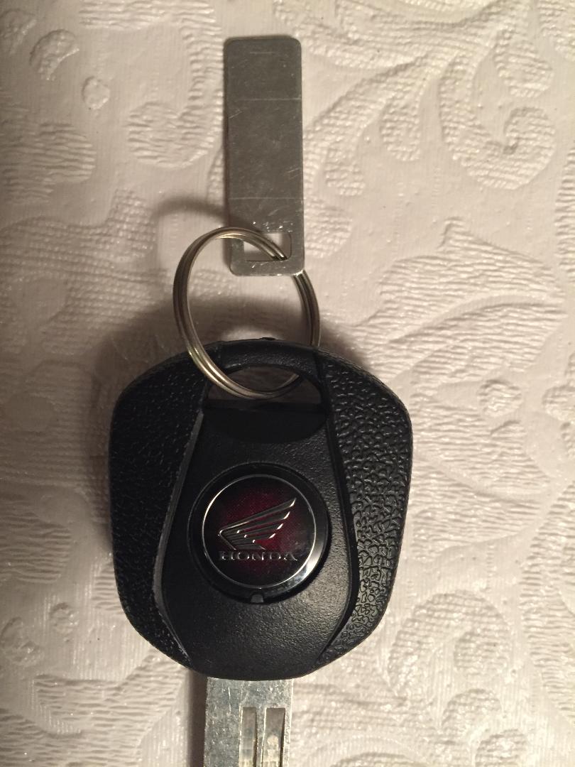

Also, if you have an OEM cut key + blank and if you will be in Toronto, Ontario area, I may cut your key at no charge, by duplication only, and if we still have this machine. We used to have the equipment to cut car keys by: duplication, key code(tag) and laser, but due to low demand, we got rid of the laser unit.
Your bike is 2017 model, and not so sure if key blade is a laser type (engraved) or regular (hacksaw).
If you need any further assistance, just update this post with your request and key type, picture would be perfect but not a must.
Meantime, I will check what is available as far as mechanical key cutting is concerned. Stay ahead of this game, so we in Canada might be able to provide some solutions while you enjoy your holidays.
Also, you may send your request to Honda Germany head office-motorcycle, backed by your 17 digit VIN, and they must be able to provide key tag. To be honest with you, your dealer FAILED you big time by not providing key tag number(code)upon delivery.
Let me know
[Image: 087eef56ffc877367f801f93fc89cb86.jpg]
Non chip, regular key with tag
