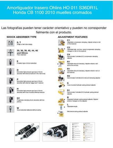

Well ..
My decision; is :
1.- change oil front suspension .. to 15W
2.- rear ; change to ohlins HO 011 S36 DRL1 ; silver Ánd spring at my weight; 125 kg add my wife ... (64 kg) - anything ...
I think that is a better solution that actual suspension ..
[Image: c516585d264f79957e6ae8d46110f9c3.jpg]

good; front suspension oil changed; which ... oil was missing !!!! ; We do not know if the previous owner changed it badly; or from the factory it came like this ... I have put thickness 15W instead of 10W ... (weight 125 kg and 1.90 m) and reserved the rear Stx36 ohlins and the possibility of raising 0.9 mm in height; with springs for my weight (chrome silver color) .. € 900 placed. With this and change of wheels to Metzeler Z8 roadtec interact; I already have this machine up to date ... with 18-inch wheels ... I think it is a great great improvement.
