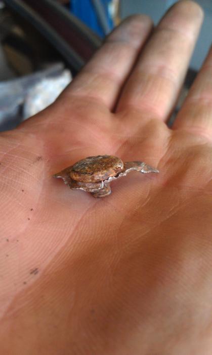

So as I finally got the last piece for Joe to pour the fuel and crank it up, the excitement lasted fir about 30 seconds when the fuel start pouring out from the bottom of the tank, i took me a while to disconnect that nasty fuel pump jack, but that time a full gallon poured out. When I finally managed to turn the tank around to have a look at what the heck was happening, I found that the paint guys overtightened the fuel pump screws and one of the bolts cracked. They just left it there still attached so as soon as I twisted it off the bolt stayed in my hand.
Now these bolts are welded to the ring that holds them, does anyone have any suggestion on how to fix this, because at this point I'm a bit clueless.

I’m sorry to hear this! My fuel pump stopped working due to fine sediment that was in the tank. When I pulled the gas tank off and flipped it over, I found that two of the six mounting studs were completely wrung off. The remaining mounting nuts were so tight on the studs that I’m surprised they didn’t shear when I took them off. I drilled the broken studs out and replaced them with 6mm bolts of the same length. I had to cut small slots in the retainer ring once I punched out the broken studs and bend the outside edges up slightly to accommodate the replacement of the studs. Once the bolts were inserted and the tabs bent back into place, I used some JB Weld to finish up. I ended up replacing the fuel pump assembly then with a new gasket and retainer, put things back together. 9 lb/ft on the nuts! I didn’t have a clue about what I was doing…save a bit of common sense. I want to encourage you to tackle your issue but try not to get in a hurry. A repair beats laying out all that cash for a new tank. I must say that my first thought was to replace my tank. I’m glad that I didn’t and I’ve had no further issue!

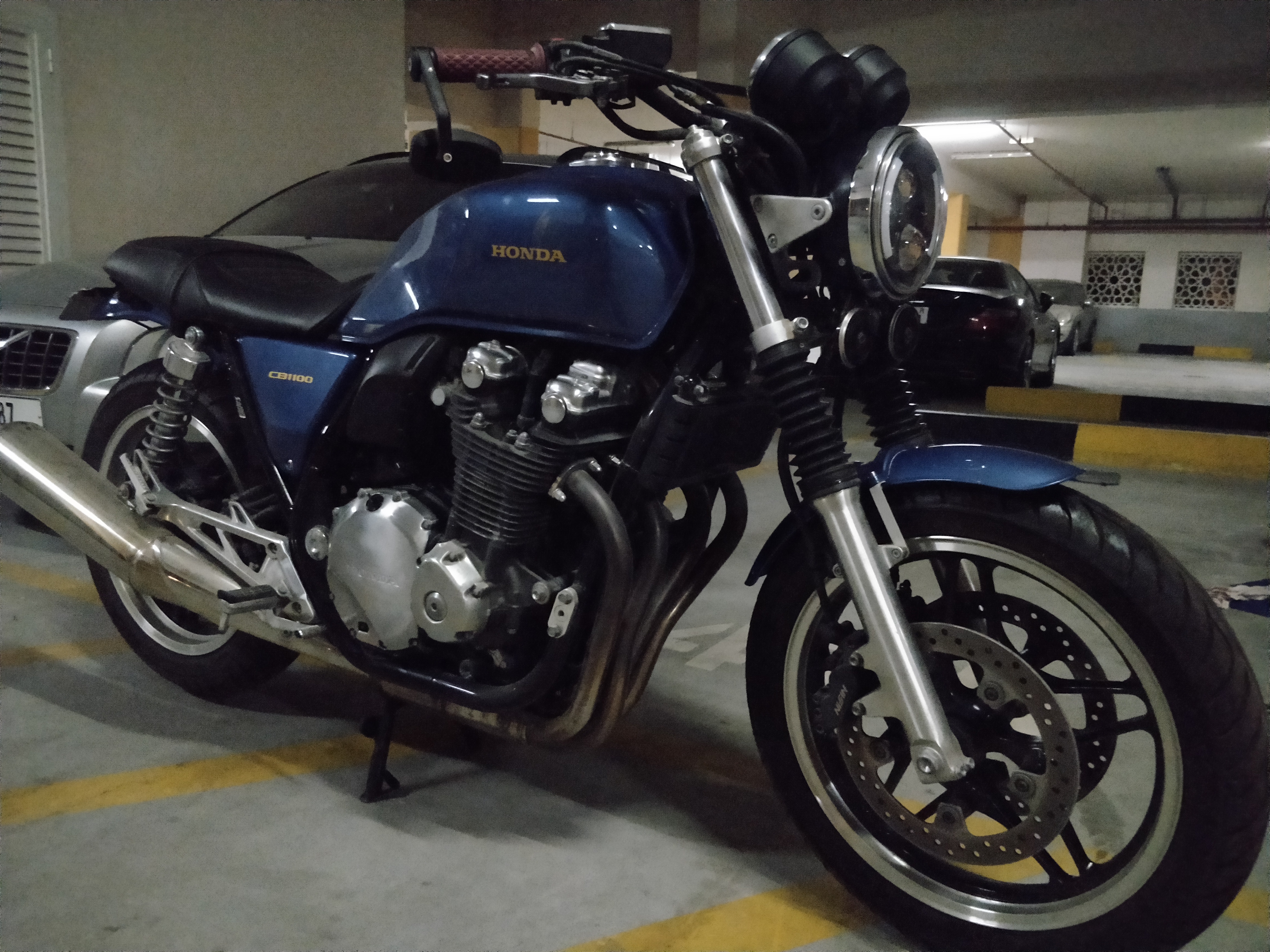

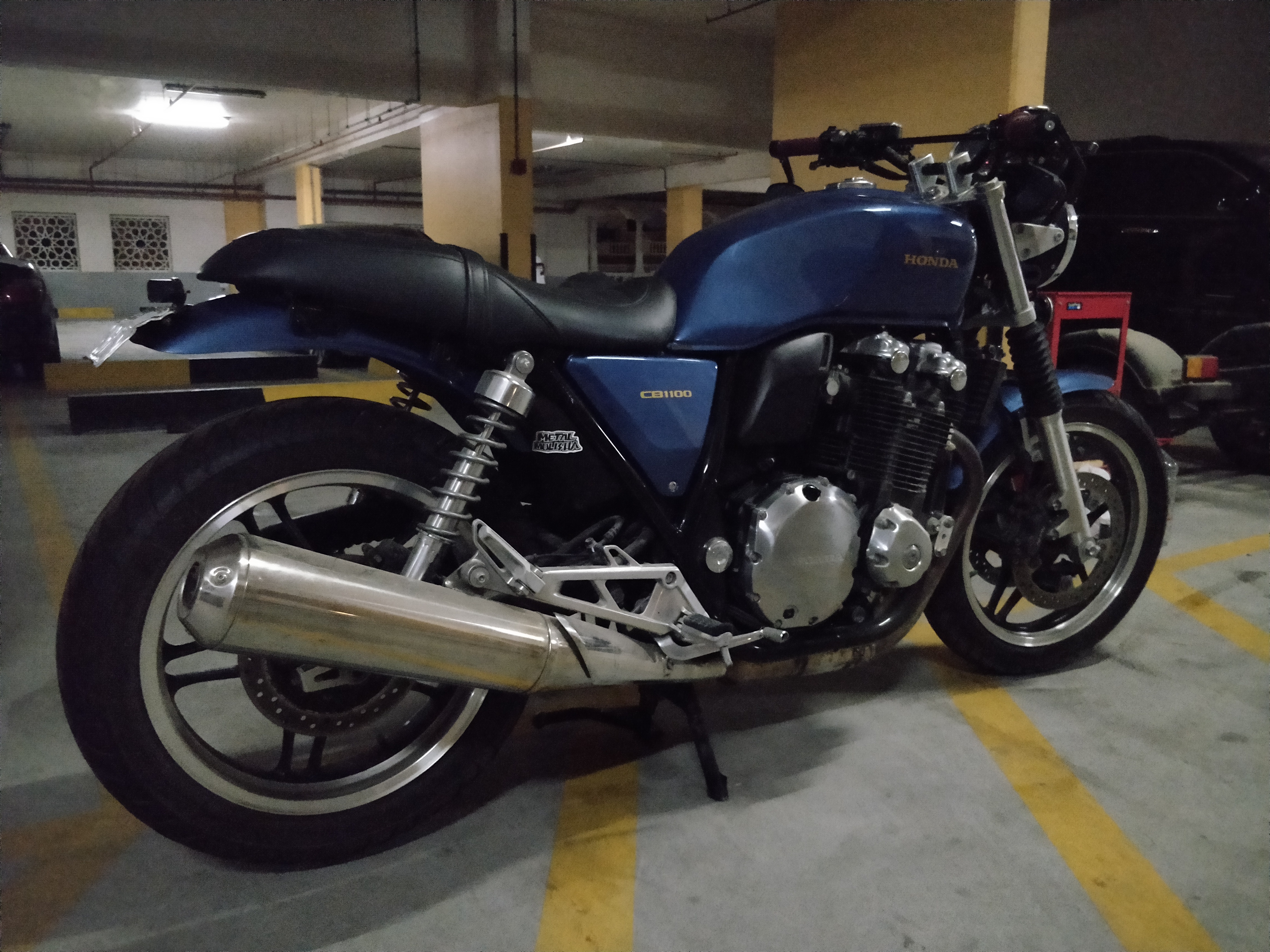

Happiness short-lived, looking for suggestions - tod.branko_imp - 07-09-2021
Thank you all for the suggestions. My mechanical skills are decent but machining and welding skills are practically none and I don't have access to a welder. I have made a formal complaint with the body shop, they've asked me to drop the tank off, they will either fix it or get me a new tank if that fails. It's unfortunate, but I guess these things happen, I was very eager to get on the bike and go ride, it has been too long. At least I'm happy with the new look, still contemplating the proper exhaust and grab rails
