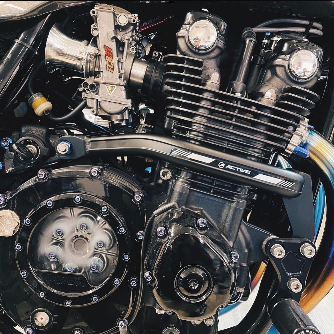

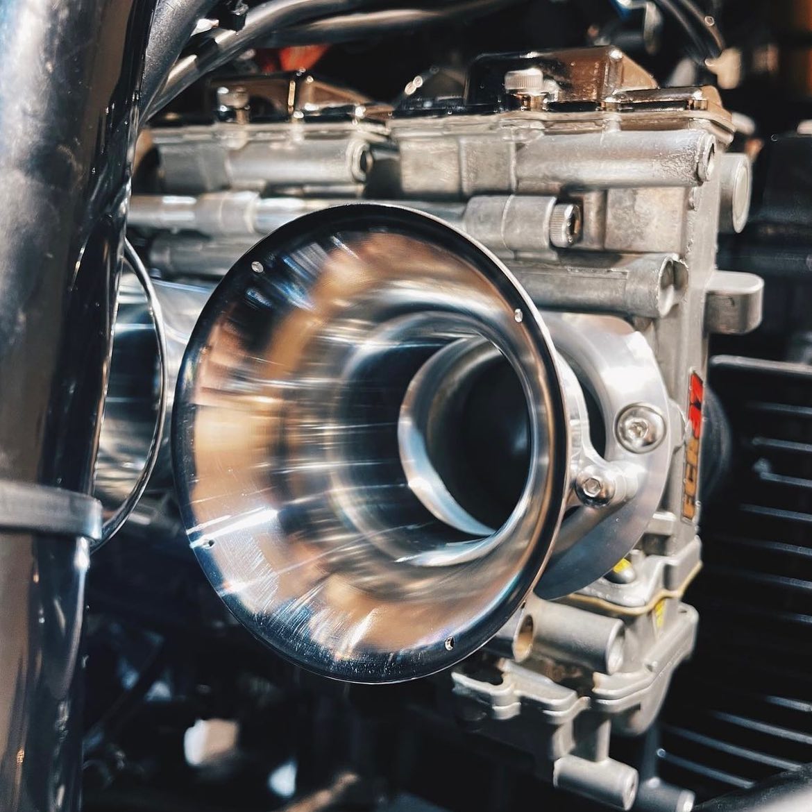

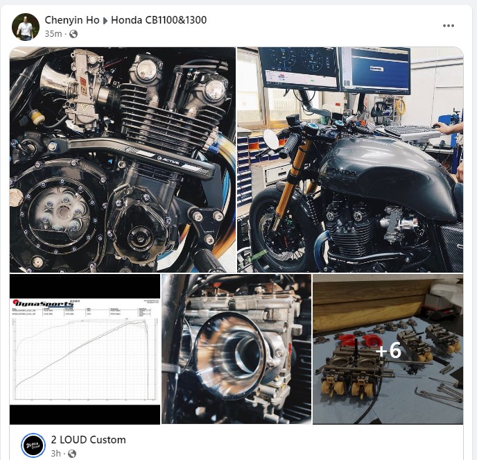

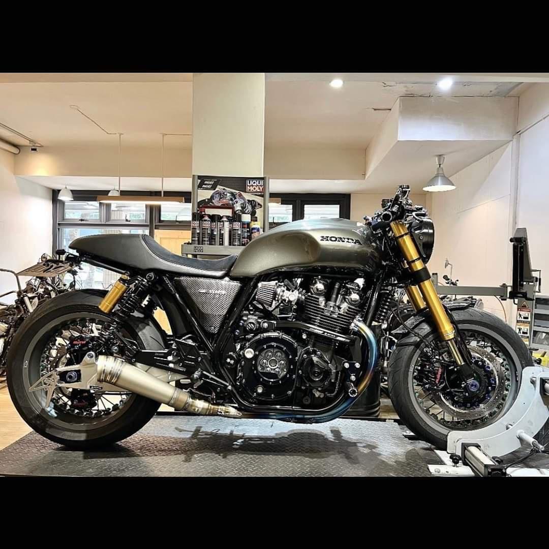

found this on facebook a carb'd cb check this out power dubs this must be the limit of the head / small valves 122hp

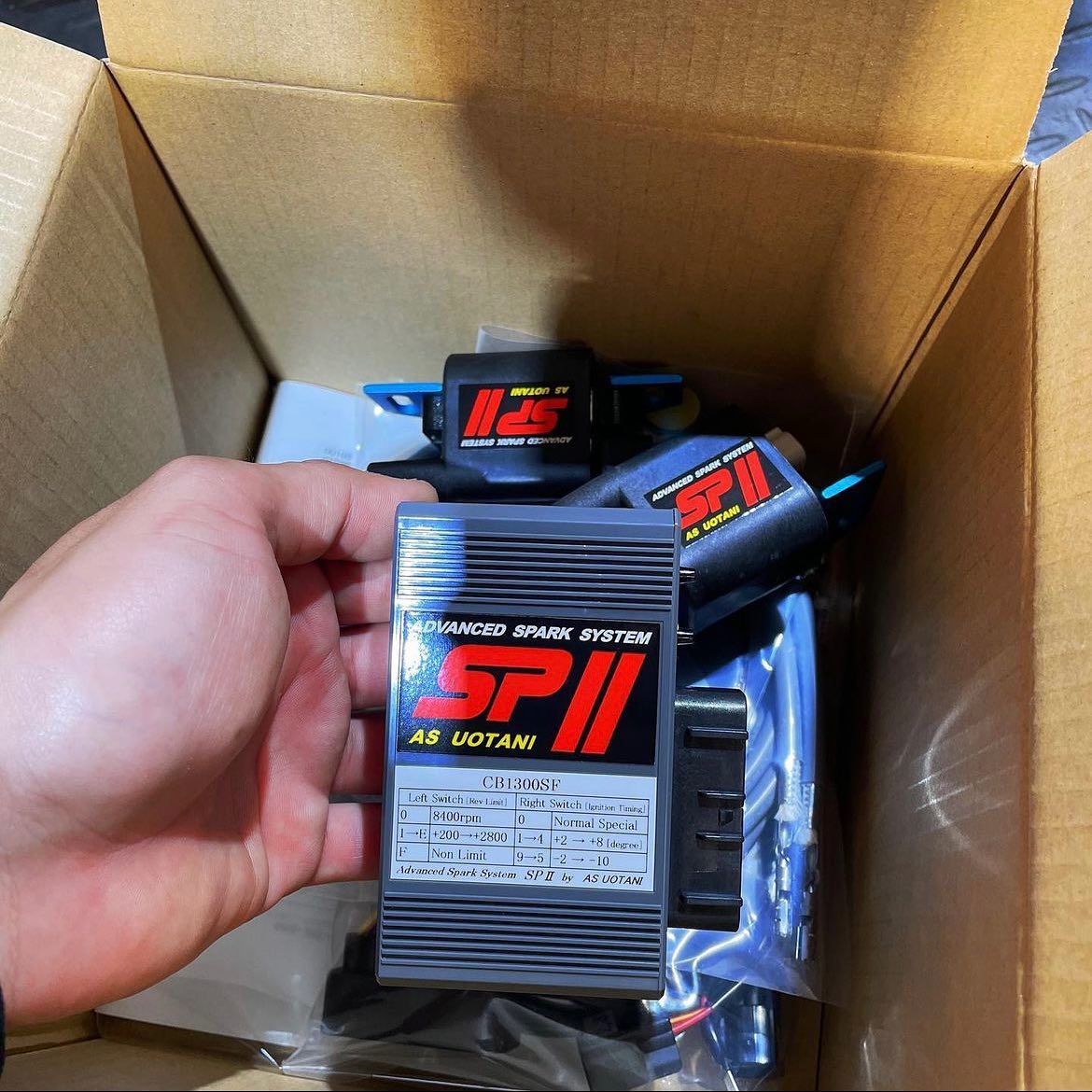

這次異種移植了點火模組和化油器 經過馬力機精心調整後
我們看到了這顆引擎的潛力

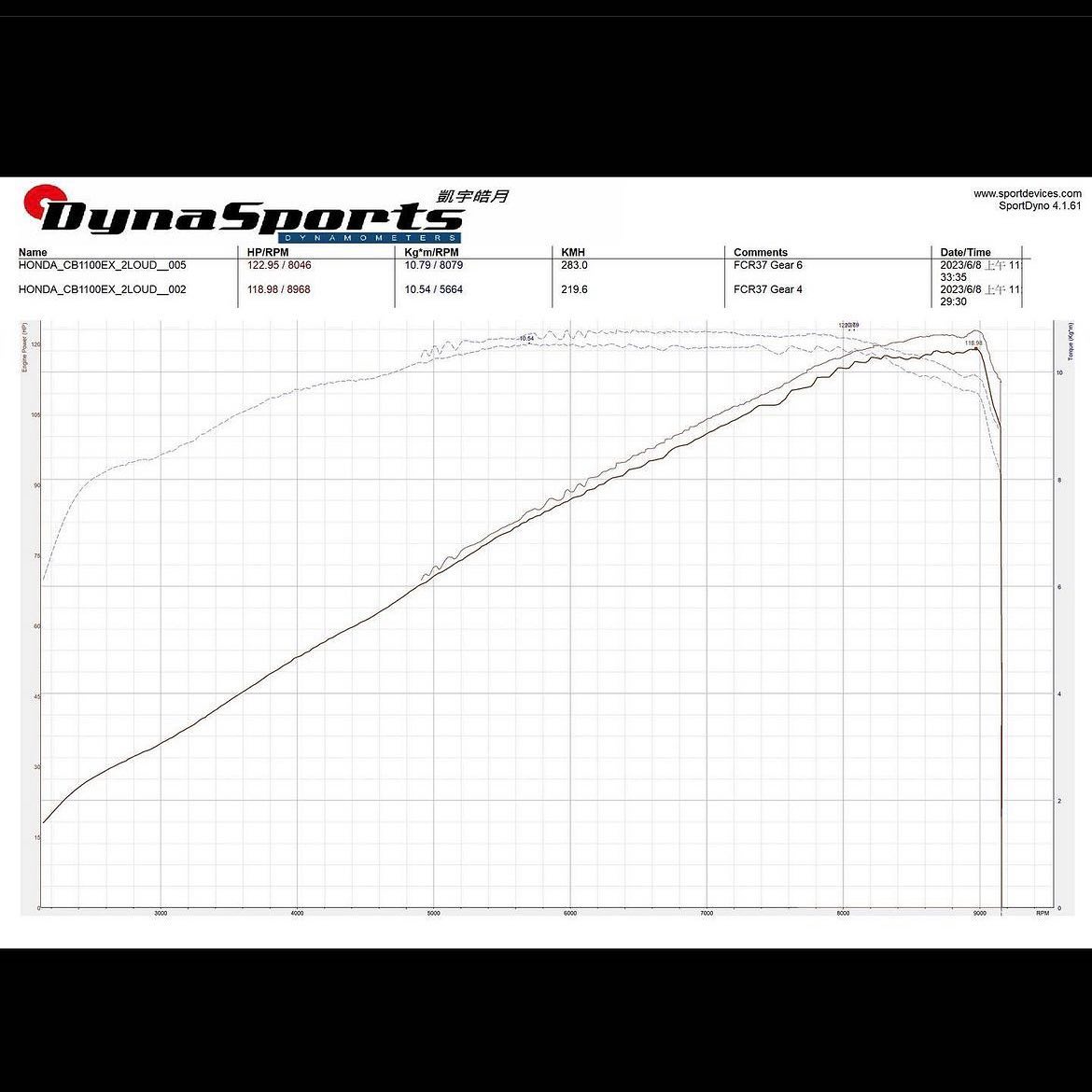

120HP馬力和那持續10.5Kgm 的扭力平原

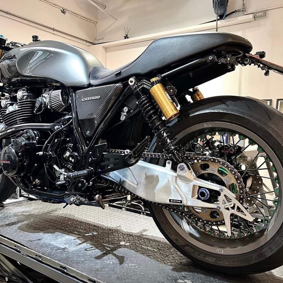

CB1100 has always been a key player in vintage cars, 4-cylinder sound wave, retro look, air cold last generation, still the outline of the CB family from the 90s
But CB1100 has a lot of restrictions for the modification market. Electronic systems need to keep a signal back from each part in order not to interfere with the original computer.
Even if the original is done, the electronic speed limit will limit it to a speed that feels like the engine still has a lot of power
I still feel like it's not good enough after I get the speed limit.
Limited to the mini size of throttle
CB1100 true performance has never been solved
The ignition module and carburetor have been carefully adjusted by the horsepower
We see the potential of this engine
120HP horsepower and that torque plain that lasts 10.5Kgm
Same as those old big four-cylinder seniors
The fear of the powerful push from the road test is back again
Thanks for the trust of the owner, this strange project can still come to us to play
If you have any crazier ideas, please contact us to discuss them (?).

That lump looks like a piece of performance art, 1973cb750.
RE: Carbureted cb !!!! - 1973cb750 - 06-10-2023
(06-10-2023, 11:34 PM)GoldOxide_imp Wrote: That lump looks like a piece of performance art, 1973cb750.
most definitely is Au2O3

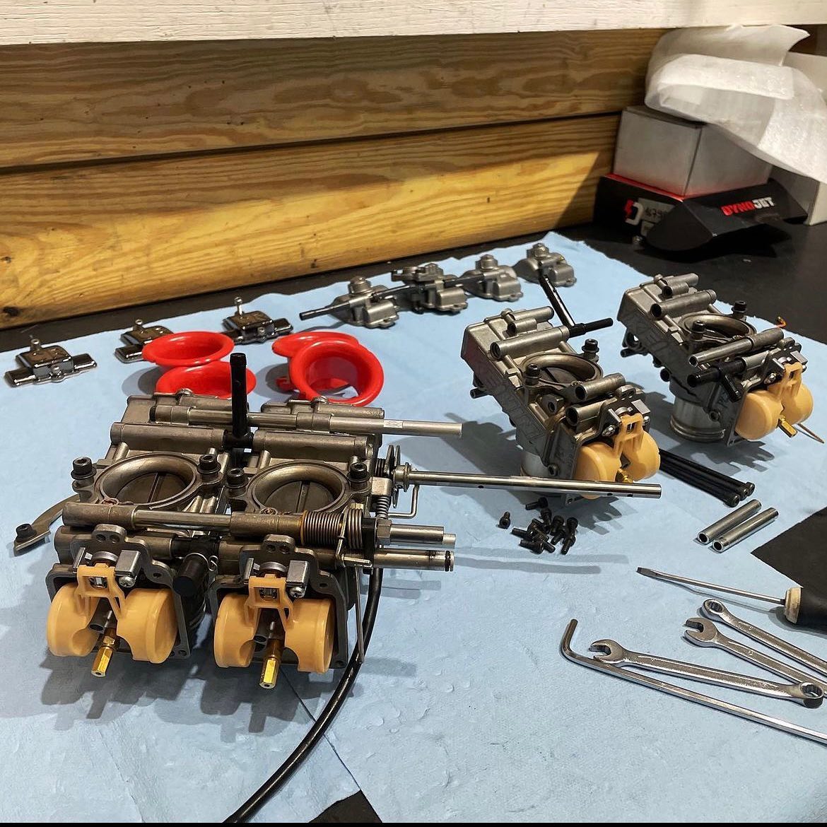

i love engine masters my thoughts, the throttle bodys are definitely a restriction

I'd like to see that on a Dynojet- scaled correctly (5252 crossover) and SAE correction factor....just for apples to apples of what common runs are.

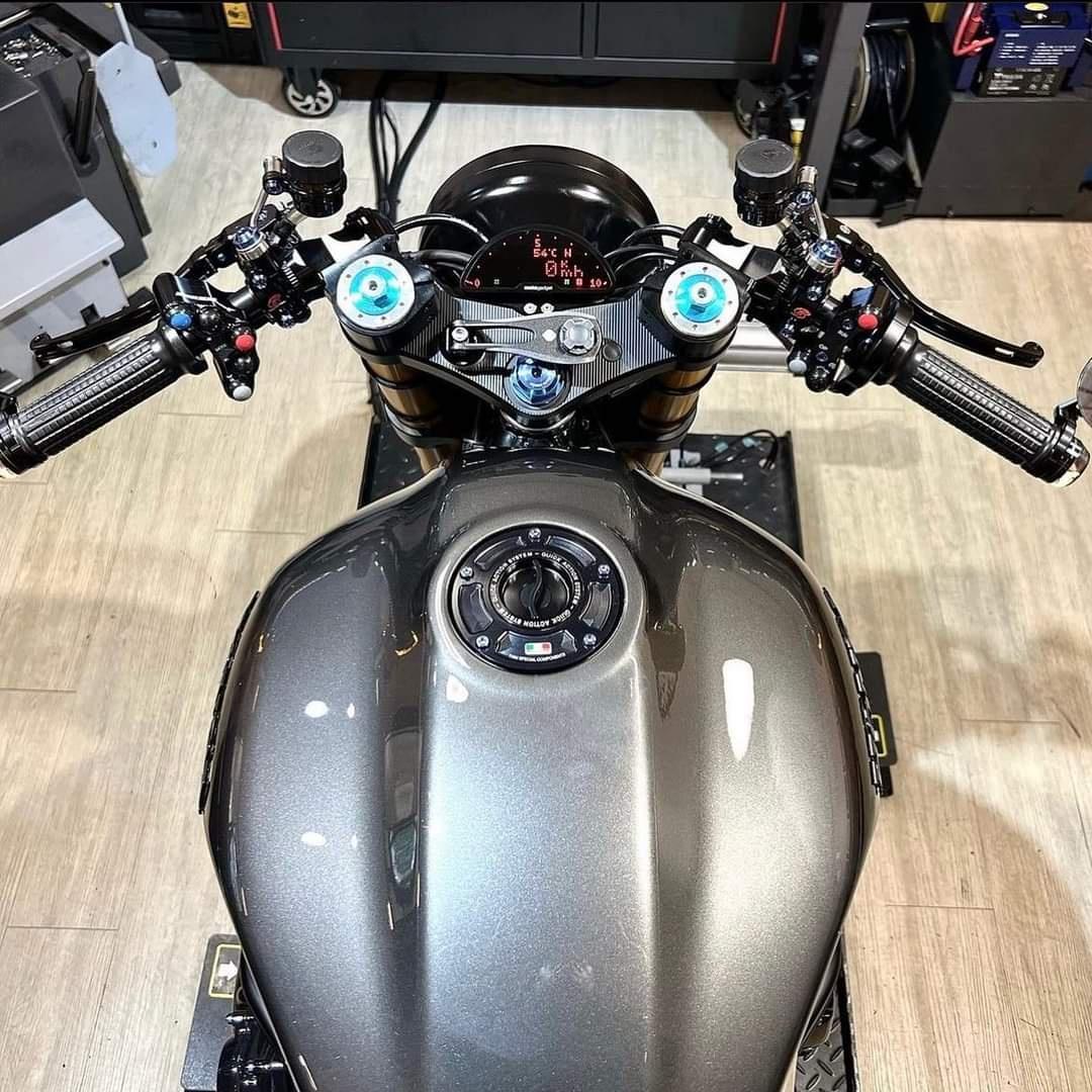

Anybody notice his ign switch above the clutch?
RE: Carbureted cb !!!! - Nachodaddy - 06-11-2023
(06-11-2023, 05:03 AM)PowerDubs_imp Wrote: I'd like to see that on a Dynojet- scaled correctly (5252 crossover) and SAE correction factor....just for apples to apples of what common runs are.
Thank for pointing that out, Dubs. There is so much to see, MAN, what a BIKE! Beautiful workmanship. Not my cup of tea, but so beautiful in every detail.
yeah kinda cool

Such a cool setup. That's the kind of power that this bike should have came with from the factory IMO. And what I would expect from an 1100cc inline 4.
Love how the power curve isn't a curve and its just a steady incline the entire run, nice and smooth.
