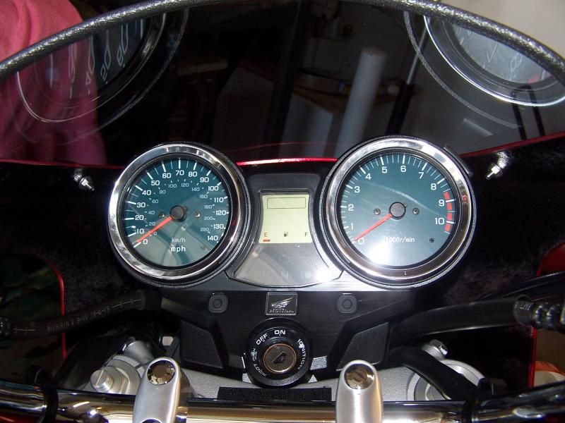

Once installed, out for a ride. Major disappointment. The Road Comet wobbles in the wind - BIG TIME - at any speed. Those of you that have one already know this. Back to the auto parts store and purchased black car/truck side molding. The molding is 1" wide by 3/8" thick with two strips of 3M double stick tape on the back. Cut two pieces, each 1" long. Positioned the molding between the gauges and the ridge of the fairing. . . 10 o'clock position on the speedo, 2 o'clock position on the tach. Did another test ride. The Road Comet doesn't move, even at 90 MPH. With the inside of the fairing painted black, you don't even see these.

Southpaw - great info. Lots of folks on the forum have Road Comets, including me. Headlight bleed is bothersome at night. And the fairing does wobble. Your solution is easy, effective and inexpensive.

yep, wedging something between the gauges and the fairing gets rid of the shake, a few other members have recommended that too.

Southpaw's CB and Road Comet modifications:
[Image: ecec884d268873df7db465ca9f4514c2.jpg]
[Image: d03c0fff95987440a41b476ec944c2c4.jpg]
[Image: 9968ab9601761ed49c33f5946413140f.jpg]
Looks great!
