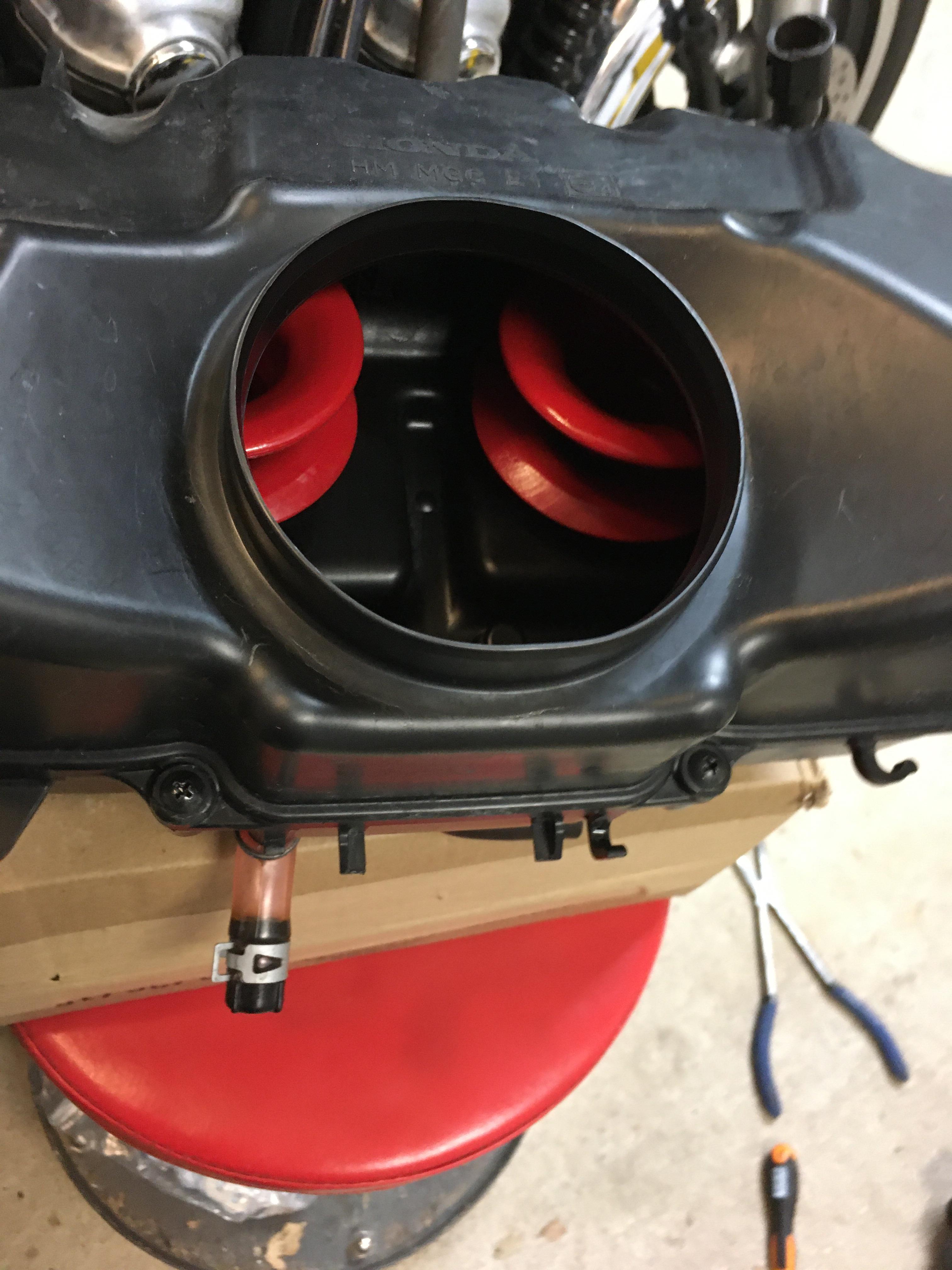

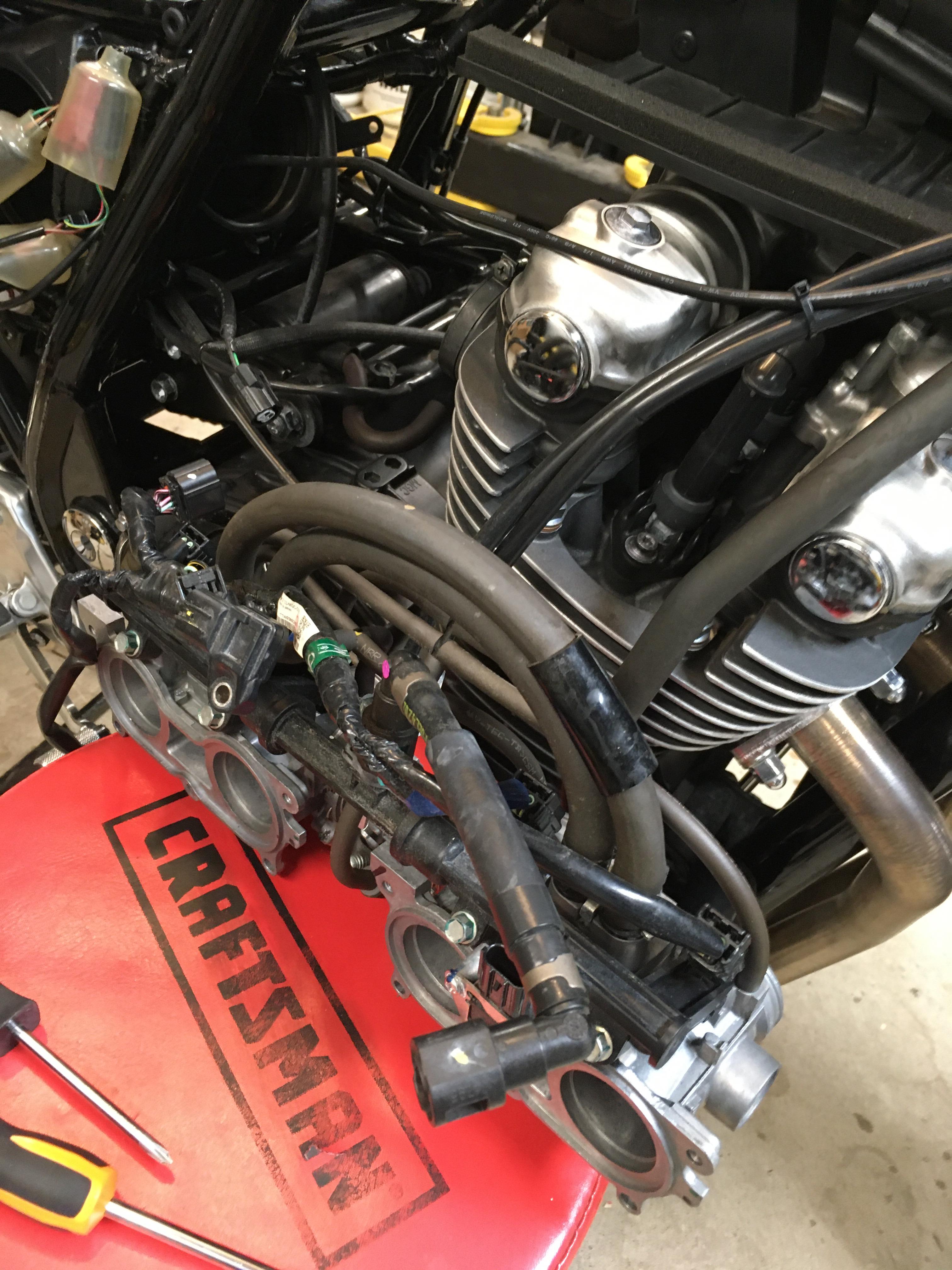

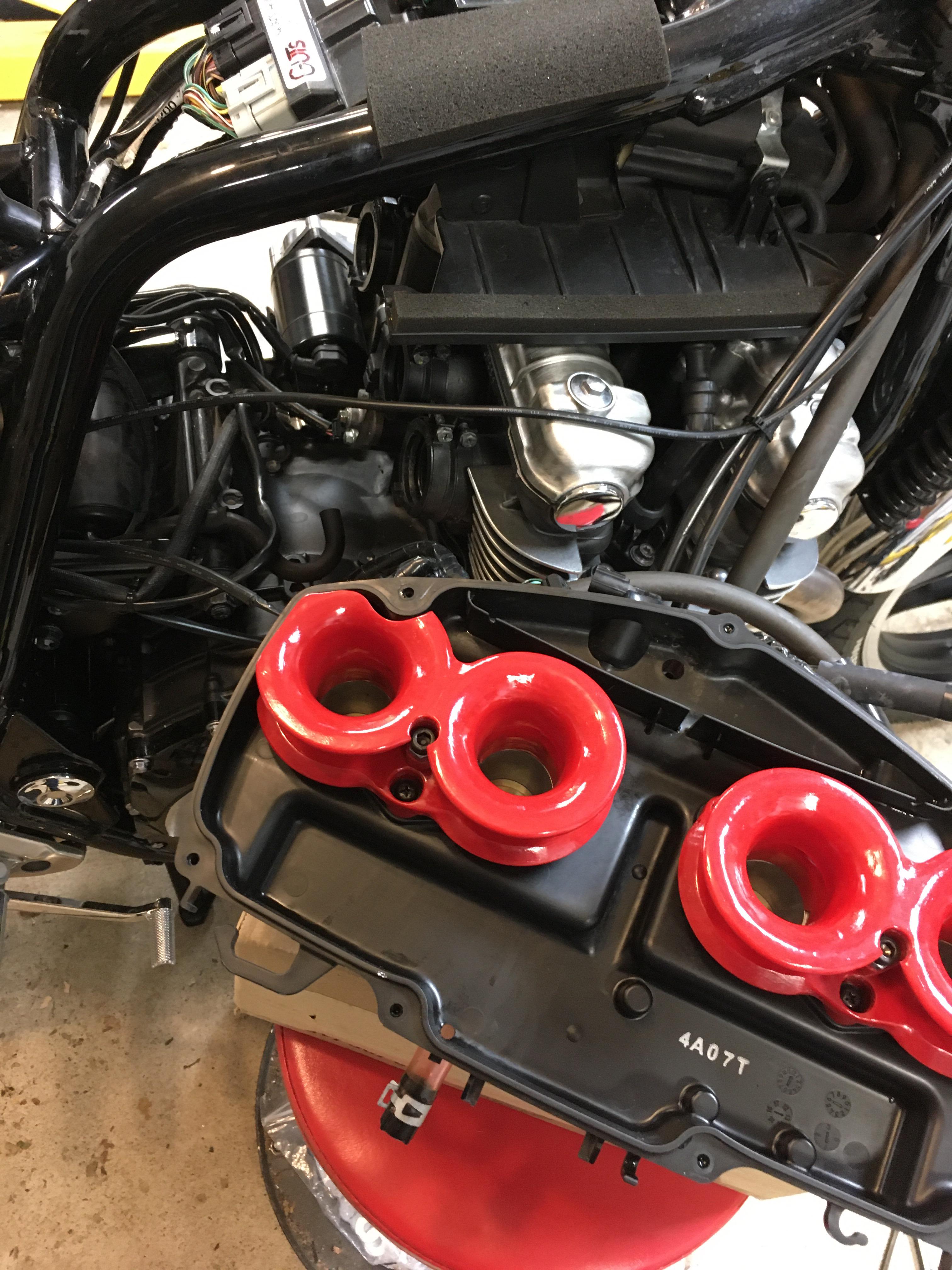

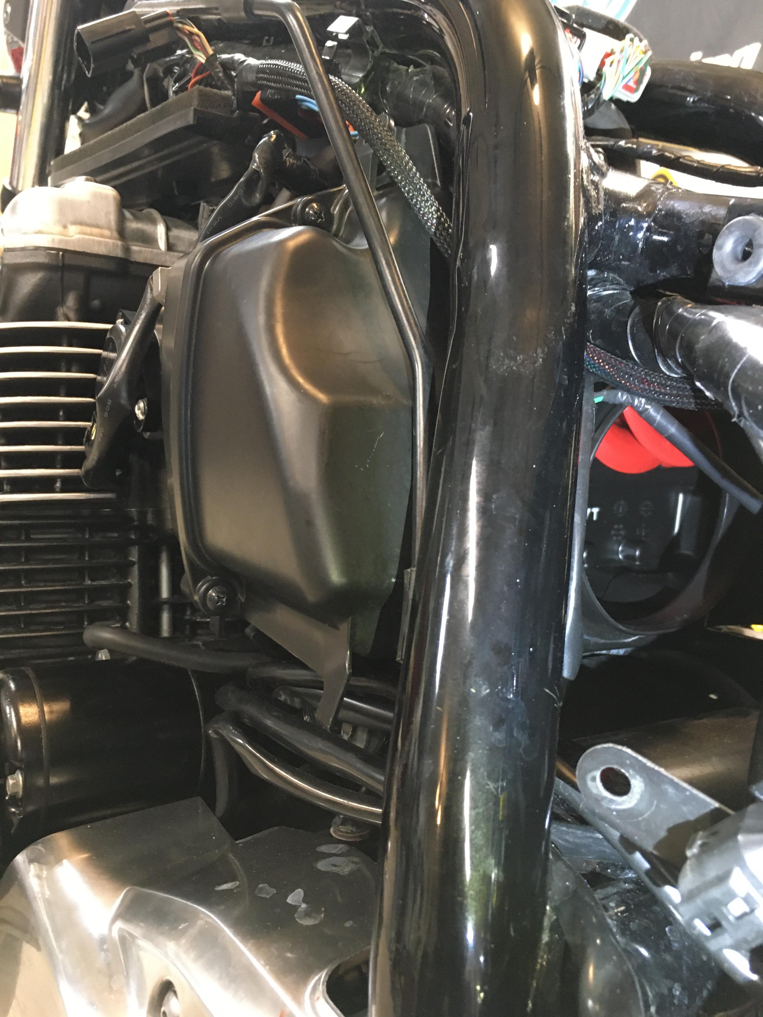

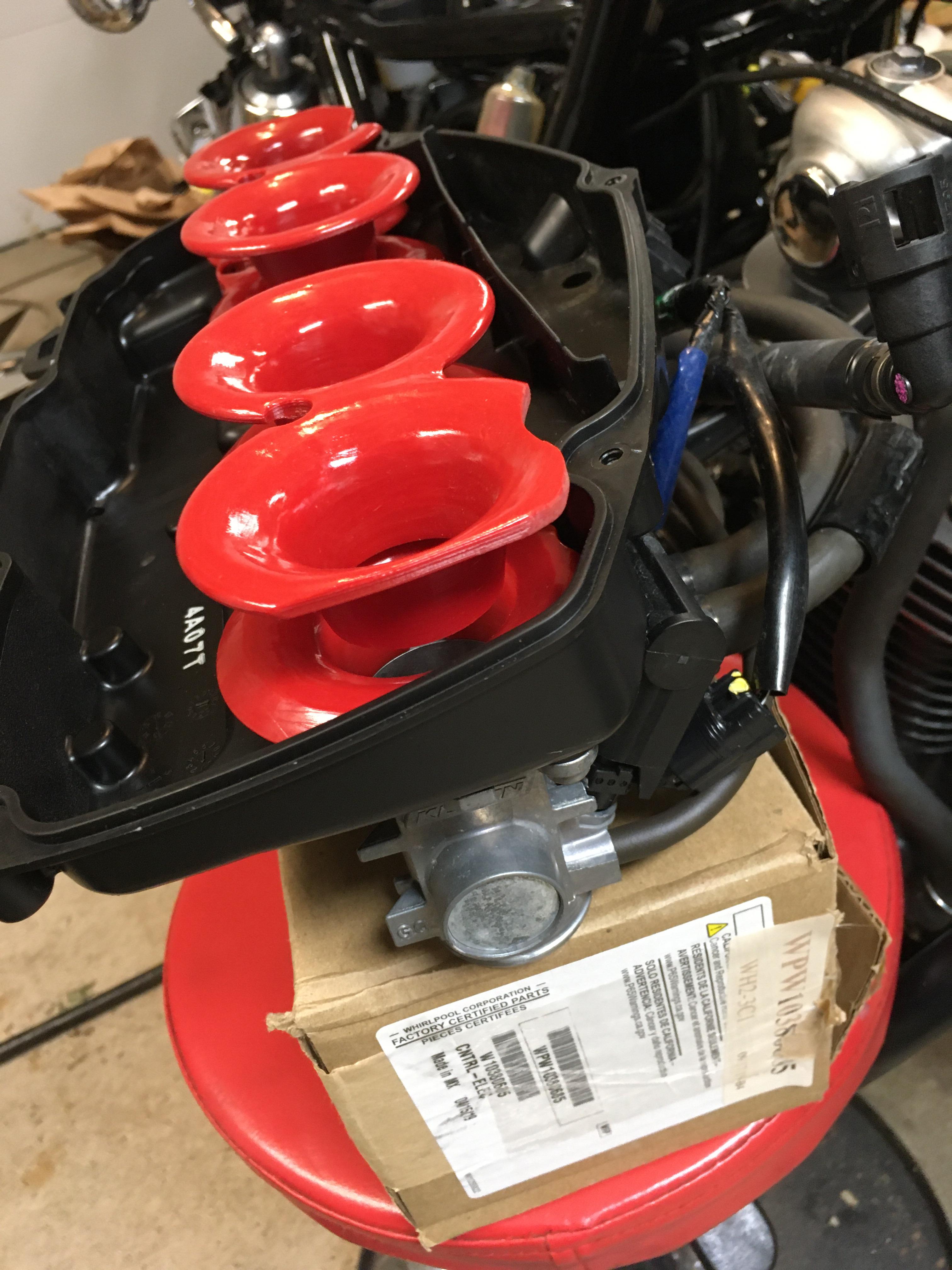

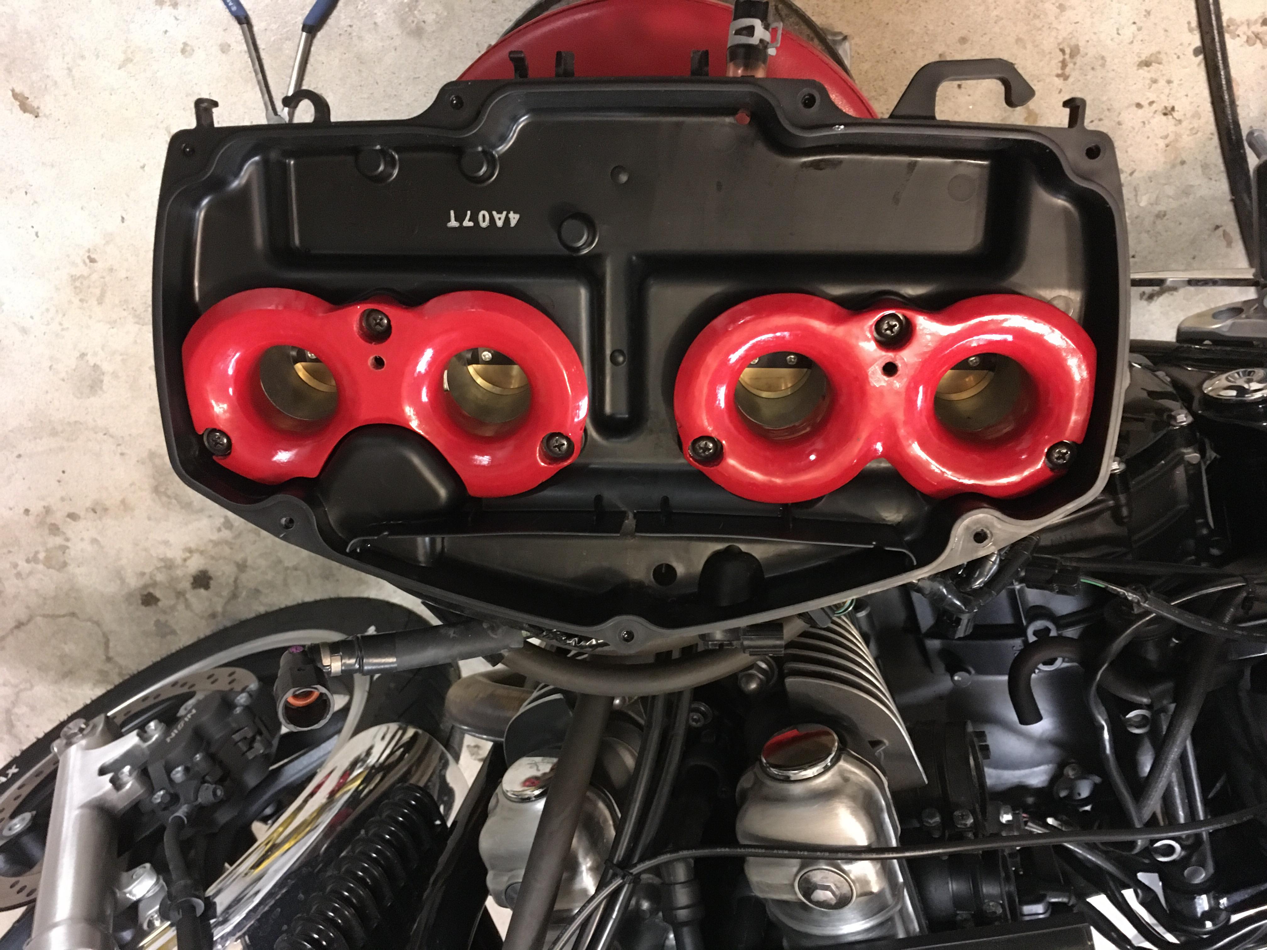

Because of the height of the 2nd stage- there isn’t enough room to just remove the back half of the airbox like when dremeling the stock stacks.
For these you need to remove the throttle body rack and assemble all the airbox parts together then slide it back in all at once.
So- they are now officially ‘installed’- I just need to hook up all the hoses and plugs.
