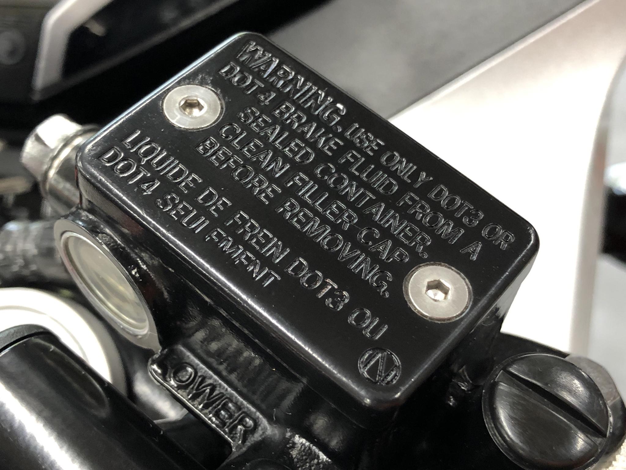

RE: Brake reservoir screw head issue - Stichill_imp - 04-21-2022
Stainless steel hex heads on my CBR250R with just a touch of copper anti-seize compound on the threads and under the heads. I sleep easy at night, knowing problem has been eliminated.

RE: Brake reservoir screw head issue - GoldOxide_imp - 04-21-2022
(04-21-2022, 10:46 AM)Stichill_imp Wrote: Stainless steel hex heads on my CBR250R with just a touch of copper anti-seize compound on the threads and under the heads. I sleep easy at night, knowing problem has been eliminated.
[Image: 129bb4c8d2c6bf69fe5ac268f6017e49.jpg]
Ahem Hank.
