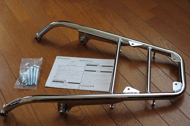

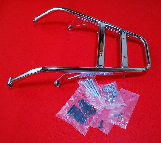

RE: '14 Honda Luggage Rack does not fit the '14 Deluxe - CB4ME_imp - 05-28-2014 2013 rear carrier ![]() 2014 rear carrier
RE: '14 Honda Luggage Rack does not fit the '14 Deluxe - newhemi_imp - 05-28-2014 Contacted the people at Samurider and they told me the '14 rack fits the '14 canadian model. RE: '14 Honda Luggage Rack does not fit the '14 Deluxe - Gumby 1100_imp - 05-28-2014 (05-28-2014, 07:44 AM)newhemi_imp Wrote: Contacted the people at Samurider and they told me the '14 rack fits the '14 canadian model. Let's hope so! But I would rather not have to ship a rack back to Japan if it doesn't fit the Canadian model. I just took the following measurements of the grab rail and mounting bolts, with the bike on the centre stand on a level surface. 1) Bolt Centre-to-Centre (Straight line between the bolt centres): 7-3/16" (182mm) 2) Angle of Grab Rail: approx. 15 Degree from horizontal 3) Vertical height difference between front and rear bolt: 1-7/8" (48mm) Can anyone with the 2014 Rear Carrier confirm if these are the same dimensions? Thanks in advance! '14 Honda Luggage Rack does not fit the '14 Deluxe - Elipten_imp - 05-28-2014 Ferret, NO CHROME COVERS! Guess you will just have to sell it to me at a loss. The shame of it. Sent from my iPad using Tapatalk RE: '14 Honda Luggage Rack does not fit the '14 Deluxe - the Ferret - 05-28-2014 (05-28-2014, 09:38 AM)Elipten_imp Wrote: Ferret, NO CHROME COVERS! Guess you will just have to sell it to me at a loss. The shame of it. EVER? man I would be bummed if that's true.
