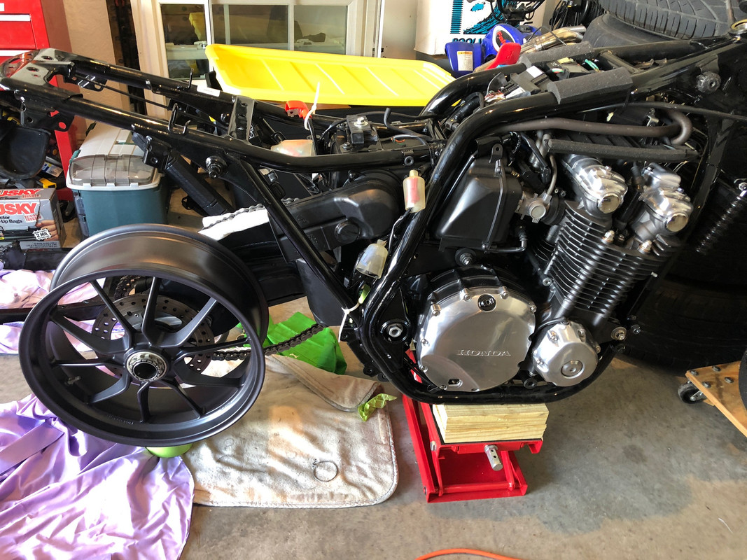

RE: CBR1000RR Front End? - Cafe Project_imp - 09-22-2018
Picture of the swingarm. Fits great minus the battery and fusebox.
[Image: 722757b008df79bf54ab8e2ae37068c1.jpg]
[Image: 0dde0898ff1b921ddcf349edb2b00740.jpg]
[Image: ac5ab62ffb63ba726d3f9c776e85baba.jpg]
(09-21-2018, 03:07 PM)pekingduck_imp Wrote: Can't wait to see pics. Do you need to press the stem off to put the dust seal under the lower bearing? Any chain interference with the 2" wider tire?
Take a look. It fits great.
[Image: 9dc806be3eaa3cb50d8f4a243967fdef.jpg]
RE: CBR1000RR Front End? - pekingduck - 09-22-2018
That's going to make for a seriously handsome bike!
