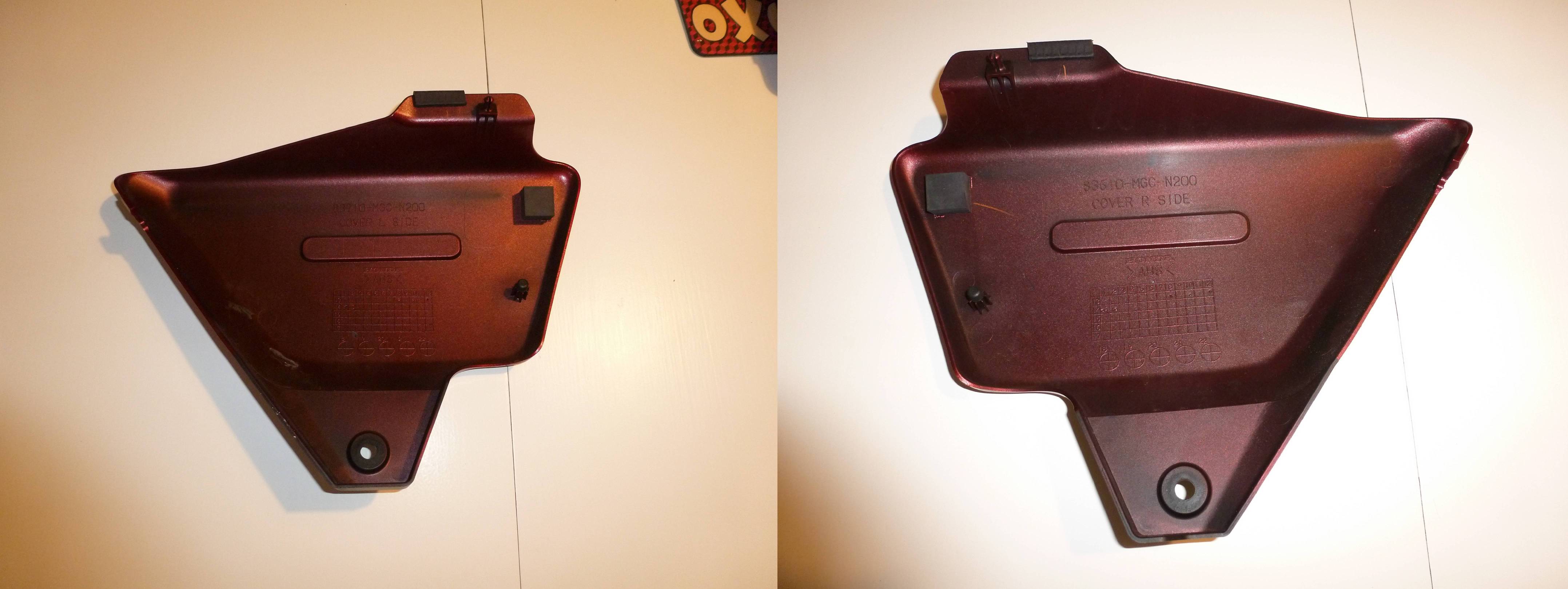

RE: Side Covers - YotaMan_imp - 02-22-2020
Alain said you got the pics uploaded Houtman?
I will also drop them here in-case any forum members want to review.
Backside of 2014 covers
[Image: 30f88743c3be06bbeda005625b8addb3.jpg]
Backside of 2017 covers
[Image: 40b73ac30f4fdd15464c39db3c9b7655.jpg]
RE: Side Covers - Houtman_imp - 02-22-2020
Thank you YotaMan for posting the back of the 2014 side covers on the Forum.
RE: Side Covers - 17-CB-002 - 02-23-2020
From the above 4 pictures, the only modification required are:
1. To grind out the two "buds/nipples" and
2. Glue/Bolt-on a metal strip to the front of the cover so that it guide and hold the cover front section into the original frame slot.
I hope that the lower screw aligns with the threaded hole on the frame.
See Samurider conversion of '17 aluminium cover into a '14 model year bike.
Et voila!
