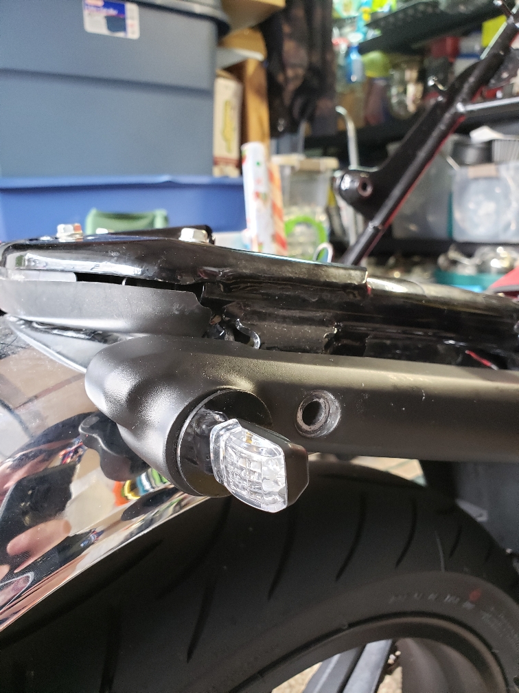

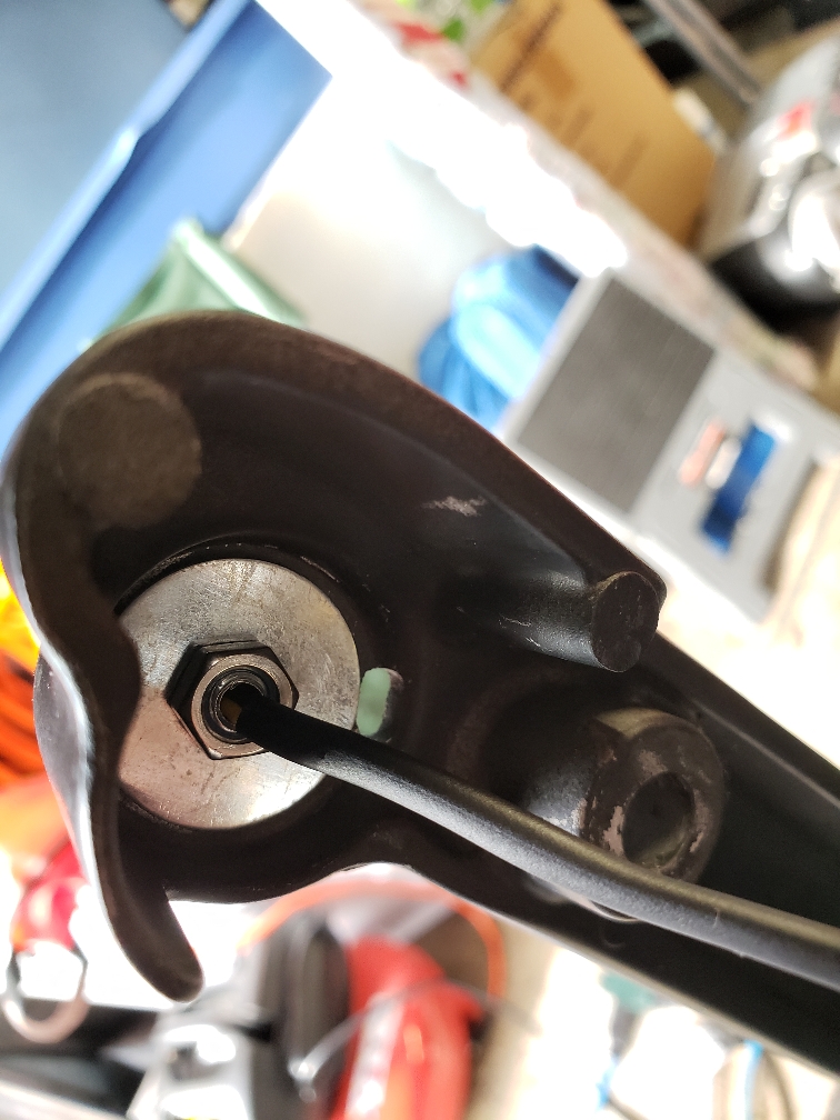

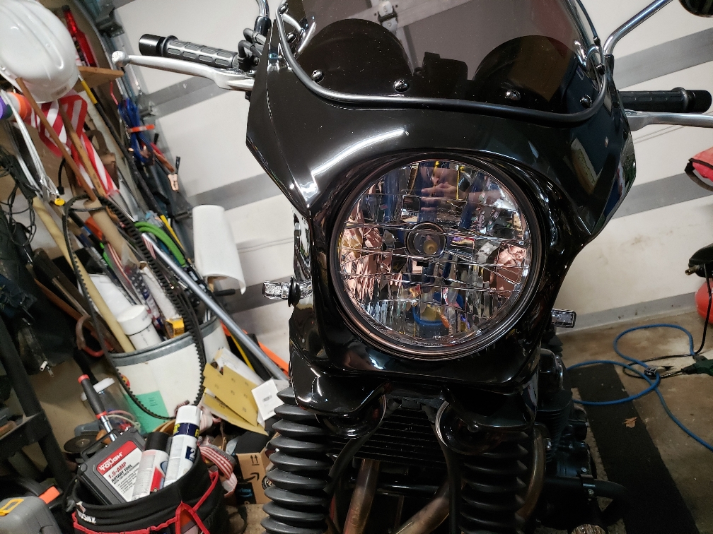

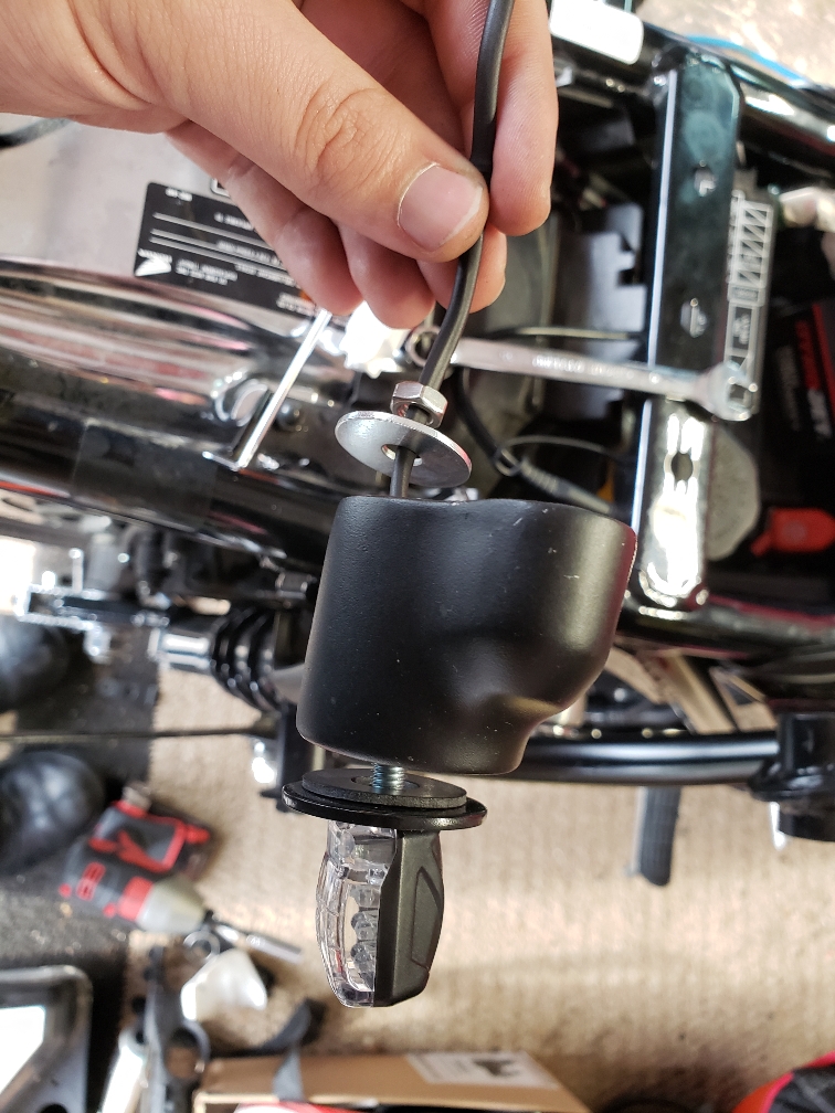

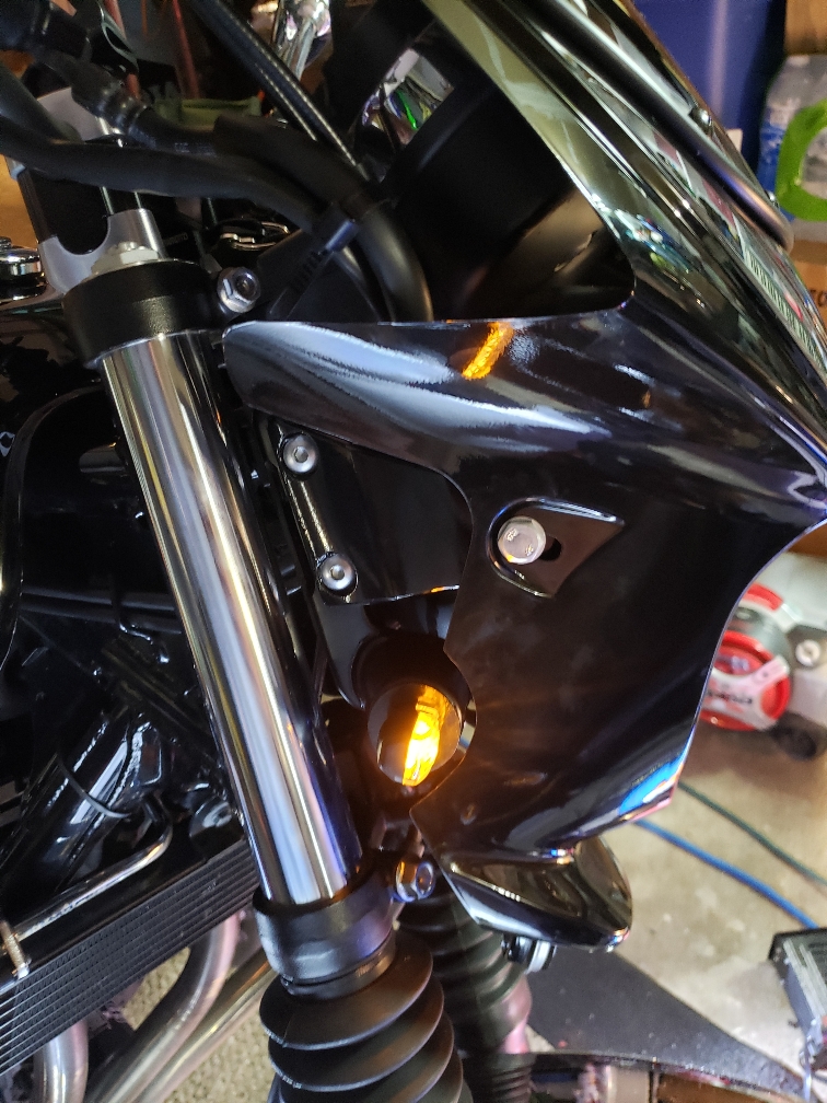

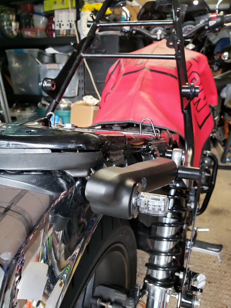

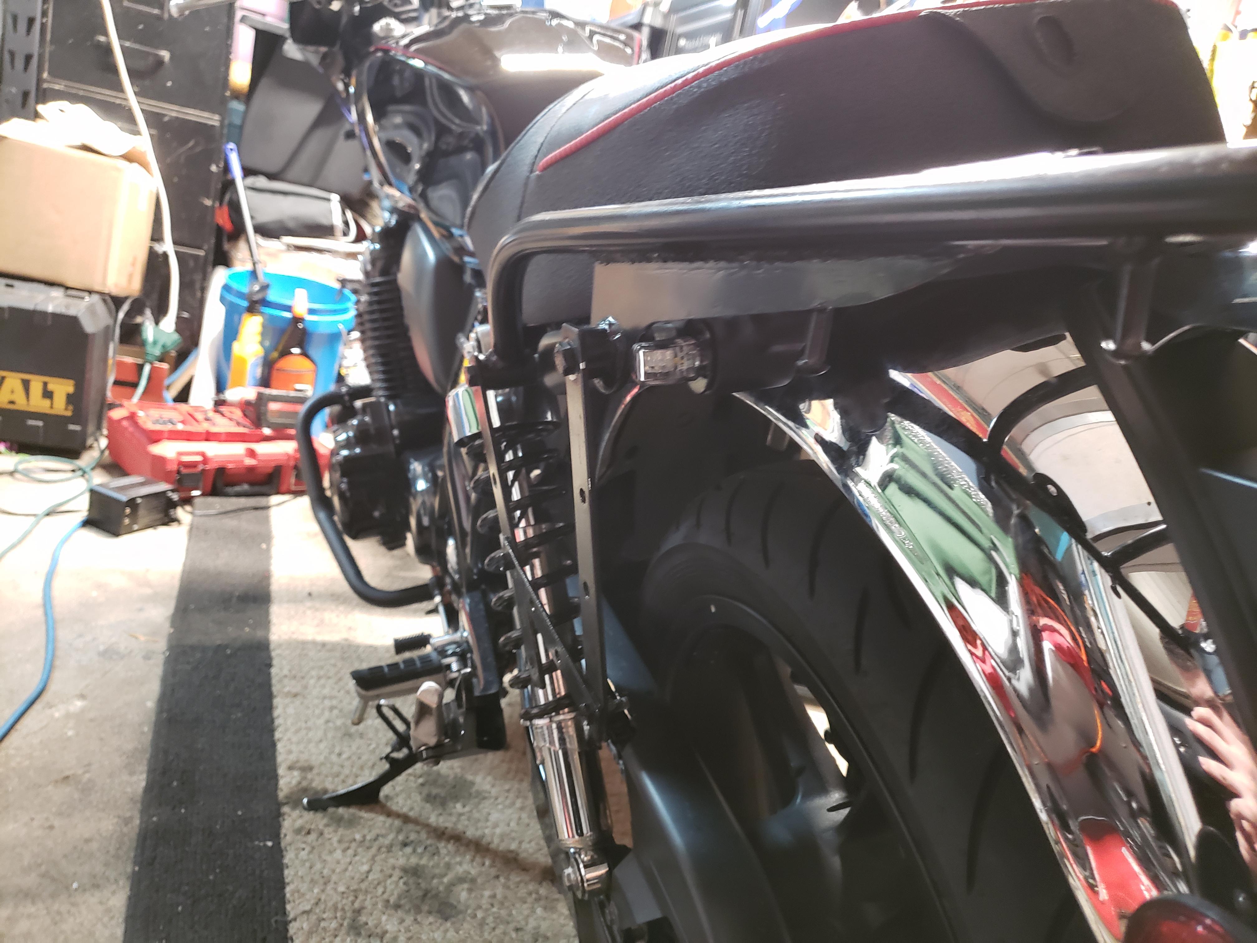

I just got micro leds from ebay and used fender washers to have them mount up nicely over the holes in the original mounting locations.

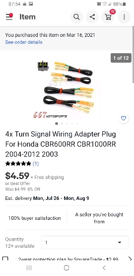

You will need the plug adapters for the rear signals. [url=https://www.ebay.com/itm/4x-Turn-Signal-Wiring-Adapter-Plug-For-Honda-CBR600RR-CBR1000RR-2004-2012-2003-/332466552871?mkcid=16&mkevt=1&_trksid=p2349624.m46890.l49286&mkrid=711-127632-2357-0]https://www.ebay.com/itm/4x-Turn-Signal-Wiring-Adapter-Plug-For-Honda-CBR600RR-CBR1000RR-2004-2012-2003-/332466552871?mkcid=16&mkevt=1&_trksid=p2349624.m46890.l49286&mkrid=711-127632-2357-0

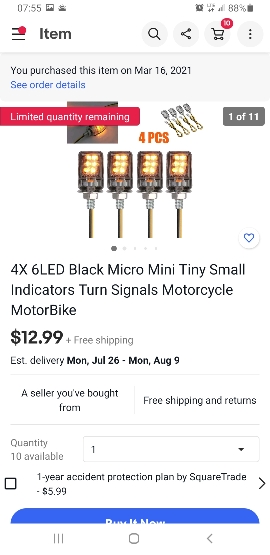

These are the signals I got. I SCOURED the internet looking for M6 sized bolts on the turn signals so I didnt have to drill out the stock mounting holes in the front. These were the ONLY ones I could find that come in the stock size. They are very bright. The hyperflash does not bother me one bit. Theyre small enough that they do not come out wider than the rear rack so I can use them with bags.
https://www.ebay.com/itm/4X-6LED-Black-Micro-Mini-Tiny-Small-Indicators-Turn-Signals-Motorcycle-MotorBike-/392934215964?mkcid=16&mkevt=1&_trksid=p2349624.m46890.l49286&mkrid=711-127632-2357-0[Image: 5732de24b78ee0b8bfad86718f1424a0.jpg][Image: f4f4f514a87c4675f6c20d93d9dcdfd7.jpg][Image: 8cb6b6855977d156edcfa22d40e6fa2d.jpg][Image: b1798bf98fd09ece946bc79bcbd5faf3.jpg][Image: 222ed8a20ffe5b62cc80ec1be3a00a16.jpg][Image: eb32bc4aefbbd6d116846a44a2e564e2.jpg][Image: 587d445158f7db7b8c95943205441afd.jpg][Image: 5bc7ed97cea13ee404ee7ace52b8ec5b.jpg]
