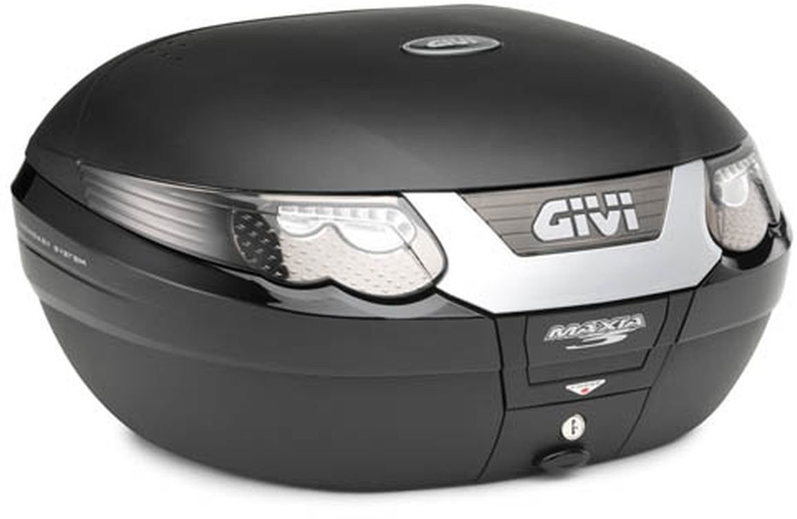

I have the same "issue" as you, dunno if its a real issue or more a point of critique, but I made a topic about this as well, didnt notice you started one before.
http://cb1100forum.com/forum/showthread.php?tid=7935
Whats the nature of your unstability you are refering too? Mine is a slight wobble of the handlebar...
Everything is still stock, except for a Road Comet windscreen with a high Aero touring shield.

hmmmm, most important, I did forget to mention that I did ride with a huge topcase, 55 litre Givi E55 Maxia 3 Blush
[Image: 1a9eff286a595c28c4d125a35b7fe2fc.jpg]
I assume this could cause the front to wobble at high speed?

I have a slight wobble of the handlebar and sometimes even a "rolling" along the axis og the bike. However:
- including luggage and
- Metzeler Z8 tyres
it becomes better. Unfortunately, I have no final solution for the problem.
Best regards
