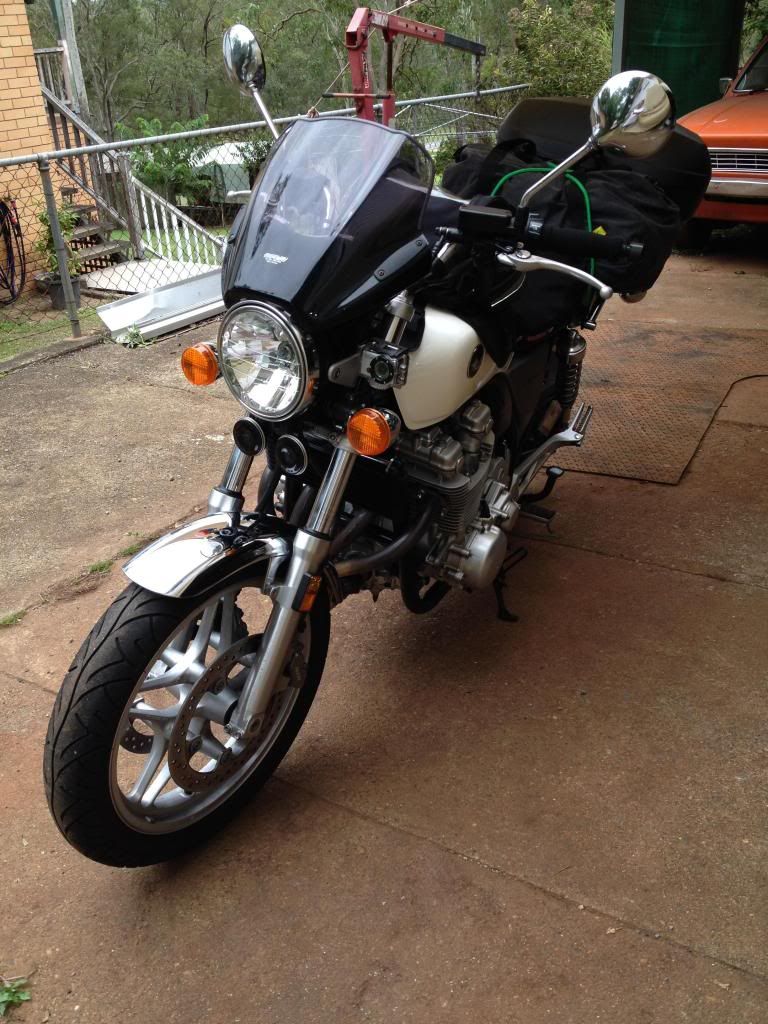

I have an MRA screen from Germany on mine. Doesn't quite cover my helmet but cuts down on the buffeting.

Tezza, can you measure from the ignition to the top of that screen please.
RE: Windshield Recommendations - Tezza_imp - 03-19-2015
Measures about 10 inches. You could probably get a couple of more inches out of it if it was raised away from the headlight and tilted a bit more forward.
RE: Windshield Recommendations - the Ferret - 03-19-2015
Actually we have found people are happiest with their shield if the top is between 8 1/2 and 10" I believe. We did a kind of informal survey about a year or so ago and I think that was the outcome I will try and find it.
Looked through the old windshield threads and it was indeed 8 1/2 to 10" above ignition for buffet free riding. Above that a lot of flag flapping noise.
